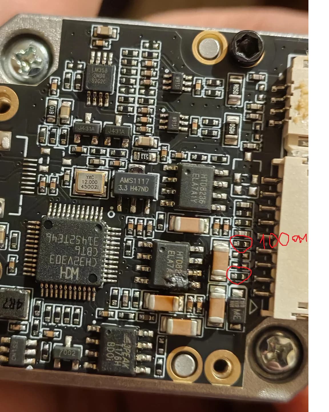

Problem with the X axis. It works unstably. Sometimes the print head starts moving to the left edge and rests. An error occurs. This happens in 95% of cases, sometimes the printer printed normally. The seller sent a new driver for the X axis. But it does not work, the head does not even move. Perhaps the new driver needs to be registered in the printer? With the old driver, the head moves but unstably.
The problem is solved! Two small resistors on the X-axis driver board have failed. 100ohm
