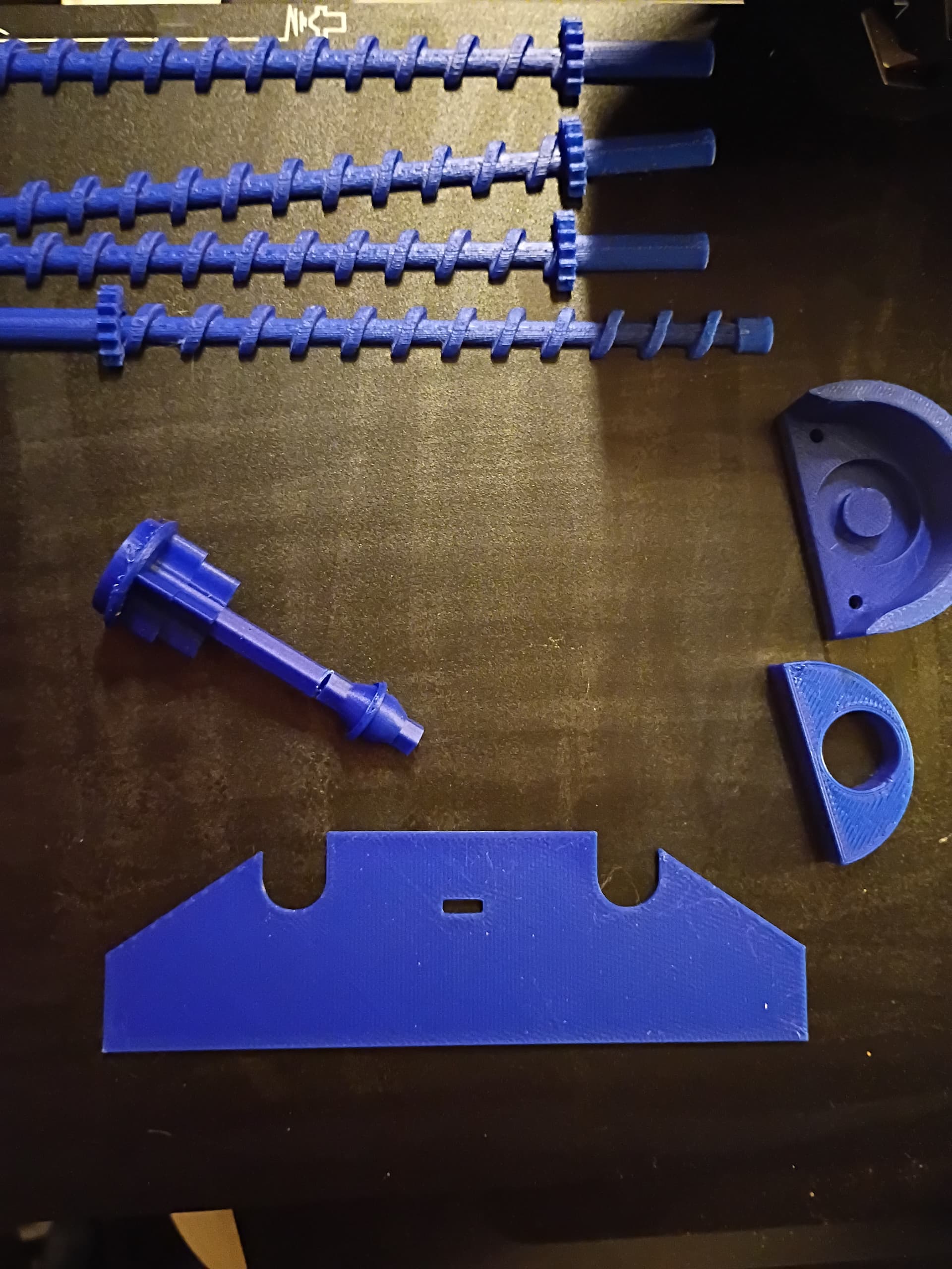

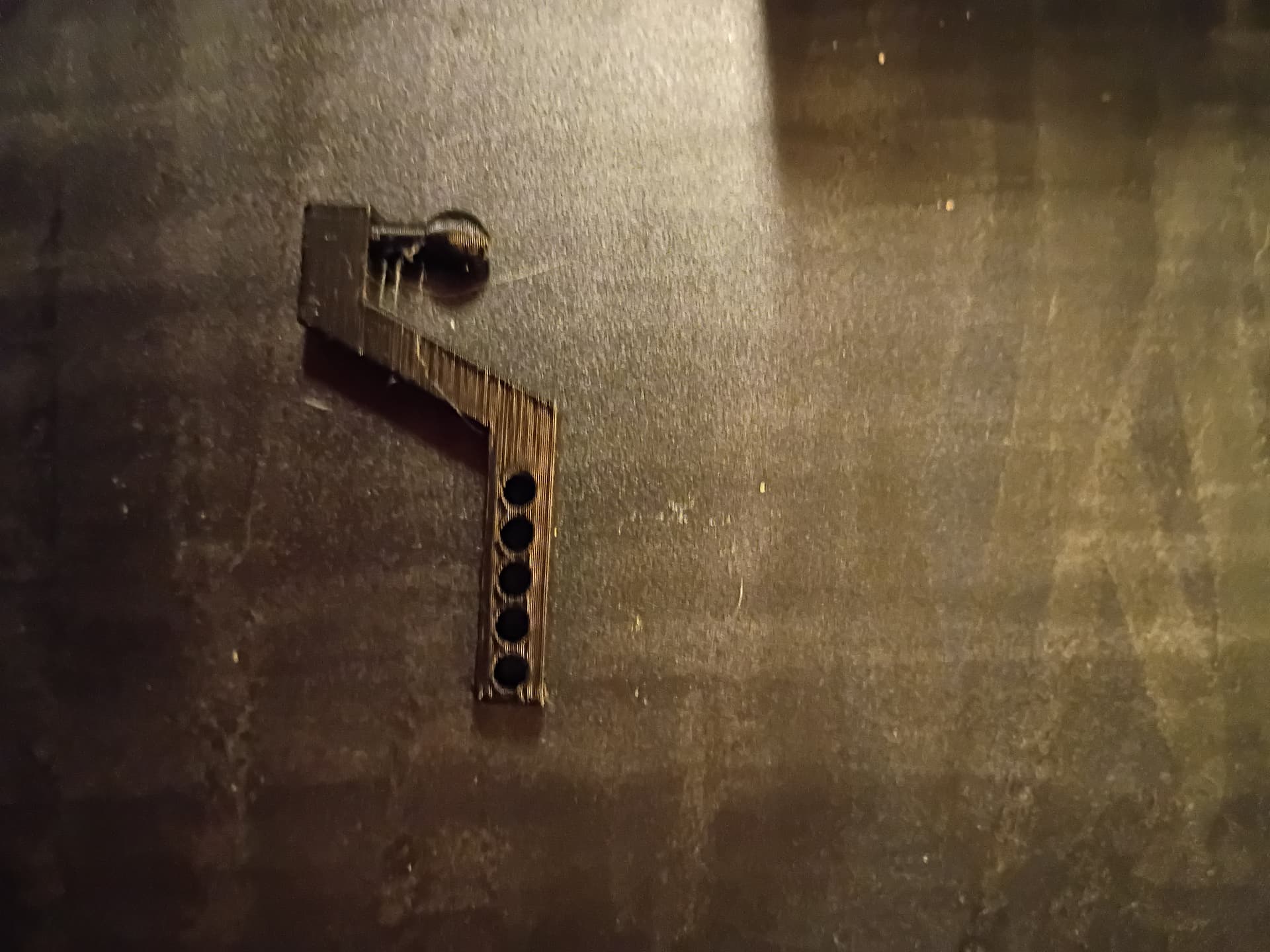

Latest on this, I was able to print a few things, then, it went right back to the way it was acting. I thought maybe it was an issue with the black I have, since white, blue and yellow seemed to print fine, but then, the blue wouldn’t print the second time I tried it, so I just don’t get it. It prints fine one time, and nothing the next. It’s beyond inconsistent. As for it being wet or damp, the filament is only about 2 weeks old, and, when I’m not trying to print, it’s locked in sealed bags with dessicant to keep it dry, and, no, I haven’t heard any popping or sizzling sounds. Actually, I barely hear anything at all from the printer, except the fans off and on. Today though, I ran a more than 2 hour print job with not a single issue, after a 35 minute one. I printed the trailer hitch part first, which took roughly 8 minutes, then, the white and then the blue gears, each of which took more than 35 minutes, and, then the rest, which took over 2 hours, then, it went right back to screwing up, and I haven’t been able to print anything since around 6:30 or so.
I just don’t get what the issue could be. It doesn’t get moved or bumped (I’m very careful around it because I’m on oxygen), I made sure it wasn’t cold or drafty in here (actually, with it running, I was sweating, and it’s winter here, and I’m in an old drafty house). I have even tried the glue stick, and so far still no luck.
I have done the paper method multiple times, same results, I have tried multiple suggestions from multiple sources, and, nothing I do seems to make it so I can consistently print with it. I have tried everything from letting it auto level before every print, to letting it calibrate before every print, to the paper method before every print, and it just won’t stay consistent.

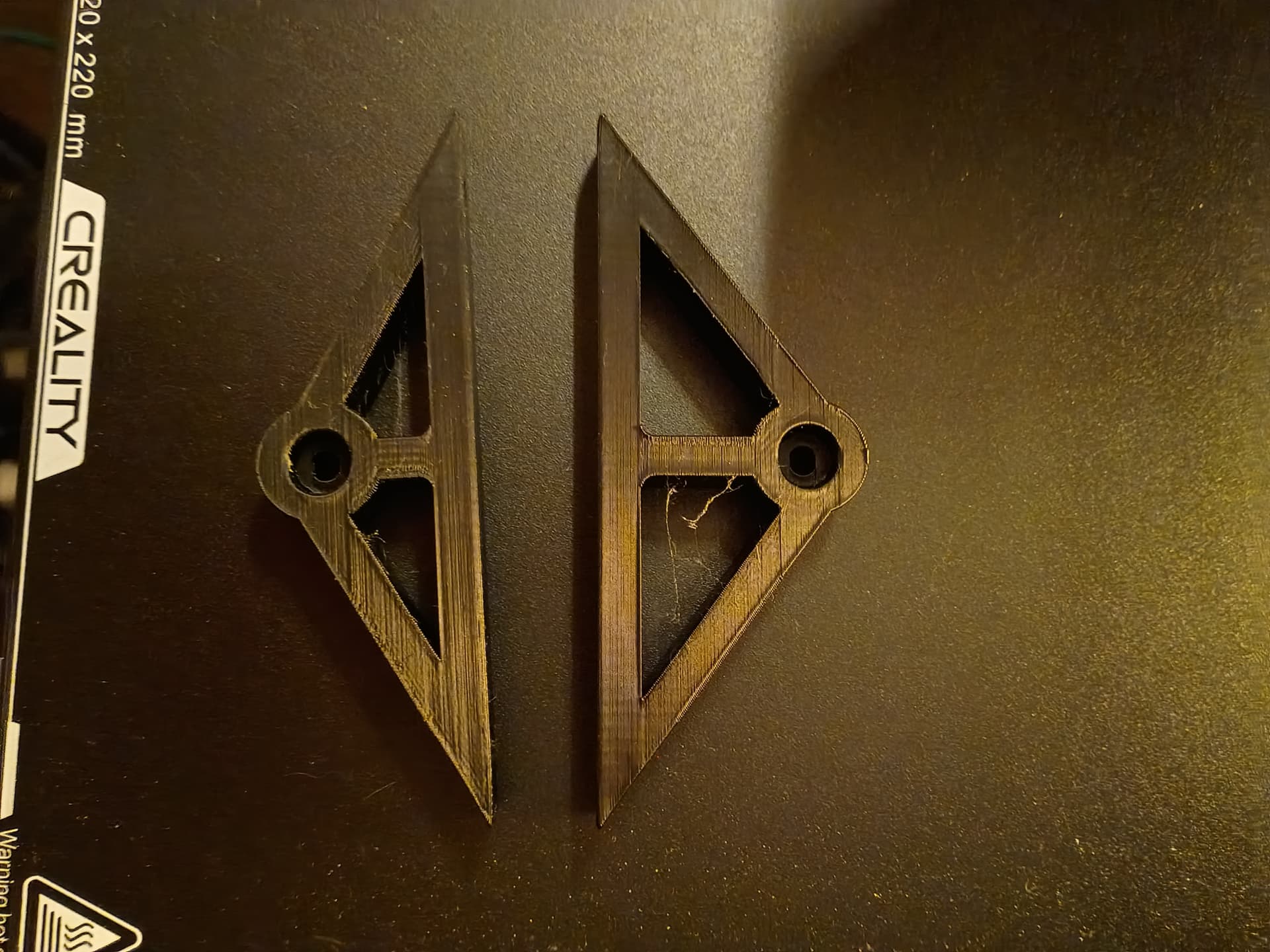

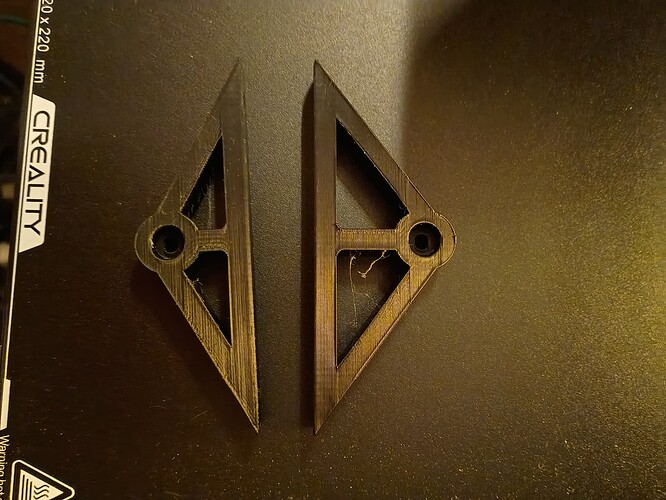

I think I finally solved this whole thing. Part of the issue is simply what I’m trying to print, another part is not really understanding certain things. Take the case currently of part of what started this post, which was, trying to print something only to have it fail multiple times. Well, thanks to a teenager, I am finally able to print the items I have been fighting with, and at the same time, frankly feeling kind of dumb. The part I’m trying to print is the suspension mount for a toy trailer, and, it would either not start at all (my fault for being leary of going too high on the temps), to it starting and then coming off the bed in the beginning of the print. Well, after he made one simple change to it in Creality Print, I have successfully printed both of the pieces I needed. When you first load the file in the slicer, it orients it so that the smaller round end is where it starts printing. He flipped (or mirrored it) so it starts with the larger end, and, victory. The second one just finished (except, I made a small mistake. There are actually 3 sizes of that part, depending on what wheels you are using, and, the second print, I selected the wrong one, so now I get to print a third one lol). The pic shows the part I mean. He also told me to set the nozzle at 210, and the bed at 65, and, in the last two days, I have pretty much finished nearly everything that was on my list to print. All I have left currently is the trailer body, which, according to the file, is going to take more than 5 hours, so I will do that tomorrow.
Good job. I’ve changed my first layer temps to 215 and 62 for PLA. Once I figured that out my fist layer not sticking sometimes went away. All other layers are at 200 and 60. Sometimes I have to lower my nozzle temp down to 197-198 if I see excessive stringing. Of course I’ve found with this hobby that you’ll still have spectacular failures from time to time. I just like the failures at the beginning of the print instead of the last few layers.
