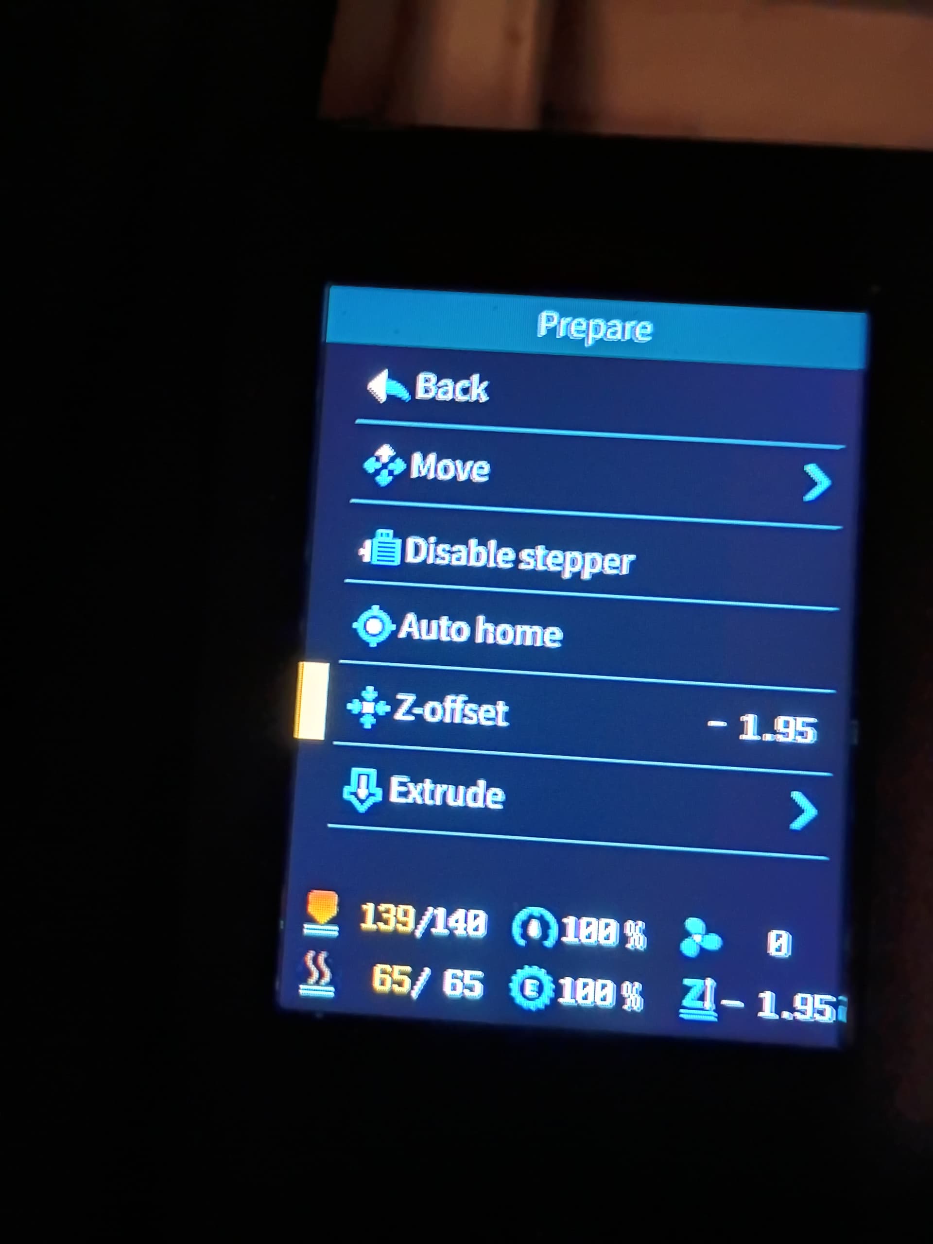

I finally got comfortable enough with the auto leveling, and using the paper trick to set the Z-Axis, but, when I did a test print, it looked off to me, so what did I do wrong?
I redid the auto leveling, and this is what it came out to.
The Z-Axis is showing -1.95.

Actually, I figured that part out. The table I am using is a plastic folding one (only thing I have currently), and, unless the printer is dead center on the table, it’s off level. I finally got it to print the Benchy test print, mostly. It got to roughly 90%, and it came loose from the bed, because the table was moving too much, so, after securing the table to the wall, I ran the auto leveling again, double checked the nozzle height with the paper, and then ran into another issue. Now, trying to do a second print, it tries to print before the nozzle and bed are even heated up, so the filament just comes out in a blob, so, now I’m working on figuring that out. I also noticed that the bed temp was only 50, instead of 60 (I’m using PLA), but, even changing the bed temp to 60, the nozzle was at 176, and the bed at 48 when it started trying to print, and the filament just came out in a small blob.
That’s just wrong. :thinking: I wish I had a helpful suggestion for that other than try to reset to factory…?? and see how that goes…

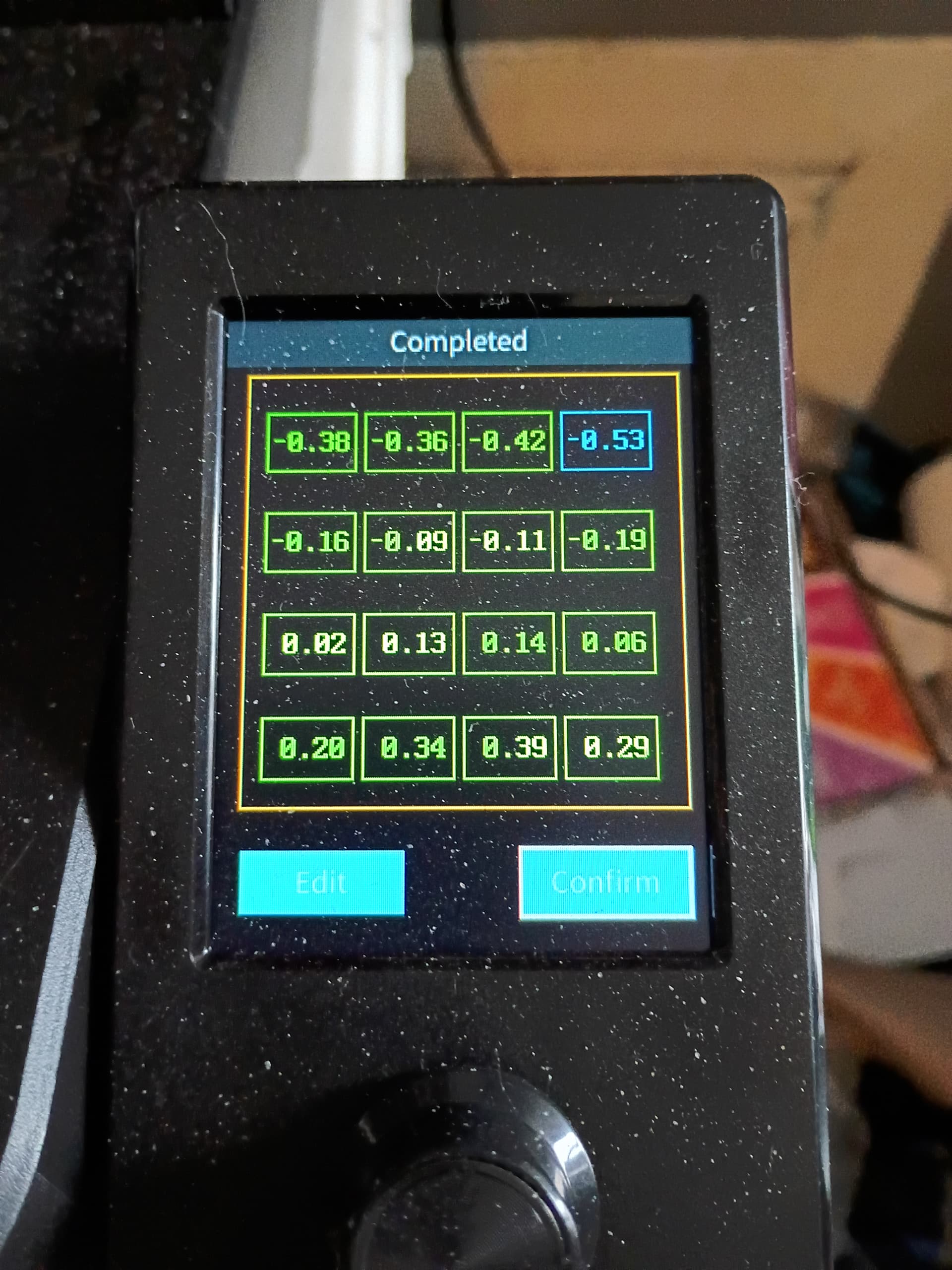

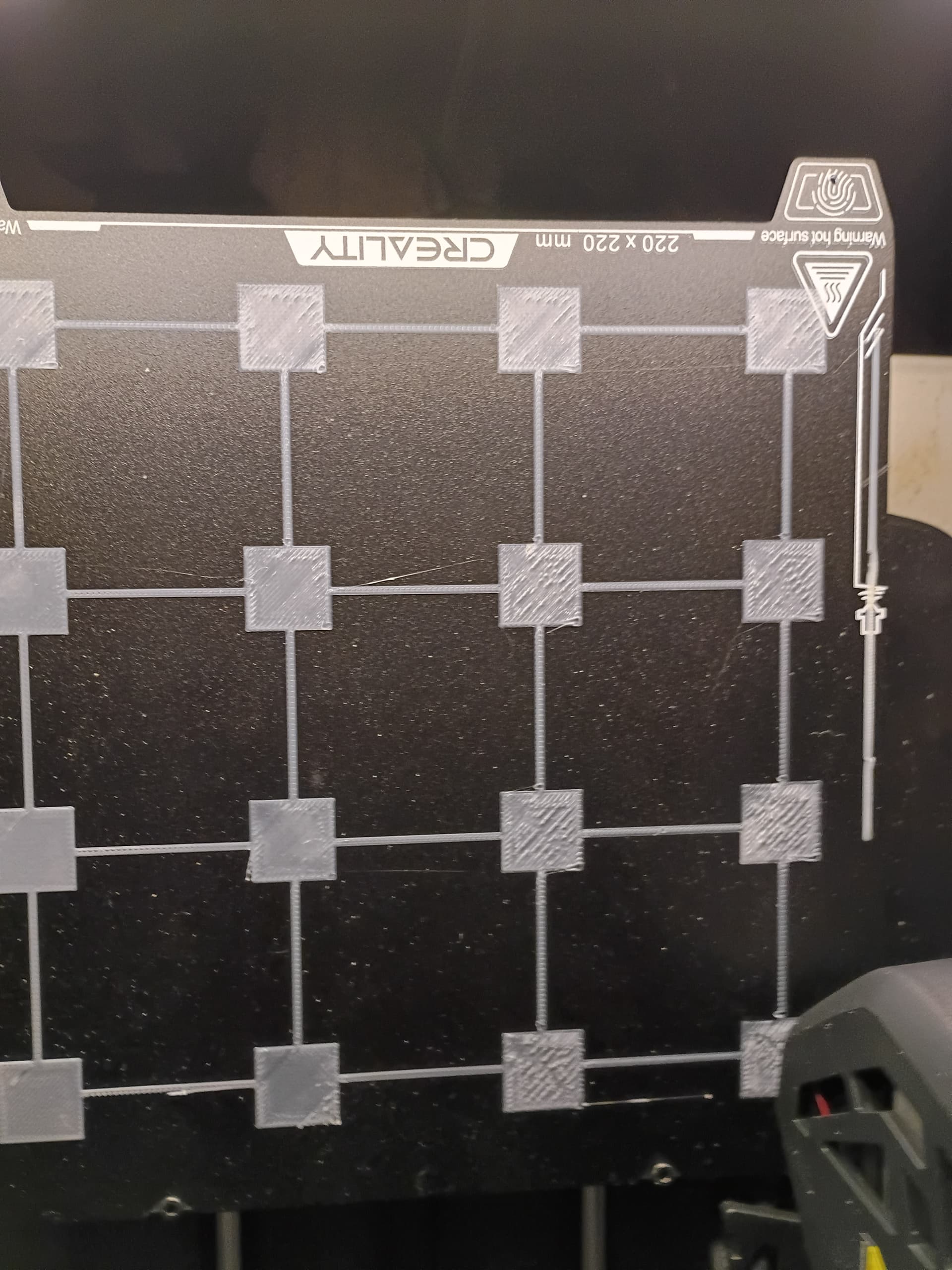

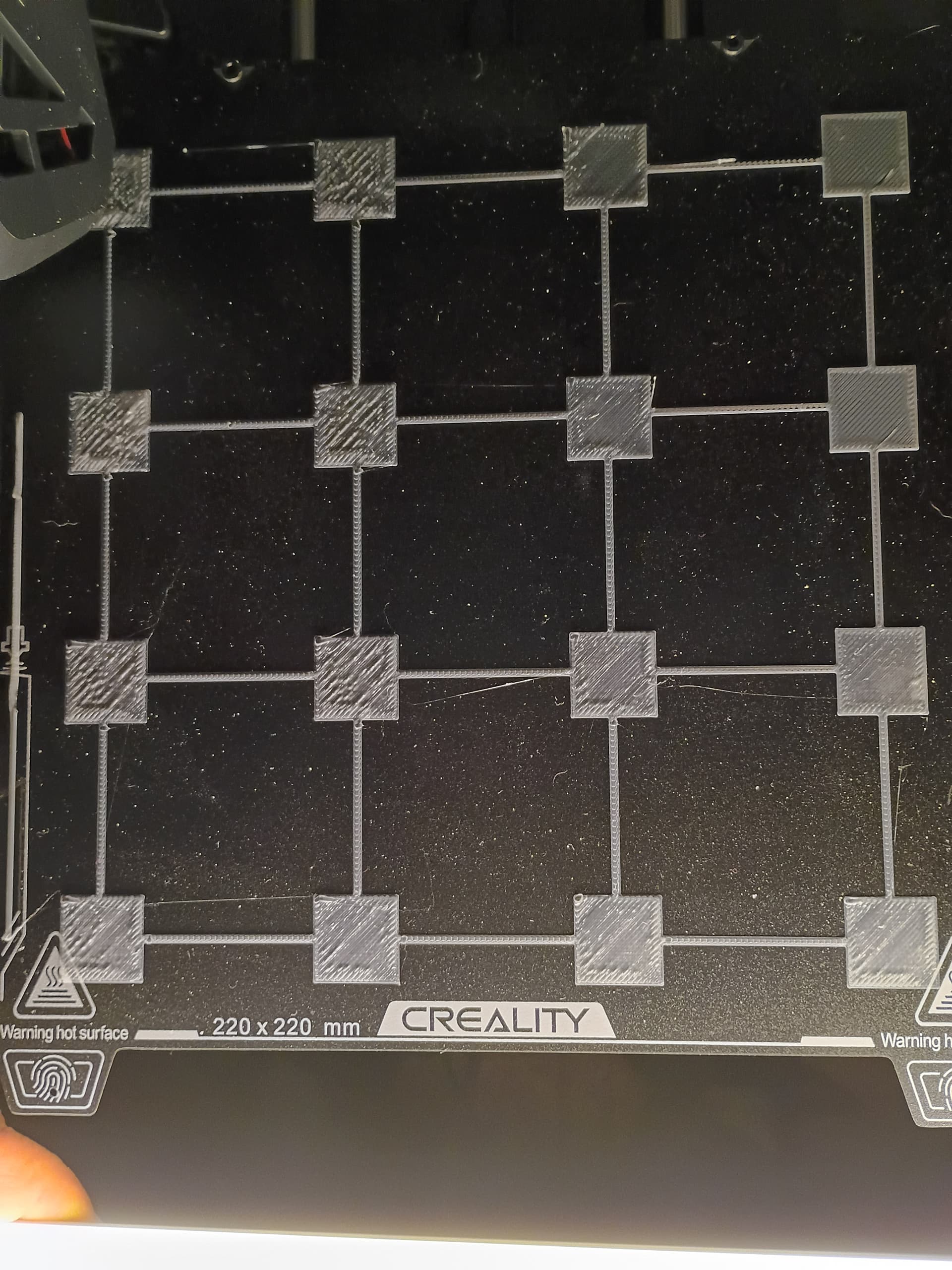

I’ve been using glue and it works good on my Ender V3 KE. I’ve also upgraded the bed bearing to linear bearing then redid my z-offsets. It was still a little tilted towards to back right corner so I printed some shims of different thickness starting at .2mm up to 1mm. Determined what shim I needed in the corners to get my bed perfectly level. Did a single layer 4 square test print (PLA) with each small square in each corner and one in the middle and they all came out perfect. I never use auto-z-off (if your printer has that feature) and just use the same z-off every time using the value I came up with in all my testing.

Tech tip - do all your testing and setup with the bed at temp, 60 in my case and let it heat soak before doing auto-level for 5 minutes or so. That way everything has expanded due to the heat. I also heat my nozzle to 200 and let it heat soak as well. This will give you more accurate readings having the bed/nozzle at printing temps when checking level.

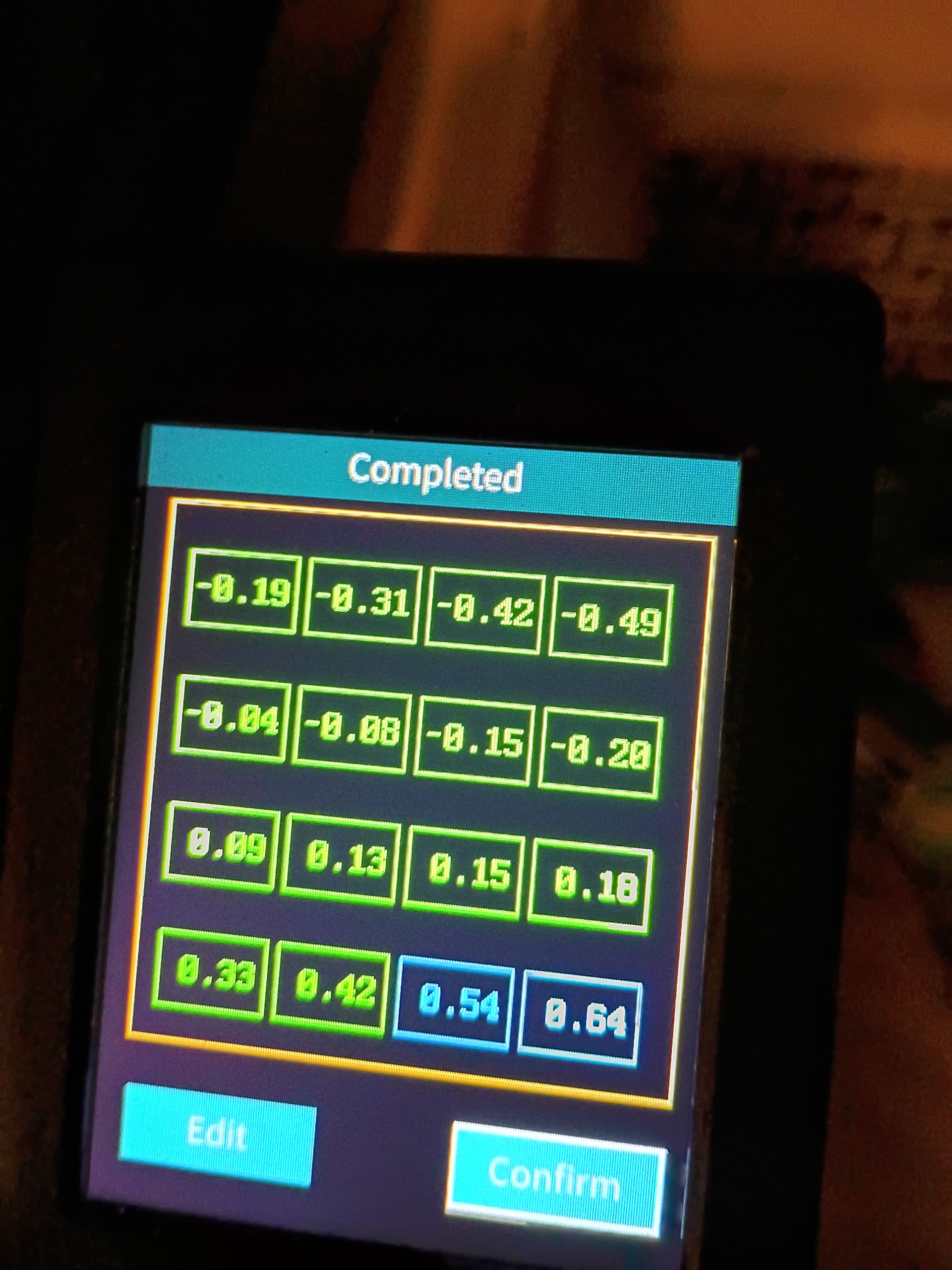

I think the nozzle is too close to the bed. It starts to print, but then the nozzle seems to pull up the first layer. Honestly, the paper method still confuses me a bit. I’m not sure if I’m setting it too low or not. Every time I use the paper method though, the Z value changes, from -1.95 to as much as -2.17, and, is never consistent, so, I’m pretty sure I’m doing something wrong. On mine, every time I auto level it, the rear half of the bed is in the negative and the front half is in the positive, every time. I thought about printing spacers for the rear, but, couldn’t seem to find any small enough. I think I need, at most, a 0.2 or 0.3. This was my last auto level settings. Another thing I noticed, the white that came with the printer prints fine. My issue is with the black, blue and yellow PLA I bought for it.
My other question is, I think, a simple one. The negative numbers mean the nozzle is closer to the bed, correct? If so, wouldn’t that mean put the spacers under the screws in the front of the bed?
You are right. The negative means closer to the bed.
Not being familiar with your machine I’ve read where you could put some kind of tape under the build plate where it’s lower and run the calibration to see what changed…

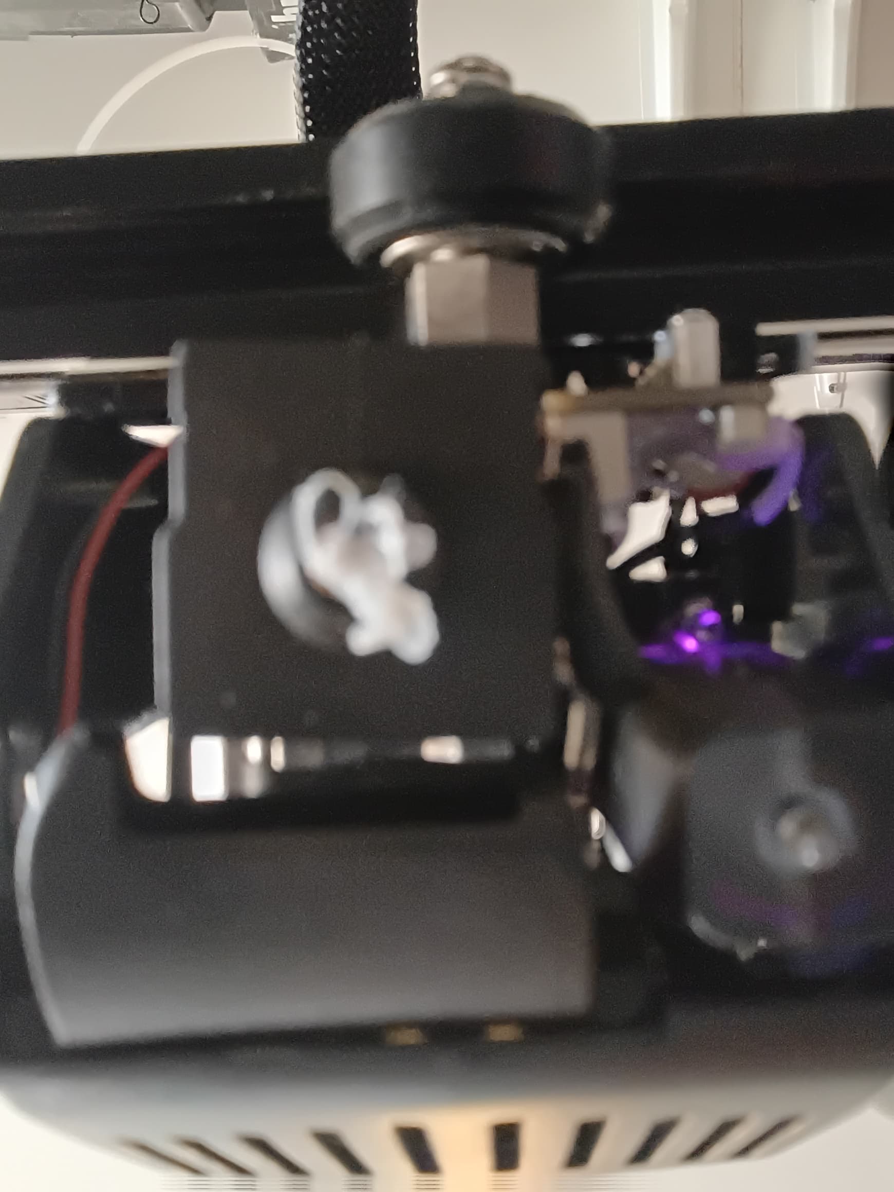

With the bed between 58 and 61 degrees, and the nozzle at 205, verified by an IR temp reader, this is what happens every time I try to print anything. I have washed the magnetic plate with Dawn and hot water, dried it, then used IPA, let the machine self level, again, and this is what I get every time. I remove the filament after every attempt, heat up the nozzle, and remove any leftover filament, and even let it auto extrude, and it’s still the same. I’m starting to get beyond frustrated with it. It’s not clogging the nozzle. It starts to print, then peels the filament off the bed and wraps it around the nozzle.

The last two hours, I have just been wasting filament trying different settings for a simple print, from Z-AXIS (I went from -1.92 to -2.16), adjusting temp for both the nozzle and bed as it goes, to anything else I have read about, and, 14 attempts, all with the same results. Currently, it’s been sitting 15 minutes with the nozzle at 215, and the bed at 60, and the Z-Axis at -2.04, and, didn’t do 10 seconds before it pulled it off the bed. I can’t use hairspray, due to medical issues (on oxygen due to lung cancer), and, frankly, I don’t see what glue and tape would really do, except melt.
