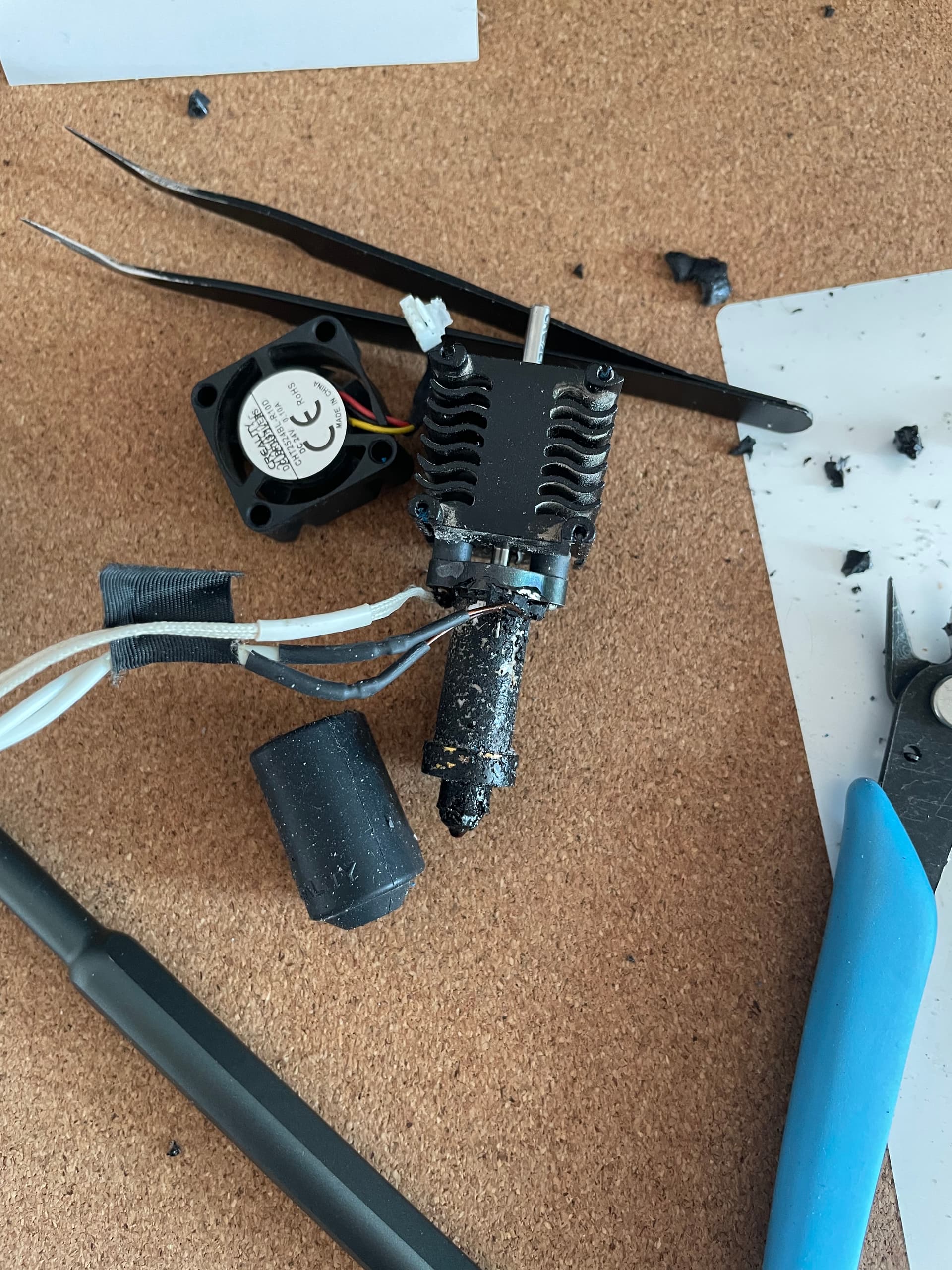

Eventually I decided to open the extruder and clean the nozzle. During cleaning I discovered that a previous filament blob incident had heavily contaminated the nozzle.

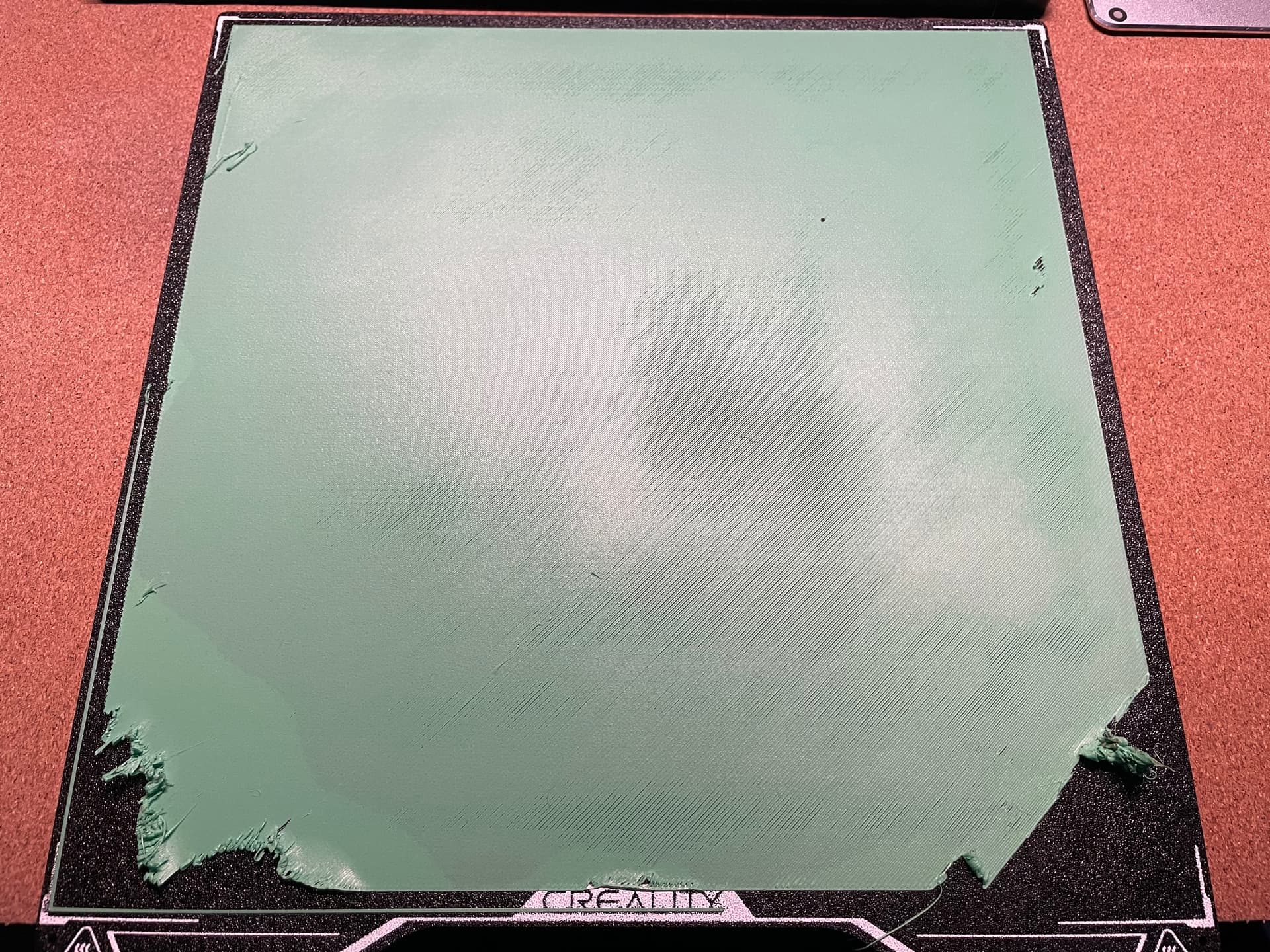

  • Prints get knocked off the bed during printing
  • The first layer height is inconsistent
  • Running calibration makes it worse each time

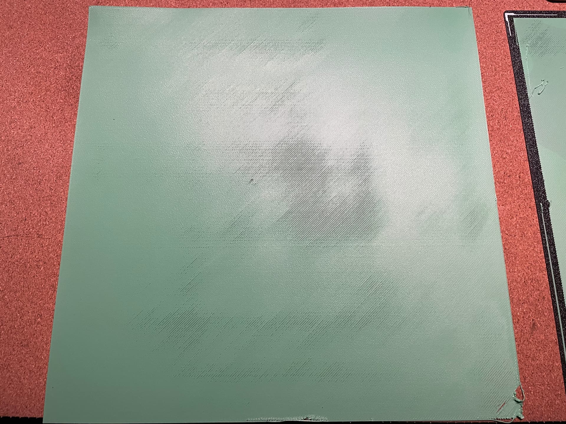

I ran a first layer test after calibration, and it seems like the Z-axis compensation is no longer working correctly.

Current symptoms:
  • Nozzle seems to be too low in some areas
  • Calibration results become worse after each run
  • Prints often get hit by the nozzle and fly off
