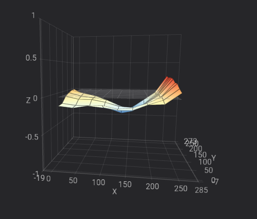

I look on my “flat plane” in fluidd (4408), and it looks like almost all points below the surface (I don’t have a perfectly flat table), but before update I had only a small hole.
For the experiment, I’ll raise the z-offset, and maybe play with the foil. But, in reality, a new good firmware is needed. Today I rolled back to “Factory settings” - did not help. Downgraded to the 44th firmware - did not help.
Maybe reason in “5. Update step-servo motor system firmware and parameters.“ (from description of 50th firmware). Because sounds of motors had changed after update. And interesting, that they don’t returned back after downgrade of firmware.

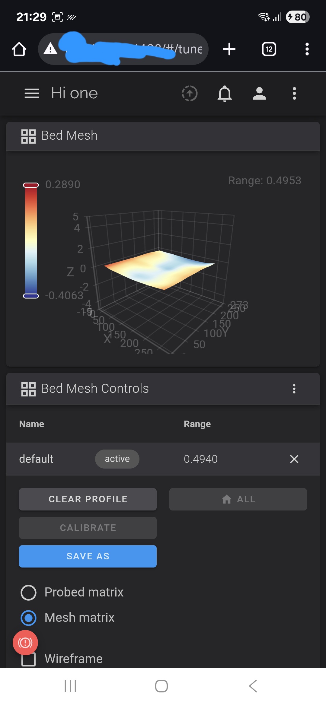

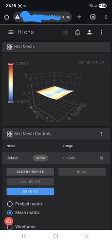

I have two Hi printers, and I updated both of them to the newest version. Everything is working perfectly.

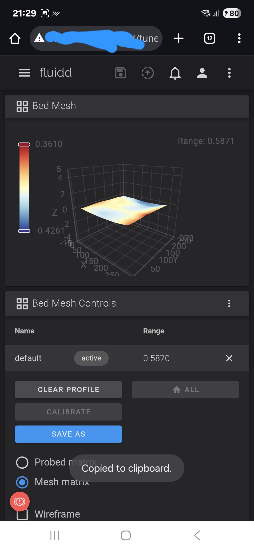

For my first printer, the bed mesh range is 0.4940 with a Z-offset of 0.10.
For my second printer, the bed mesh range is 0.5870 with a Z-offset of 0.10.
After updating, I ran a new auto bed leveling
Previously, almost the entire surface was higher than the base surface (except for the hole at the back), and now almost everything is lower. Maybe something happened with the definition of the Z limit switches, or with the definition of the z-height. That is, it used to work perfectly without z-offset, but now it scrapes.

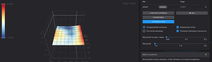

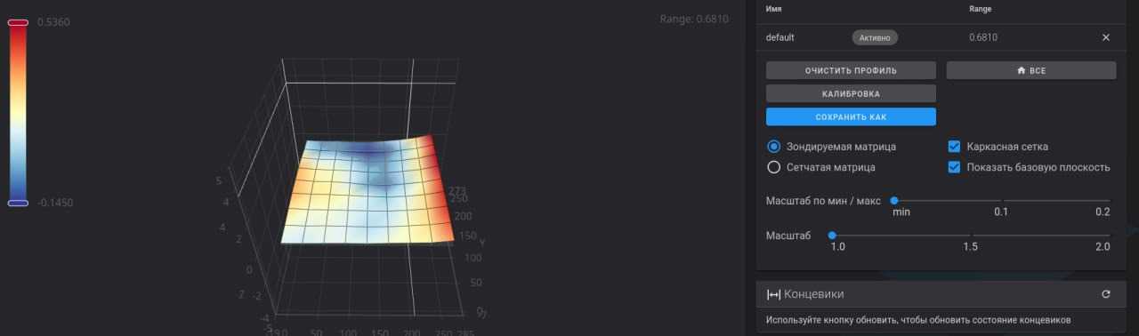

New one on 1.0.0.44 (now no only on 1.0.0.50):
Old one on 1.0.0.48 (unfortunately only this screenshot):
Grate! I downgraded to 1.0.0.38 (first firmware, January). And it looks like before (base level on current place):
Now a question for me. Should I update 38->44->45->47->48 (remember, I had no problems with 48), or straight to 38->48… Or try my luck again and get to 50…
As a result of all my experiments, I came to the conclusion that only on the 1.0.0.38 version does it autocalibrate normally, reset to factory settings normally, etc.
