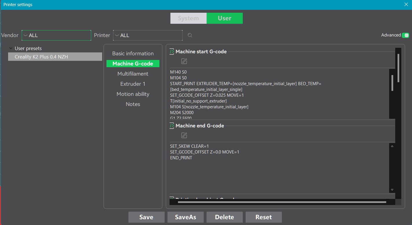

You can set the the (machine) Z-Offset also in your printer profile for example this way:
I would not use the slicer z-Offset at all.
Anyhow, I created my own print profile not for Z-Offset (I need it only for the flat print plate with carbon fiber optic from 3rd party vendor), I use it to remove Z-Hop and to set X-Y-Skew.
Did you adjust your bed and do you check with bed mesh? After adjusting bed like described here I did not have any need for a Z-offset because my bed mesh has only 0.350 mm unevenness which is handled easily by bed mesh.
Please move the SET_GC… like one line down as shown in the following picture:
The reason is that at least new CPV6.0.3.x clears the Z-Offset in the START_PRINT macro and therefore it need to be put afterwards.
