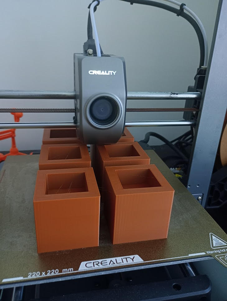

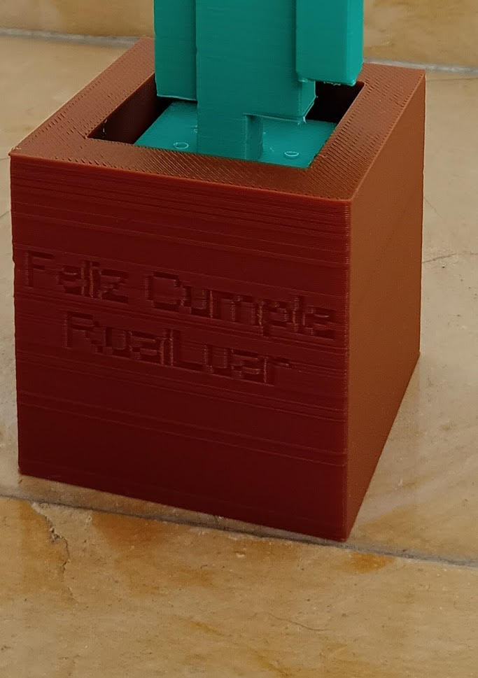

Hi there! I just bought a Ender 3 V3 CoreXZ 6 months ago… everything was fine and had no problems with any print until now. Now all the prints have this horrible layer lines that are visible on the X-axis. I have tried the following according to Creality Support and some forums:
  • Calibrating Nozzle’s PID
  • “Service Tutorial Ender 3 V3 Adjust XZ, Y belt” Video
  • "Service Tutorial Ender 3 V3 Layer troubleshooting " Video
  • Dismounting and tightening the frame
  • Cleaning everything and greasing as the manual indicates
  • x-axis horizontal adjustment
  • Adjust xz and y belt
tbh I don’t know what else to do to fix it, I really need the prints to have a good finish for my engineering projects so any help/tips are greatly appreciated!!
Here’s the current quality with the uneven layer lines
Here’s a past print (same model/same settings) but with a smooth finish and no visible uneven layer lines
Hi, it happens only at one axis X?
Hola, puediste solucionarlo?
yes, it does!!
hola, sí pude solucionarlo, desmontando el riel del eje z y apretándolo todo de nuevo, asegurate de asentar los tornillos de manera cruzada para que tengas el mejor apriete.
Sólo que ahora me apareció ghosting, no sé si esté relacionado
