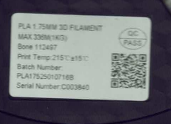

I have a brand of PLA that I simply cannot get to print well with any settings. It seems to print “dry” has adhesion problems with itself and is just a pain to use. I have never had a filament give me so much trouble, and unfortunately I have 5 spools of it.
All my other filaments are wonderful to use, some needing higher temps than others. some work better at lower or higher speeds.

Hi what brand is it. I had similar with some cheap GTECH off eBay I dried it and it was better
I bought it through a Chinese friend that went back to China for a visit. It has no manufacturer label, so I am at a loss to know the brand.
There is a label on the spool that shows to use around 215C
I scanned the label that shows this, that is all the info I have,
I have tried temps between 190 and 230 C and all have been bad.
The filament has been in my drier for several days and made no difference.
The same Chinese guy brought me back some Sunlu filaments and all of them have been excellent.
I am using a Creality Ender V3 SE and it is enclosed so I can print ABS.
