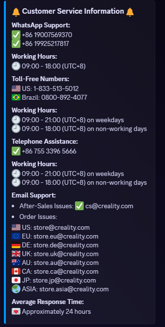

Anyway, I’m waiting on Creality to get back to me with this one, because I can’t use the machine at all, and I’ve tried everything I can come up with on Google, and it’s not working at all. I remember a few years back, I was able to get technical support from Creality over the phone, but now customer service just tells me I have to do it through email, and that it takes 24-48 hours for them to reply after I send them the problem I’m having. I’m not okay with that slow of technical support.
You should still be able to use Whatsapp if needed (they’re pretty fast in UTC+8 working time)

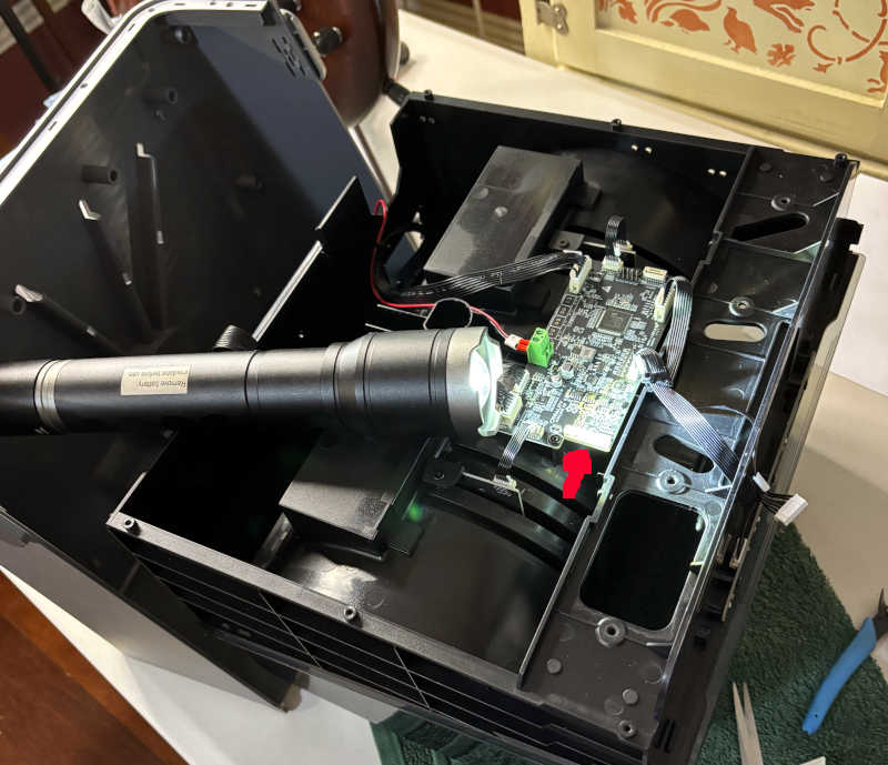

I got BM10011 and TE2564 errors after taking apart the extruder several times and eventually traced it to a shorted harness. that I had pinched between the stepped and extruder back board. Creality sent me a replacement harness but in the interim I used HT silicone and shrink fit to repair the harness, see
This is the second “pinching” harness damage I have experienced with the K2, the other being in the CFS.
It seems like Creailty should be looking at these as a design issue for future upgrades.

Well, after a few days of dealing with Creality, because they take 24 hours to reply to every message, I got it figured out. there is a short at the connection between the Nozzle adapter board, and the drag chain line. At first, I thought things were fine, because the blue light on the board was on. After fiddling around a bit though, I noticed that the light would go off sometimes. I couldn’t tell if it was the connector on the line or the pcb, so they are sending me both. I thought it might be cold solder joints on the pcb, so I tried reflowing the solder on the connector to no avail. I see there are two pins in the connector that are blackened from heat, and I tried using some deoxit on the connection to see if those were the issue. I don’t know that they weren’t the issue, but it didn’t fix it.
When the parts come in, If it’s not the drag chain line, I’ll try to replace that connector and see if that fixes it. It’s not that $30 for a spare pcb is that bad of a price, but I hate throwing things away that can be easily and cheaply repaired. I’ll just put a few connectors in my cart for the next digikey order.
