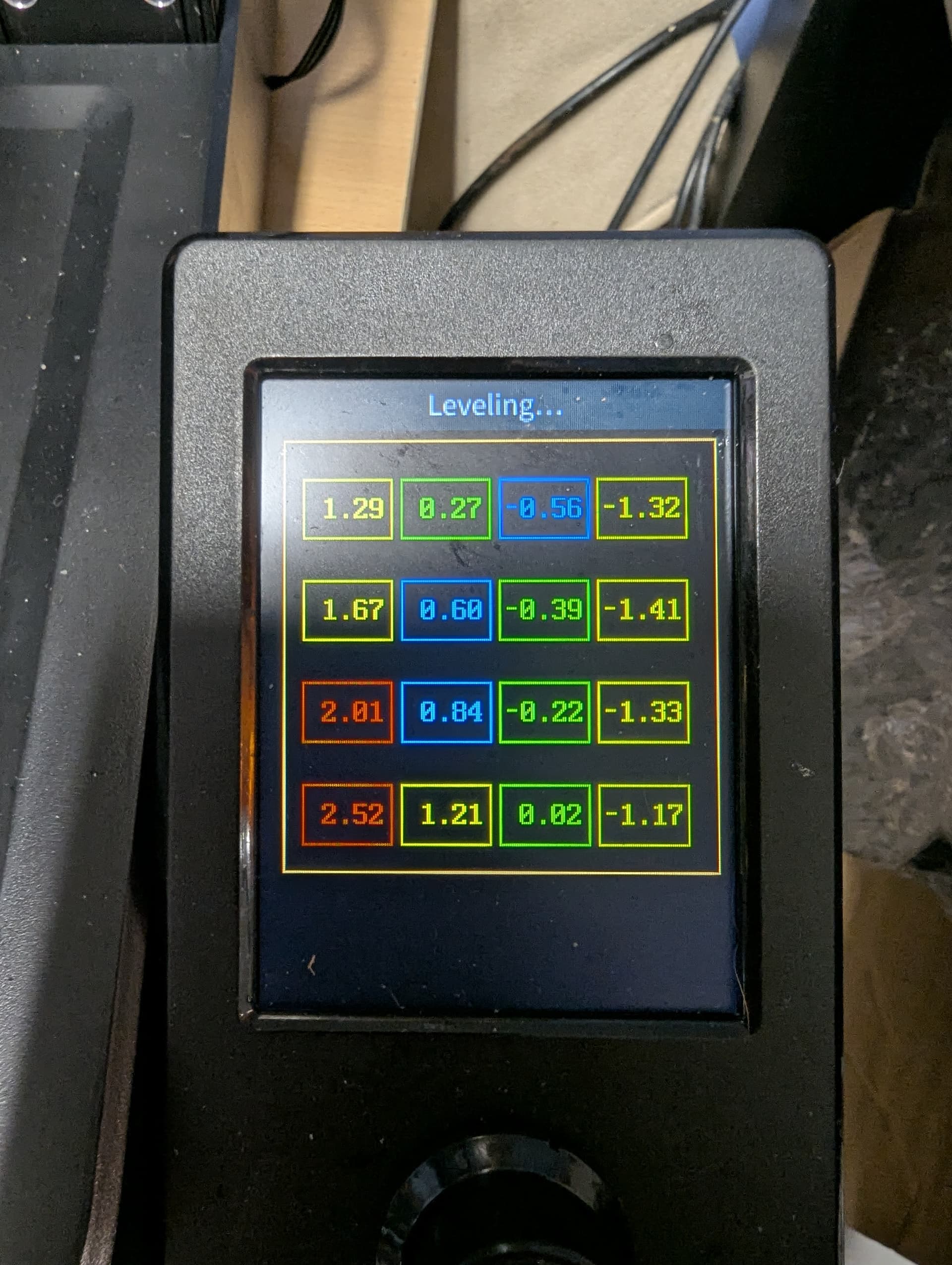

Bed leveling issue
How do I fix my bed I have tryed everything I can find to try but unable to fix my bed level and have no clue how it got out off level.
Hi
First I would remove the print plate and check the 4 bed securing screws,
tighten them down as equally as possible then redo the bed level and see if that helps.
Have you by any chance removed the heated bed? If so then you may have mixed up the spacers.
Let us know how you get on.
Also check that the printhead gantry is parallel to the bed, looking at the numbers it is low on one side.
