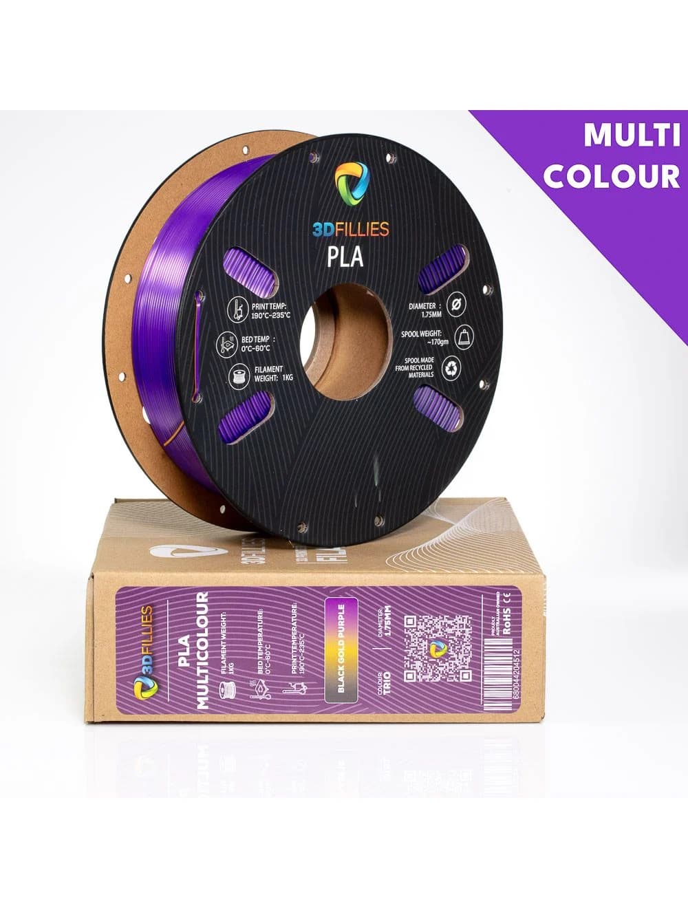

@Radical_Data @Bonfireman Will this work in pla silk? MultiColour PLA Filament 1.75mm 1kg - 3D Printer Filaments
Hello jado163,
Looking at the picture of it, I would say it would… maybe 55deg bed temp and 200 nozzle temp for starters and play from there.
Best to use a temperature tower if it not coming out as it should, to get the best nozzle temperature.
Cheers.
P.S. Again, I have not used that brand.
@Radical_Data thank you so much i will get it and see what it is like
