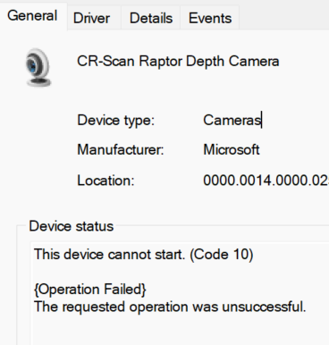

I installed CrealityScan4. Connected the Scanner as advised. Device gives this error. I read in internet there is a problem with windows (I cannot install an older version) or firmware, which has to be updated using CrealtyScan4… which doesnt start because the device doesnt start also.

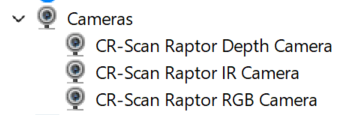

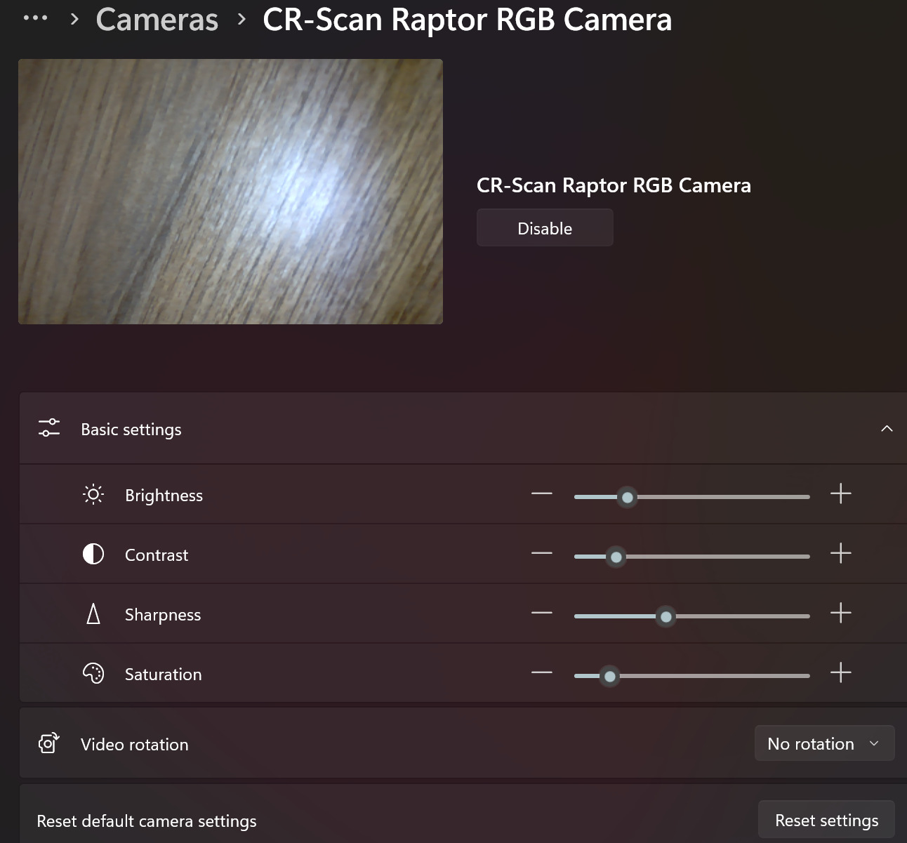

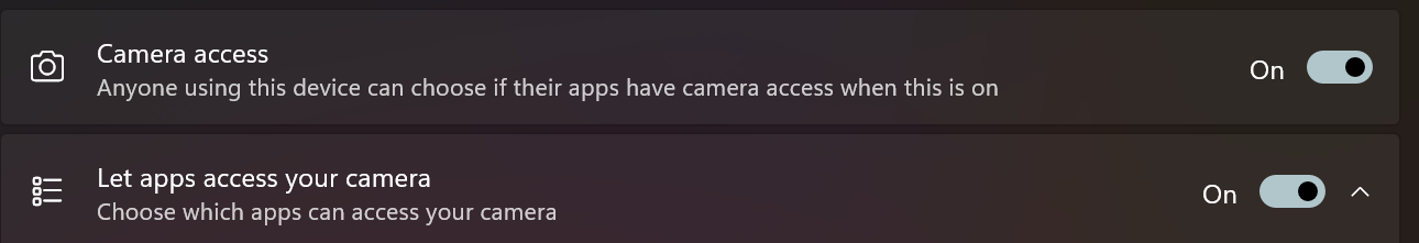

At device manager there are no errors. At security and privacy settings everything is allowed to access the cameras. I even connect to each camera using the setup and they work.
BUT…. scanner isnt recognized by the software, I feel I am near of getting this to work. Installed the last Creality Scan 4 software and firmware. Windows device manager shows me all cameras working ok and I can access them by windows. But the Creality software doesnt detect the scanner. Does anyone knows how can I work this out? I am sure I am not the first one to be in this situation.

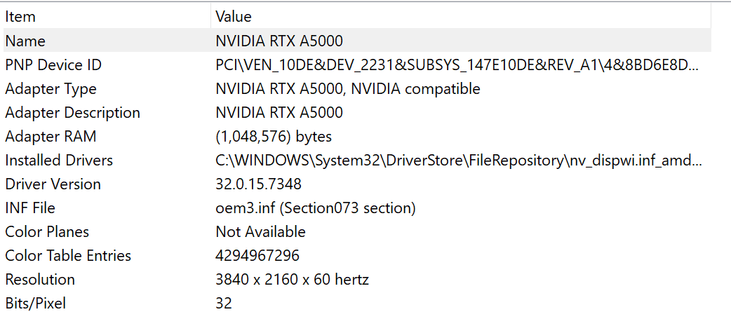

I will add some information about the computer:
USB
GPU:
CPU-RAM
96GB of fast DDR5 RAM… without any issues.
I am really lost with this scanner and its software. Now firmware is ok and no errors in the devices, but software cant recognize the scanner.

When you open Creality Scan 4 a big notification pops up about the firmware upgrade for the Raptor to patch the problem that the Windows update caused. If it still does not work, what does show in the device manager and what happens when you plug it in and have Creality Scan 4 open?
