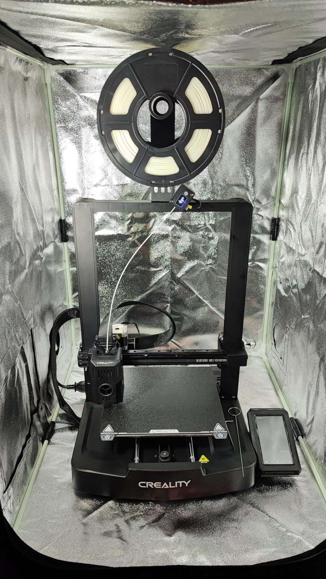

Solutions i found for myself:
  • glue (PC or PC-CF will still unstick itself from the bed, or it will actually warp the bed plate with it)
  • chamber/enclosure
  • heater (600W to reach 50°C, 300W will be good to reach 30~35°C but will take some time to reach that temperature)
    Problems i encountered with the enclosure:
    • high temperature leads to melting of the hot glue that is on some connectors inside the printer, as well in the printing head. The hot glue from the printing head did get liquid and dropped on the print while printing - the actual temperature inside was 45~50°C. Now all of that hot glue is gone, so that is no longer a problem for me.
    • high temperature doesn’t allow the power supply not the nozzle to be cooled very well, therefore i never raised the temperature more than to 50°C, i usually limit it to 45°C.

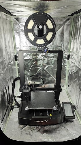

    • need a light source, but any light source added works perfectly, as the inside of the enclosure reflects the light extremely well - as seen on the picture
    • when opening the encolure, some of the heat would escape, so i could not print right after i opened it
    • PC, PC-CF, PA12-CF and few more filaments will require way higher temperature of the encolure than just 50°C , more like 60°C onwards, and the encolure i have and i posted picture of, is not good enough for such temperatures, nor will the printer survive such temperatures (can print small models with mentioned filaments, but nothing bigger than 15 maybe 20mm in size)
    Benefits :
    • no more problems with printing ABS or ASA
    • the enclosure does limit the fumes a little
    • it dries the filament a bit, and keeps it dry while printing
    • no need for glue with ABS or ASA, these filaments stay on the bed, from 40°C onwards they stick to the bed so well, i would have to take out the bed to cool it down, else i can’t remove the printed models, once cold, the bed plate releases the prints almost automatically :slight_smile:
    • very good print quality, the layers stick to each other so very well, that if i try to breake the printed model, it seldom breaks where the layers are, instead it breaks across layers or at the thinnest spot
    Was it a mistake to buy a printer which has no enclosure (also without heating)?
    Yes.
the enclosure costs around 40Eur, and on the first pic it’s actually my own printer inside of it, i added heaters with a thermostat later on.
However, the bed alone can heat up the encolure to about 30°C - but it takes VERY long time to achieve that, and within that time, the bed needs to stay at 100°C the whole time,
