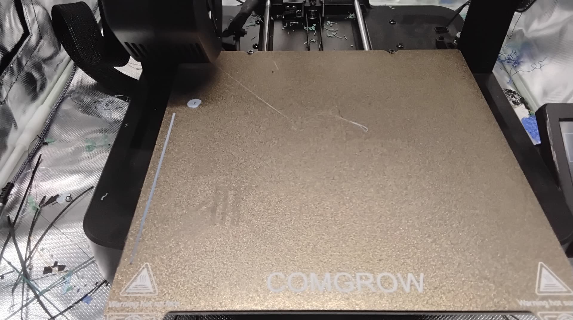

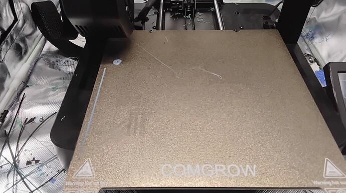

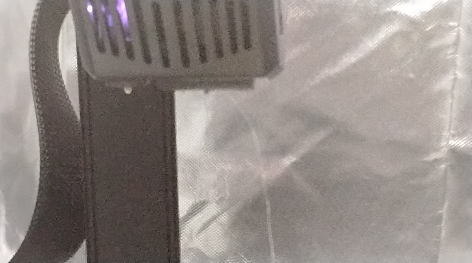

I am not able to print supports or any shape that prints from the inside out. It goes good, then the nozzle rolls the filament into a ball and picks it up.
I am using an Ender 3 v3 SE with Creality Wild Blossom PLA with my nozzle at 190 and board at 60. I installed some hardened steel nozzles, and now none of my other ones work either.
As it turns out, you really need the temperature at 220 or higher.
