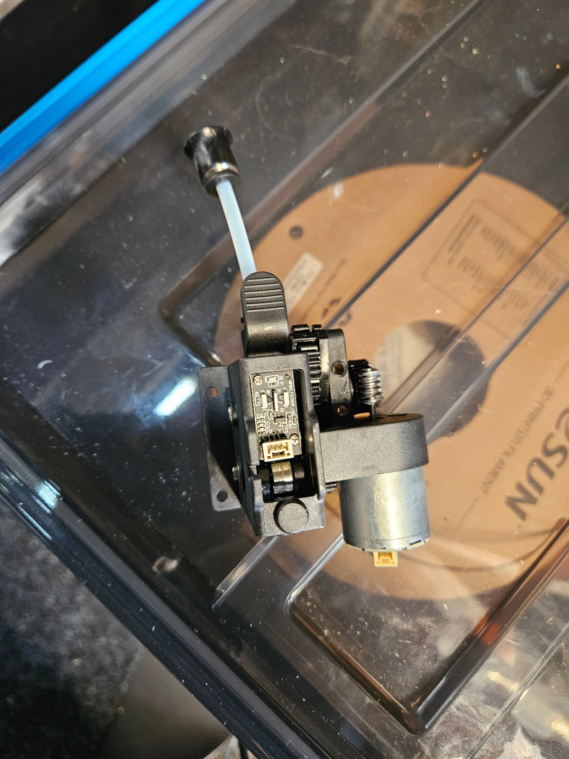

I swapped CFS loader unit 2 (originally not working) with working loader 4
Now Loader #2 doesnt work and loader 4 does ???

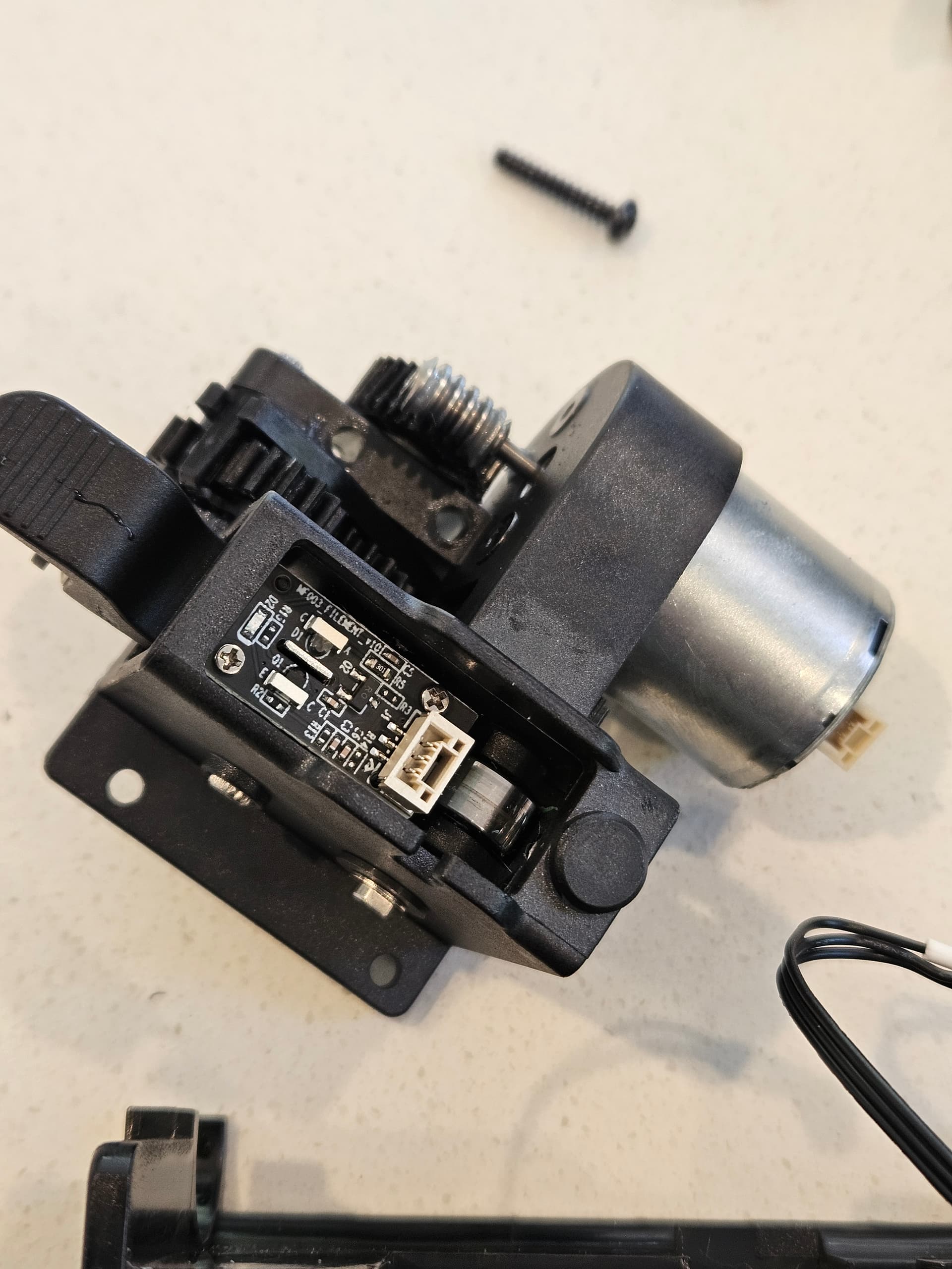

There is a sensor just under the PTFE tube entry to the loader that can be seen without taking the ladder apart. It shows up as a blue LED which can be seen by pushing filament into the loder. If that doesnt come on it wont load. FWIW that is not my problems as I can clearly see the blue sensor light come on. My 4 new loaders arrived within a week of me reporting my problem (each in its own foam padded box) but I have not had time to fit them yet - maybe today.

New loaders installed but problem remains with loaders 2 and 3 (1 and 4 working). I removed the plastic cover covering the loaders so can clearly see the blue LED filament sensor and motor and confirm for loaders 2/3 when filament inserted the Blue LEDs come on but motors do not turn.
I tested the wiring by plugging loader 3 sensor and motor cables at the junction board (in between loader 3 and 4) into loader 4 sockets and then loader 3 (plugged into loader 4 sockets) worked. Suggests motor power not switching at junction board or further back. Have logged all this with Creality.

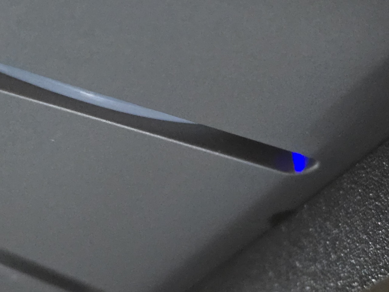

I had a problem with 1 loader, where the filament detector was not working, always showed as filament loaded (blue light from the loader while empty), a replacement loader fixed that particular issue.
Above image was from underneath front of the CFS, when loader was empty

Chris, Yes I have tried swapping around the existing working loader s (1 and 4) with the non working ones originally in positions 3 and they still work.
ie
  • original loader in posn #2 relocated into position #1 works fine
  • original # 1 loader put into position #2 does not work.
  • original loader in posn #3 relocated into position #4 works fine
  • original # 3loader put into position #3 does not work.

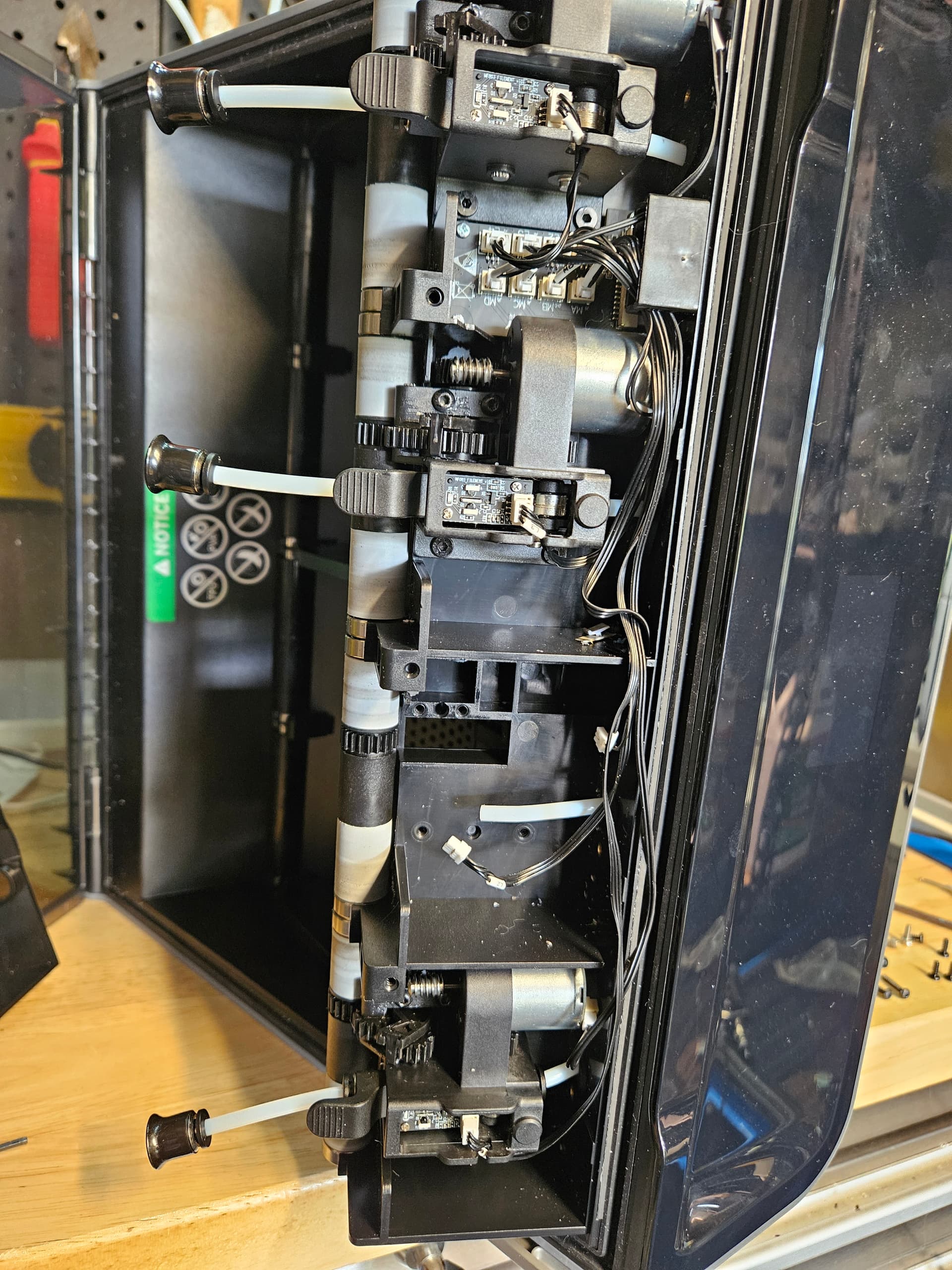

Hmm, if you swapped the entire loader for a good one and it doesn’t feed/load , then that would indicate its the controlling circuit board not the loaders,motors, loader circuit board or the loader filament detector ..
I’ve only dismantled mine enough to swap out a faulty entire loader assembly… Not opened up fully to follow the cables…which you might have to do to find what controls the 4 loaders… To find the board that needs replacing

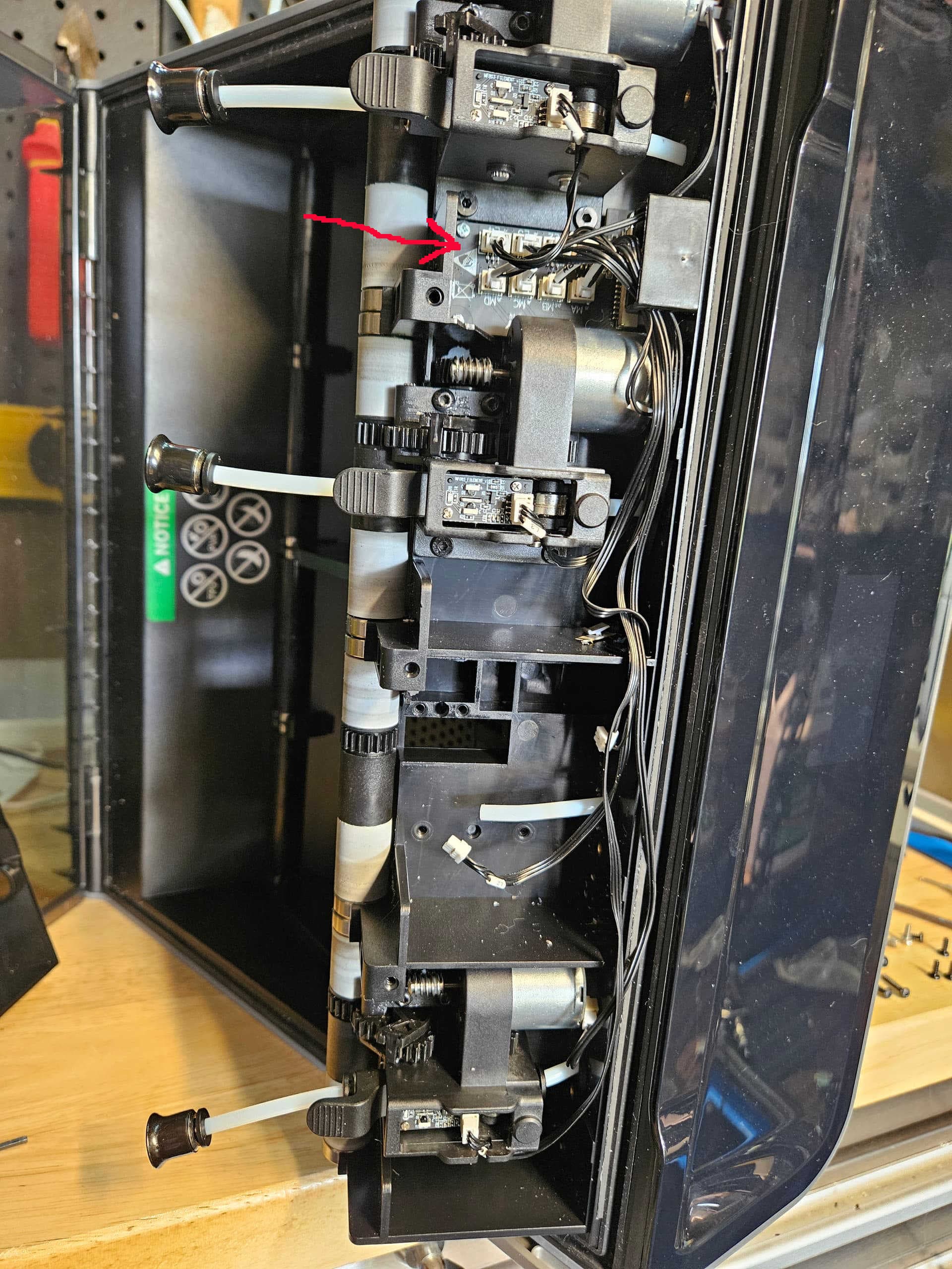

In this photo (I point to via a red arrow I show the small connector board.
When I swap the plugs on that board for loader 3 (normally not working) with 4 over then loader 3 works and loader 4 does not. This suggests the problem is on that bird or further into the CFS.
Today Creality sent me 2 new loaders despite me saying theres nothing wrong with any loader, rather it’s the connections or electronics further in.
