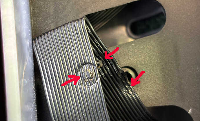

I did notice the ribbon cable was damaged in 3 places as it appears to have been crushed by the loader assembly screws at one point or other - probably by me when chasing a blockage. I would have gone back to using loader 1 and not notice this till later when I tried to use ladders 2 and then 3.

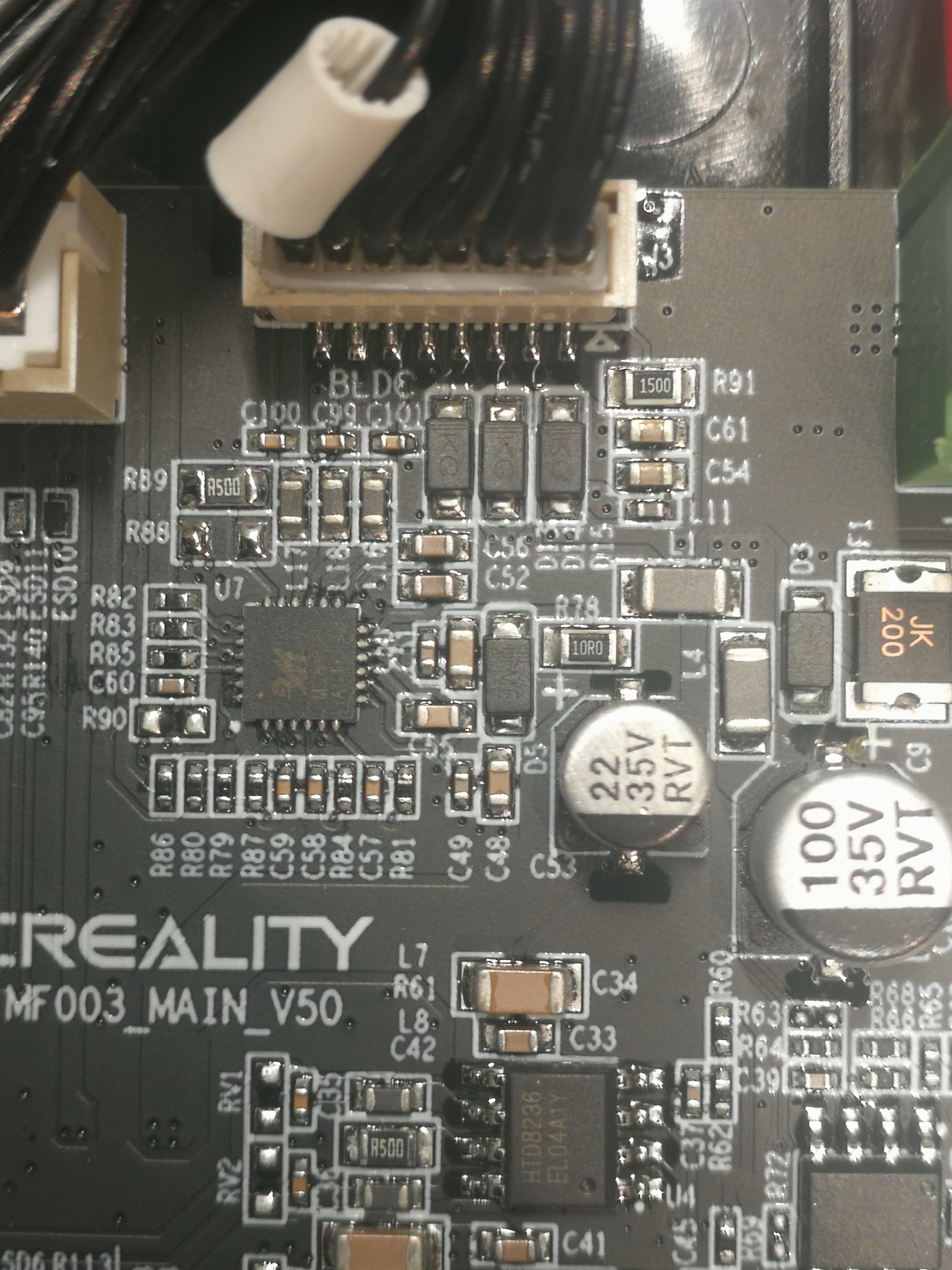

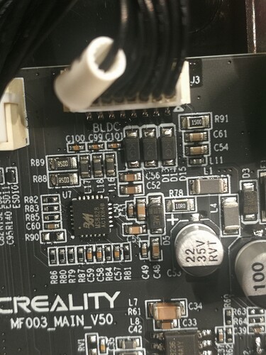

some kind firmware fail, tryen on five cfs, the same - looks like sometimes(randomly) 5way hub bldc motor feed too hard/much ignoring endswitch and stop feed by overcurrent error(red led blinks twise/sec)
cfs use ms8828 3phase driver IC + bldc hall motor + mt6826 encoder under 32f303arm and i think someting goes wrong with firmware because it is all new stuff
max current of 8828 depends of Rsense, in stock it has 2x0.5r in parallel - 0.25r - about 2.5a, by removing one of Rsense max current drops to 1.3a, so it has not enough power to eat filament, it just catch error, but continue print

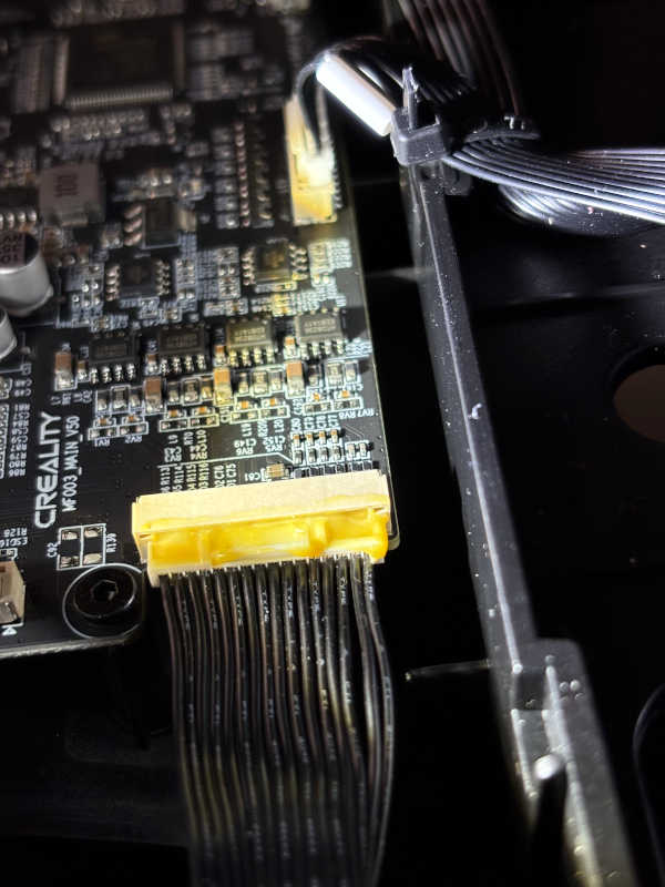

Well am pleased to report success after replacing the damaged ribbon cable - it’s the cable between the loaders daughter board and the CFS mother board.
To open up the CFS I followed this Replace CFS Mainboard | Creality Wiki
It’s relatively time consuming process with lots of screws and keeping some 6 ribbon cables from getting trapped when reassembling. The ribbon cable was the one that connects here - see red arrow.
The plug is glued onto the socket but a scalpel and a thing flat head screw drive was able to unstick it.

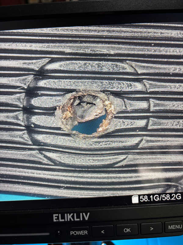

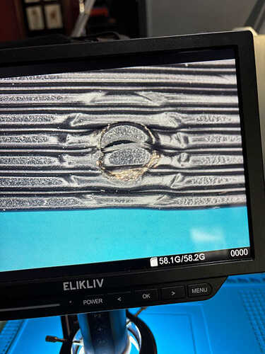

After replacing the cable I took a close up of the damage on the original cable with my digital microscope. I believe this happened when I took the loaders out of the CFS to look for a blockage before this problem arose.
When I reassembled it the ribbon cable got trapped between the loader motor block and the base of the CFS and I tried to screw in the screws and damaged the cable which affected loaders 2 and 3 only. I did not notice this afterwards as I most likely continued to use loader one some time and only later tried to use loaders 2/3 .
