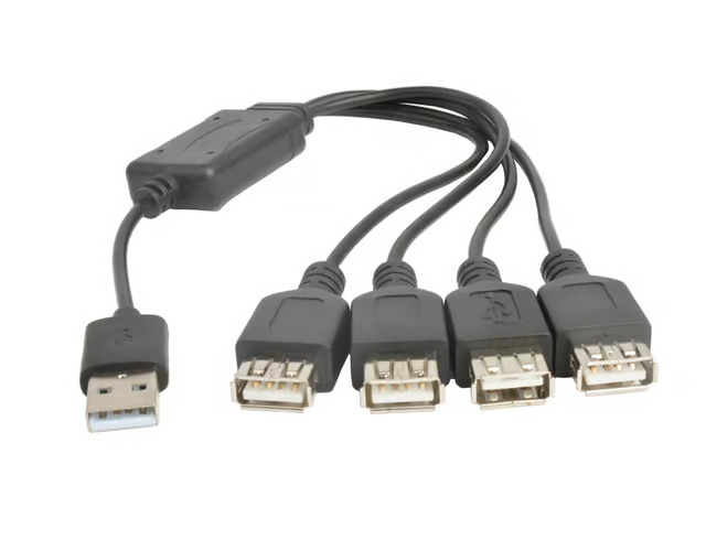

How did you solve the USB distribution internally so that the external port remained free and usable? I was planning to plug a hub into the external port.
I didn’t get a USB hub. Frause distributed the USB inside the Ender 3 v3 plus case, leaving the factory external port free. At least if I understand things correctly.
USB hubs can cause communication problems, in some cases a hub that also receives power from an external power supply may be needed.

Trying without the usb-hub sound like a good place to start. I print with the KCM connected via a usb hub and I’ve tested printing with a camera at least once without problems.
I used a octopus-style USB hub like this connected to the original usb-port on the inside. I then printed a bracket to mount one of the female USB-hub connectors in place of the original port.

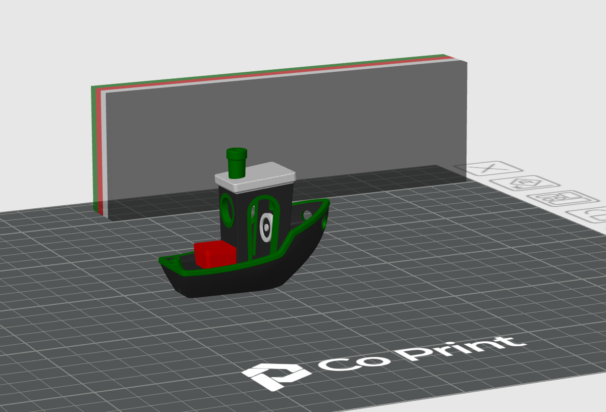

Hi, got my creality KCM last week and installed it today
After several hours (and thx to everyone who contributed on this forum) I managed to get it working
That involved enabling root access and transfering/editing files over SCP and in CLI.
But finally, I managed to send and print the provided layered benchy
Now, I’ve just sent a customized 4 color benchy, we’ll see how it goes.
edit; failure, due to nozzle being to far from the bed despite a new default mesh and pre-print calibration… the fun continues

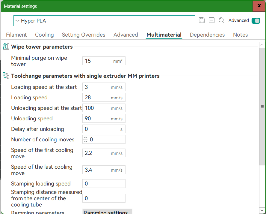

How much purge volume do you use ?
the default is 15mm3 and I have the impression it is not enough

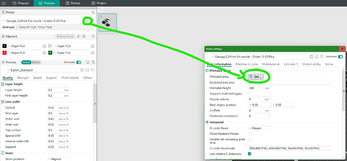

How can I modify the cfgs? It is not possible from Orca. In the divice menu, an interface called Creality print appears, which is similar to the one in the Creality print slicer. You cannot set anything here, you can only monitor the printing. If I enter the printer IP address in the browser, only this interface appears directly. It is similar to the Minsail or Fluid interface, only without the full menu bar and user interface. The printer works well with multiple colors, but the printable area is reduced due to the Coprint head. This problem is caused by the offset nozzle of the Chromahead. I solved this problem with a modified head holder console (Frause version), but I cannot change the printable area to the original 300X300 size. No matter how much I set this in Orca, it does not actually do it, because it is limited by software. I could change this in the printer cfg, but I can’t edit it in any way. But I can’t even bring it up. I’ve read all the videos and forums, but the browser interface where I can modify the cfg doesn’t appear at all. Could this be because rooting needs to be enabled on the printer? Thanks!
if you used FW .63 you don’t need to modify anything
you can change the bed size in Orca

As for purging, you need to calibrate it FOR EACH COLOR as each filament as different bleeding properties
I made this
https://www.printables.com/model/1284338-ender3-v3-kmc-purge-calibration
