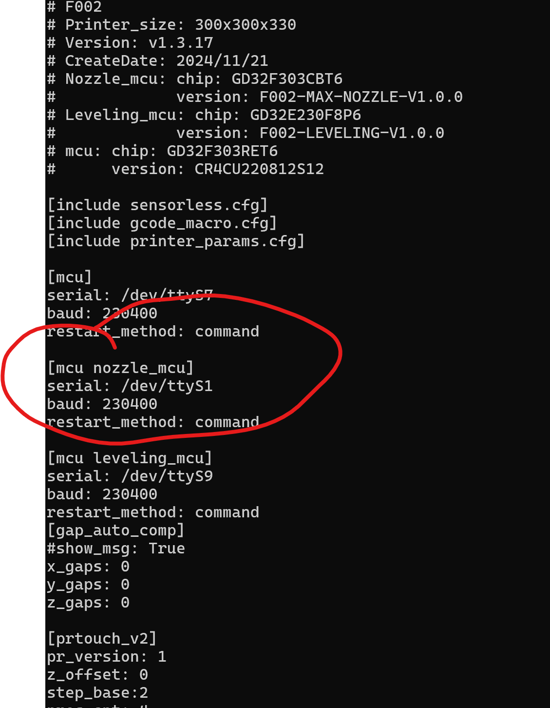

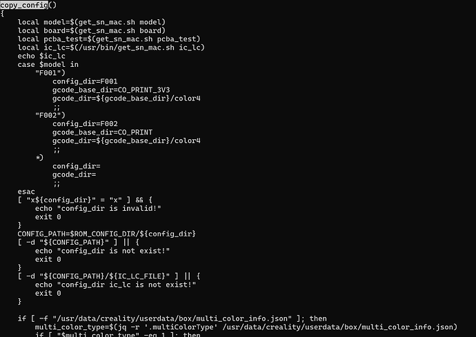

Are you using 4 colors or 8 colors, I have not thought it through but there is some code path that seems to be using the /usr/share/klipper/config/F002/color8 as the fundation of copy_config stuff.

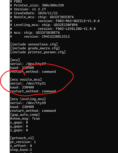

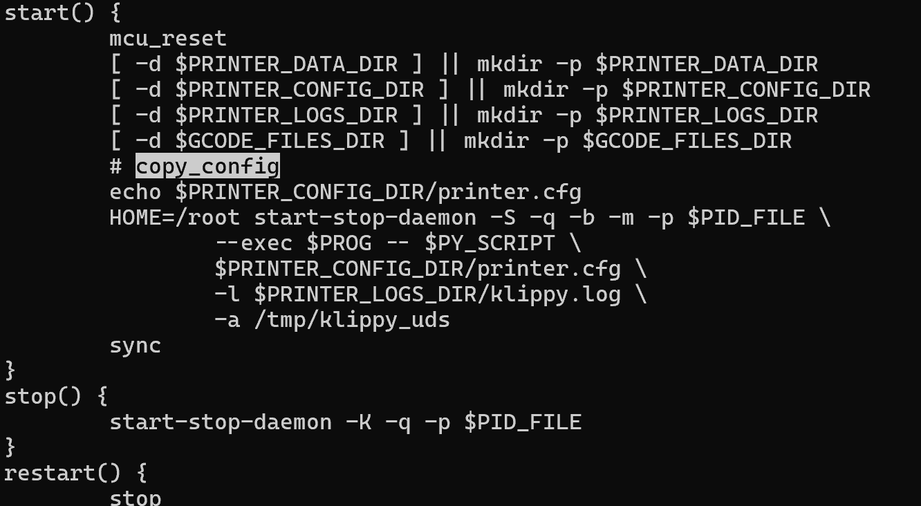

No. I tried without the USB hub it doesn’t make any difference. And from the code and config I can see that the original config should not work, because it contains the original “nozzle mcu” which would be disappeared after switching to the coprint set. And it is exactly what it was complaining, cannot talk to the nozzle mcu. Commenting that part out from the config file solves the issue. How the original config file works for you guys is the part that confuses me :frowning:
Could you take a picture of the code in question?
I would like to look at my own config files for comparison. I would be curious to know if there is a difference.
I think it must contain the original head codes, because the firmware must be installed with the original head, in an unopened state. Although I haven’t tried it, I have a feeling that if I hadn’t switched to the Coprint set after the firmware update, it would still have worked with one color, with the original head.

Here are some pictures I captured. It would be fun to dig into it to find the root cause.

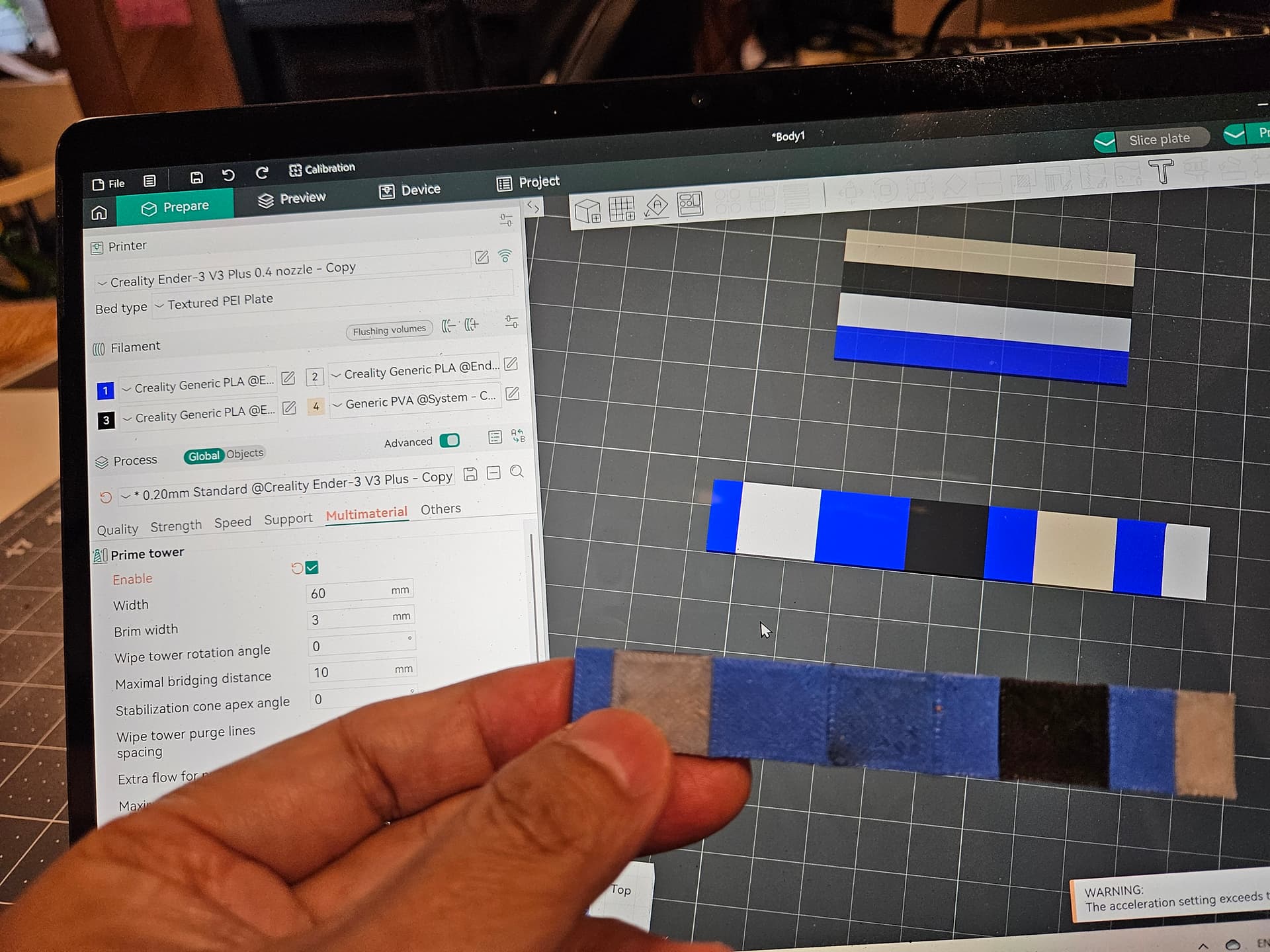

I still have not totally figure out the multi color printing in Orca Slicer yet. I thought my settings were correct, but the result does not look like what I would expected. :frowning:

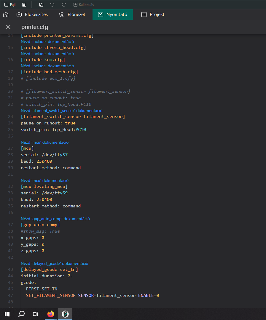

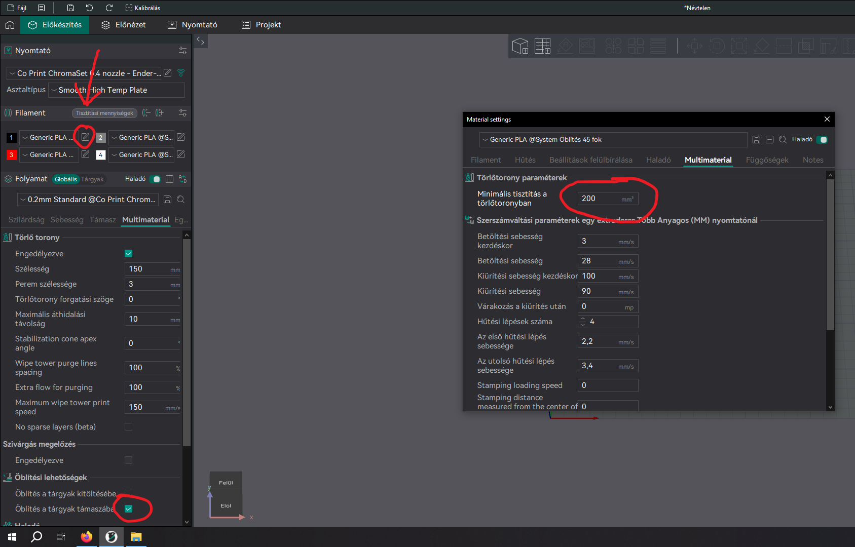

8 I do not use the blue fasteners to the 1 in Ben, and the Filament replacements are no problem. There was a problem with the Filament Sensor alone, which did not work sometimes, but we also described it above. You can need it in pressed condition. It is advisable to roll the 4 dosing extruder spring screw up to a minimum of half a quarter, up to half the road.

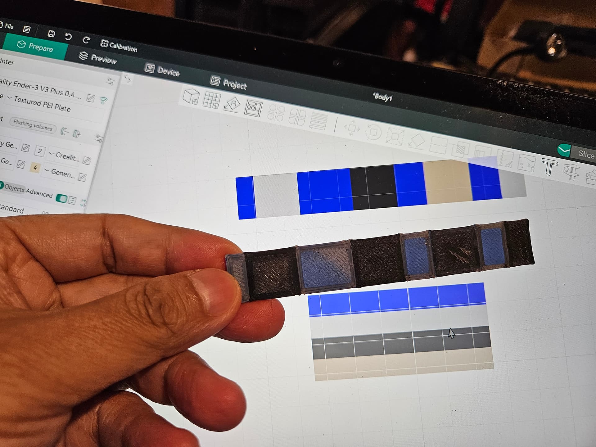

And for the other printing, you can do a rinsing test, but I set it up to 200mm3 for each color and it works well for me. This must be provided separately. I attach a picture of CFG and rinse.

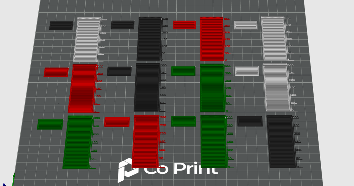

I did this remixed this for calibration, pretty neat
FYI do NOT use purge tower when calibrating purge, or your calculations will be wrong
Thanks I will give it a try. As of the printer setting, yes I know I was supposed to use the “CoPrint” printer, I was just experimenting my modified version of the “Ender” printer. But as of color change, I tried both and no difference found
I will give it a try. Thanks!
