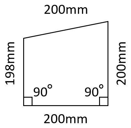

The model’s geometry is distorted when printing.
If I print a 1mm height square the size of the plate, the left side will be 2 mm shorter than the right. The far right corner will be incorrect (obtuse), and all other angles will be 90°.
Is there a way to fix this?

The problem is that the size along the axis is not uniform.
The far left corner is distorted.
On the 200x200 mm model, the left dimension along the Y axis is 2 mm smaller.
On the 100x100 mm model, the dimension is distorted by approximately 1 mm.
I don’t understand how adjusting the Steps will solve my problem.
