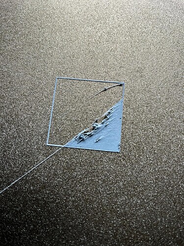

I have the same problem. First layer solid infill either doesn’t stick or looks like this
z offset looks to be a little high try adjusting it in 0.05mm step while printing a wide skirt.
CHeck your height of the bed, it is unlikely you would need a skirt/brim for that shape.
The skirt was suggested for a reason…
Exactly, you can see the filament being laid down onto the bed, it takes a little trial and error but you’ll be able to see it working. A bit like tuning a guitar.
