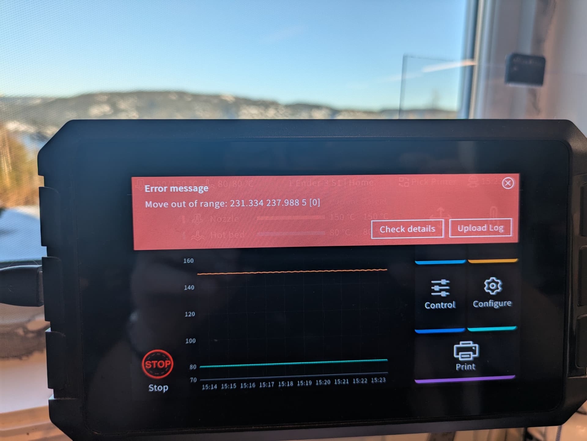

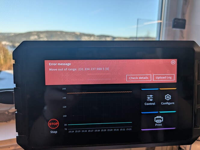

Hello :slight_smile: I use a Creality Ender 3 S1 together with Sonic Pad, this has been a good combination for my use. I have a problem that has arisen recently. Every time I start the printer with a new job I get this error "Move out of range: 231. 334 237. 988 5 [0] .
This happens every time in the same place when the printer takes a “bed mesh (4 x 4)” before it starts printing. Each time this happens in the same place. It starts probing at the front left corner, but when it gets to “bed mesh” point no. 12, which is the outermost point (bed mesh line 3) to the right, it stops and I get this error message. The 0.0 position is set correctly, at the front left corner. What have I done wrong? and how can i get this working again? Would greatly appreciate it if any of you have any suggestions on how I can solve this. Sincerely, Terje T
Have you picked the wrong printer profile, I know that when I accidentally use my Ender 5 plus profile on my V3SE printer it throws a similar error.
Just checked the Sonic Pad and the printer Ender 3 S1 is selected. Many thanks for the suggestion. More suggestions welcome :slight_smile:
