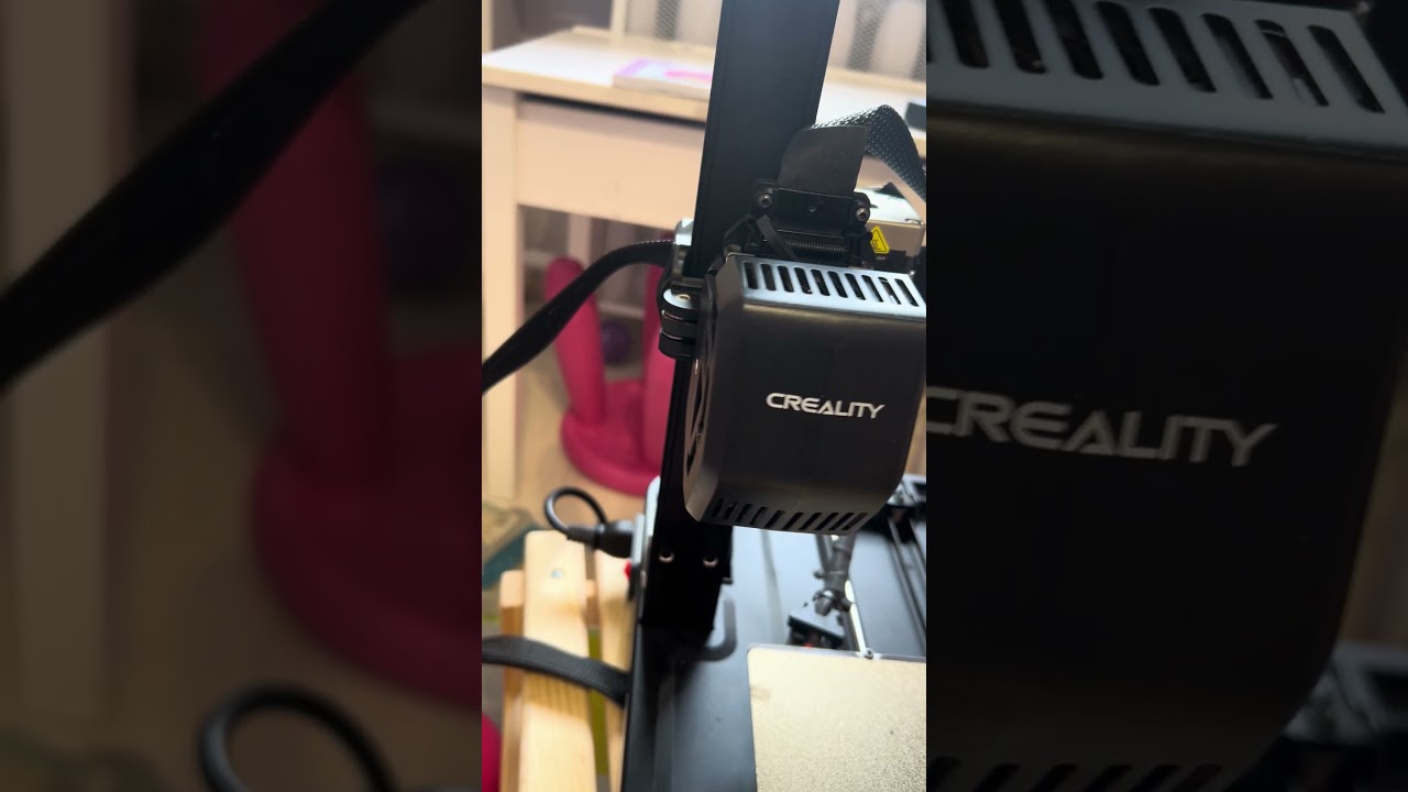

Creality Ender 3v3 SE x limit switch not working
When I try to do homing on my 3D printer, next is happening.
Print head is keep moving and does not react when it reach the end.
Printer was working before.
What I already tried to do I check is switch is pressing - yes it is pressing but does not work.
I tried to press switch manually - this does not help.
I send m119 command to printer to check if switch can be triggered, this does not help.
I changed switch with full print head board, but this does not help.
As I understand the problem can be related to cable or mainboard itself. Are the any way to understand where the issue coming from?
