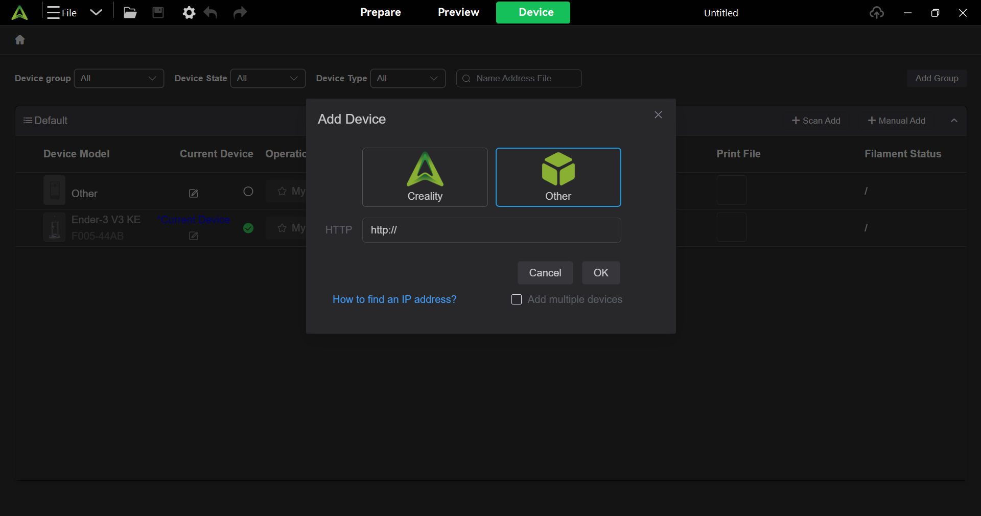

I’ve been having the same intermittent issue with Creality Slicer and my K2 Plus. I went to start a print yesterday and it couldn’t connect. Updated the printer to the latest firmware and the slicer was able to connect again (probably due to reboot). A couple hours ago I was successfully able to connect and send a print, the print finished, but the slicer lost connection shortly after the print started. I am able to connect via the cloud/android app and send and monitor prints just fine. I updated to the current version of the slicer just now and added firewall rules to make sure it was not being blocked and nothing fixed it. The +Scan Add does not detect anything and when I do manual add, it also does not detect anything. This is definitely weird because like I said, I can monitor everything just fine from my phone.
edit: i can also connect fine w/ Orca Slicer
If you manual add using “other” and enter the IP address after http:// does it connect? It does for me, but that is the only way I can get it to connect. Like you Orca connects just fine.
It does if I add the port after the IP address - http://:4408
But just the fluidd interface comes up like with Orca and I can’t see the camera output. This interface is fine, but it’s strange I can connect several different ways except through what would seem to be the ideal way.

yes , works with mine ( Cr-m4 ) . It´s the only way .
