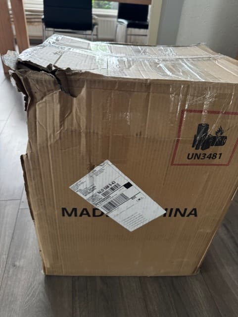

This is how I received the package. Thanks UPS!!!
cant imagine wat that package have endured
That’s pretty insane, lol. Not even worth opening IMO.
I definitely would NOT have signed for that.
I didn’t and refuse to accept it. Also filed a complaint at UPS. I also informed Creality EU about this and no answer from Creality nor UPS
