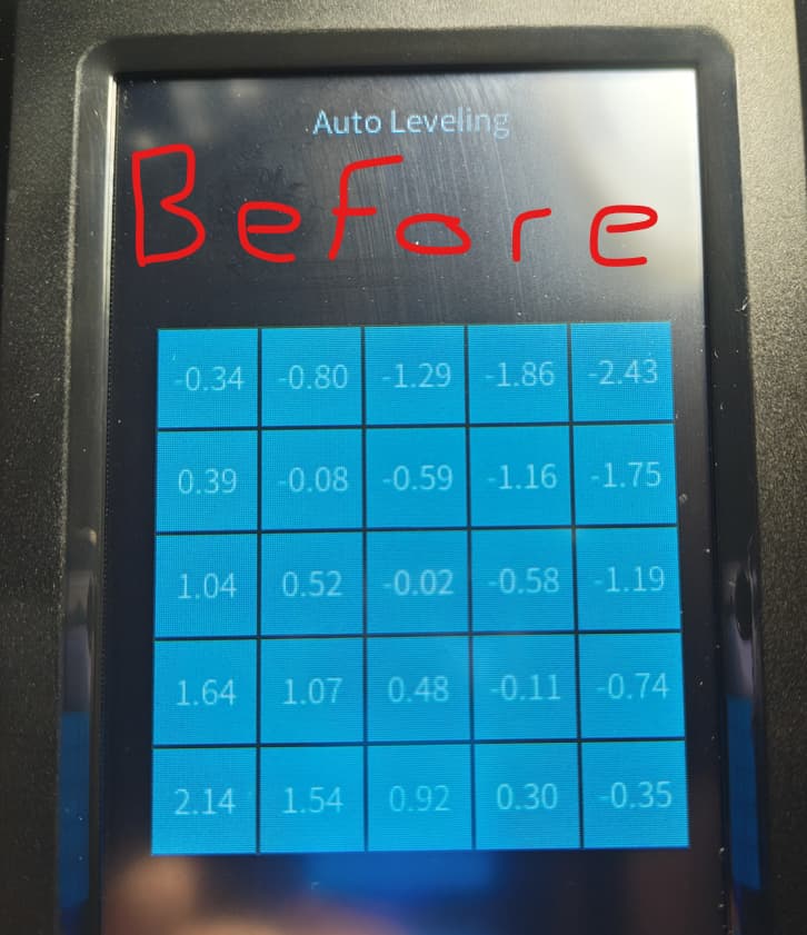

You’ll thank me. I started getting the dreaded bed is >2mm out of level warning. Took it apart and one of the bearings was almost shot. Lot’s and lot’s of play. I’ve noticed it was getting worse then I got the warning window the other day.

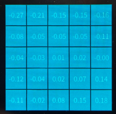

I upgraded my Ender KE to y-axis linear guide rails. Here are my before and after auto-level data. The test with the guide rails installed I allowed the machine perform auto-z offset. My offset went from what I was using at -2.87(ish) and sometimes I would dynamically change that during printing. Now the machine has a new z-off of -3.07. The linear rails made a huge difference in the bed level.
AFTER

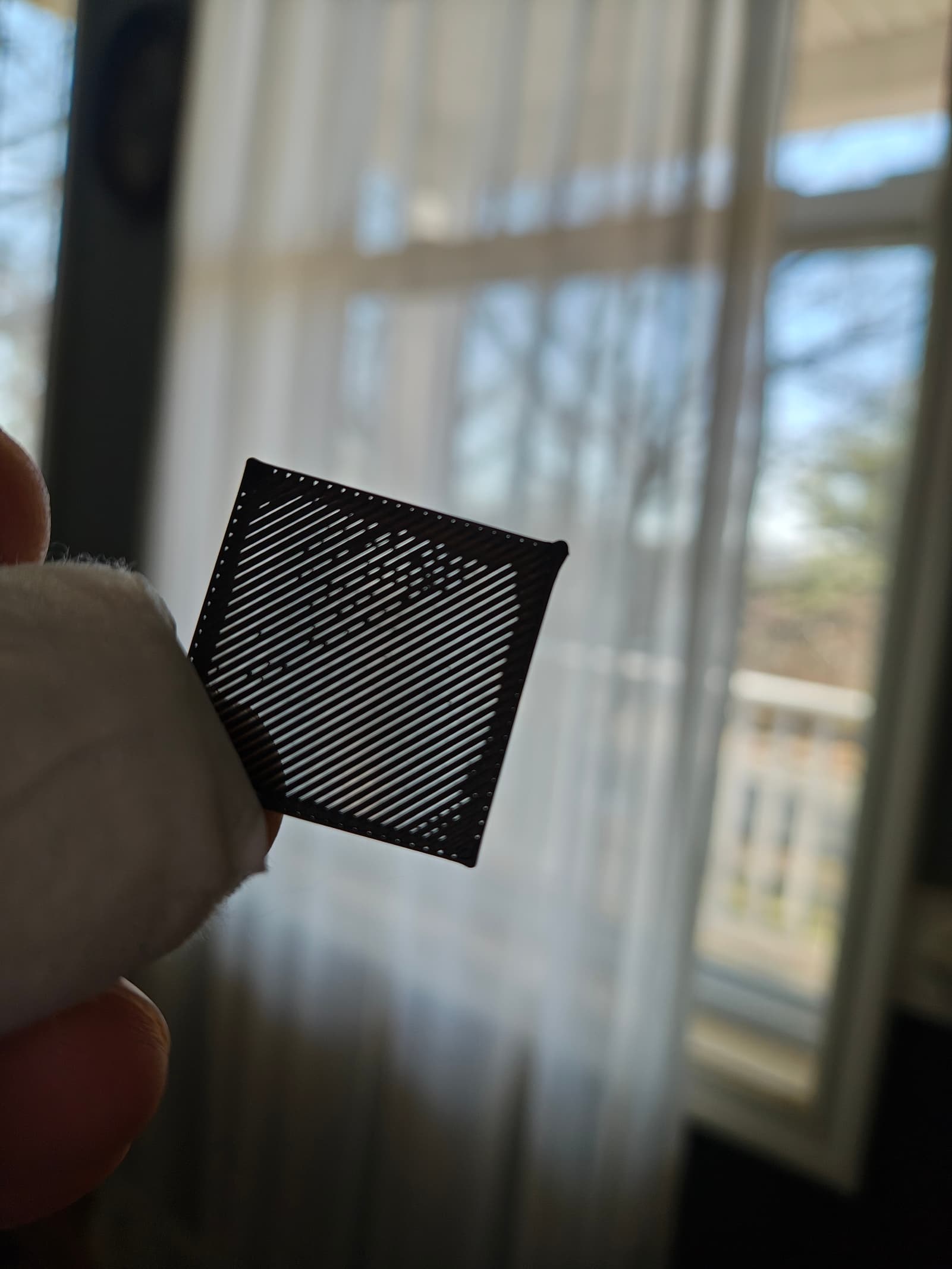

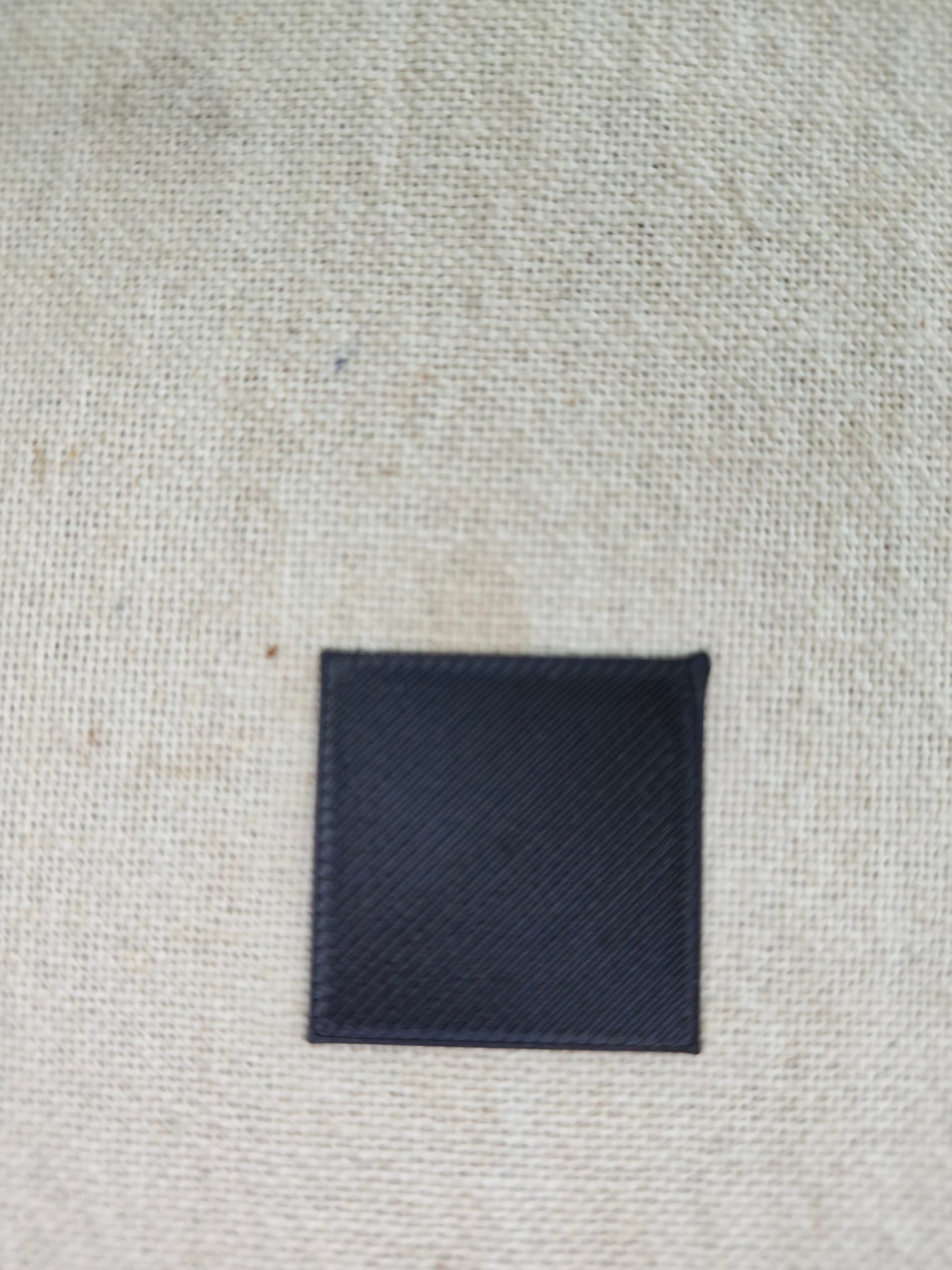

Super flat now. No shims or anything. This was just after installing the kit. Printed a test square with PLA and it came out great on the auto Z-offset but when holding up to light it needs some tweaking.
I checked the auto Z-offset with paper and it will need a little adjustment then print some more test squares and a full bed square. Working on that now.
