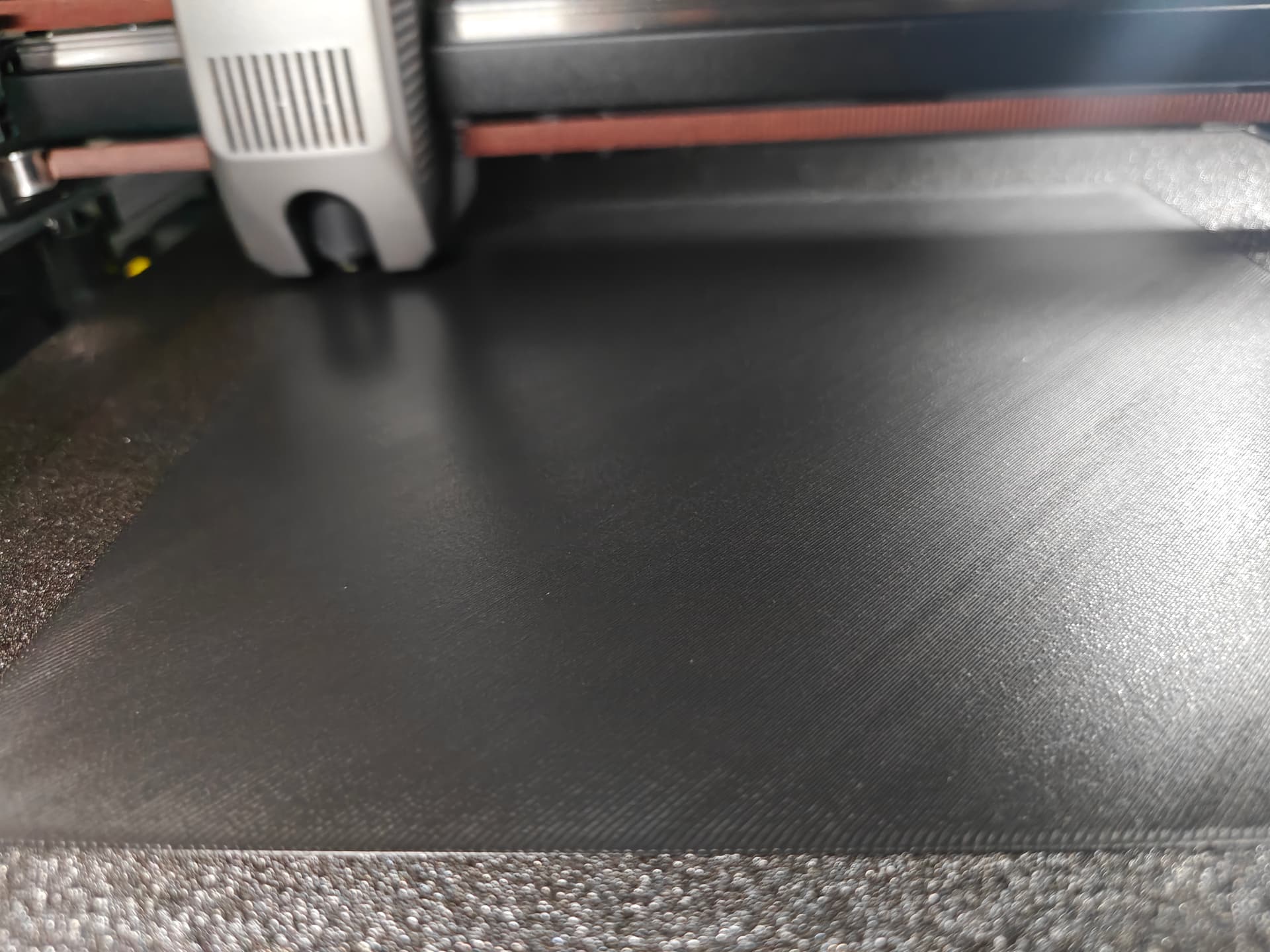

I dont get why sometimes even pla need a +0,020 z-offset that is happening after the last firmware update.
Try slicing and printing a small job. Then slice and send the same job but do not print - walk over to the printer, and print the sent file. Apparently, there is a Z issue where the ā€œslice and printā€ has a different Z offset.
Martin, I never used z-Offset for PLA on 500+ prints before (unless I printed on 3rd party flat print bed with carbon fiber pattern) but I changed nozzle now and need to use z-offset of 0.02 even for standard PLA. On other side I needed to use some z-offset for PETG but not for ASA/ABS.
I did not investigate too much in firmware to see if this can be adjusted somewhere else and using anyhow my own printer profile with this macro adoption to automatically change z-offset based on filament or print plate.

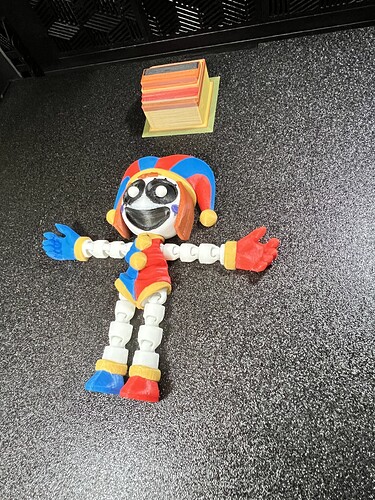

This is 7 colors, 24 hours of printing. 160g in the model, 500g in the bin;)
Rdtsc is right no problem printing from the printer at least for 2 prints now. My first 150 pla prints no problem. Its also not consistent its not every print. And its not always the first layer sometime it was the second layer that needed the z-offset(maybe not heated long enough). For now i send the print to the printer and start print from the printer. I heat the bed to 55c for 15/30min and set the ambient temp to 35c and the exhaust temp to 40c. This because after 20min printing the temp wil be around that so there is not to much divergence when the bedmesh is made. I clean everything after every print. Al screws are tightened. Belt tension is ok. Here a picture of a good first layer at least good enough for me.
