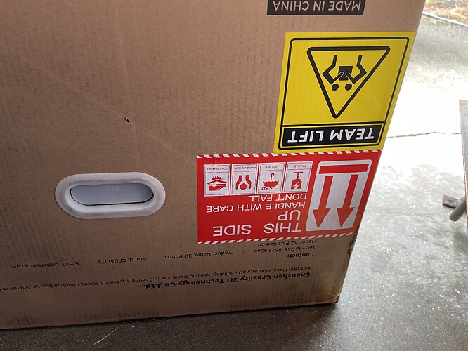

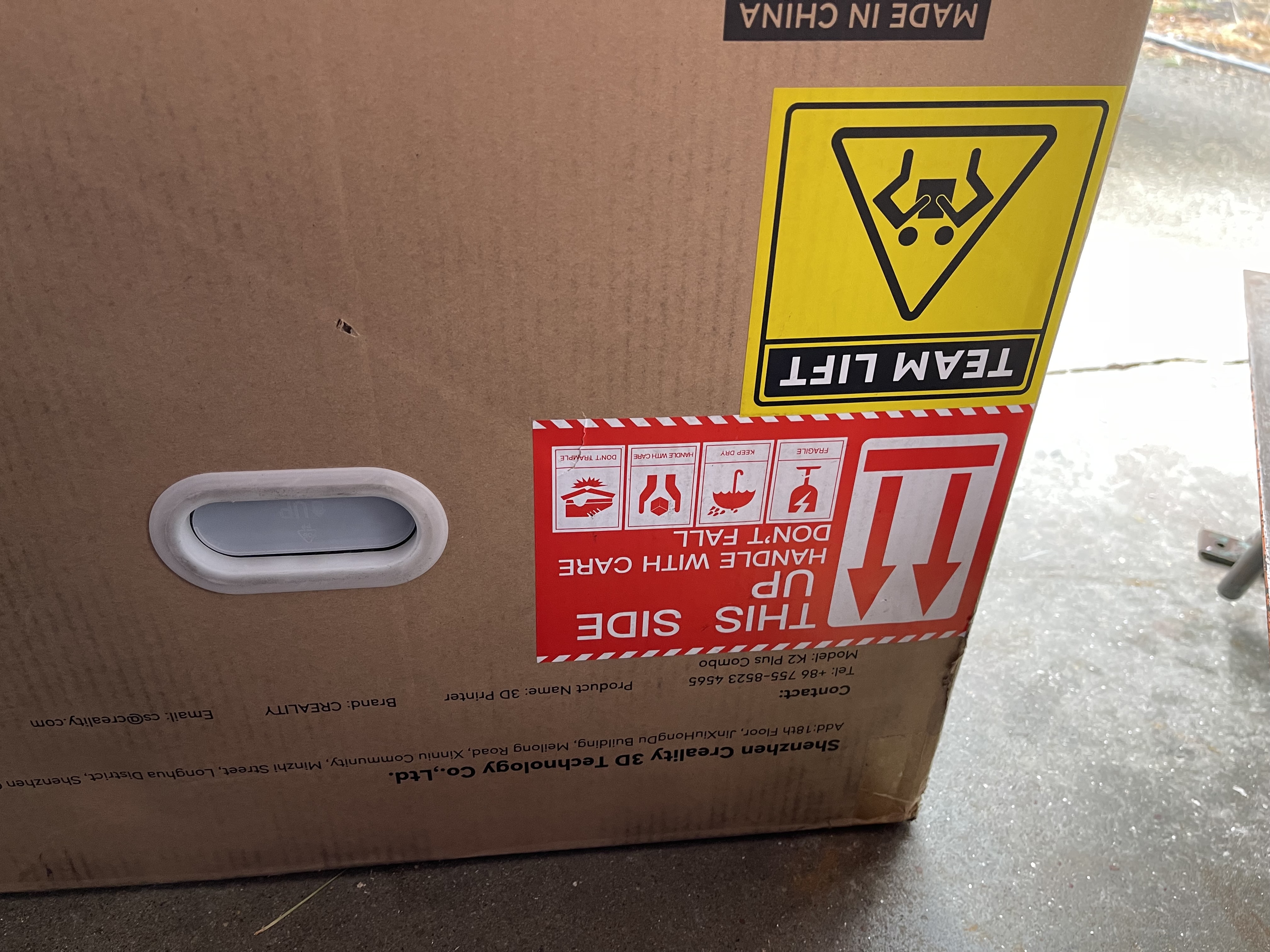

I have something good to say about the K2 with CFS…
…I received mine today and all parts were intact. The door hinges were still attached and nothing was damaged in shipping, despite FedEx’s best efforts to destroy it during delivery:
Hopefully my good fortune will hold out when I actually start printing with it.
