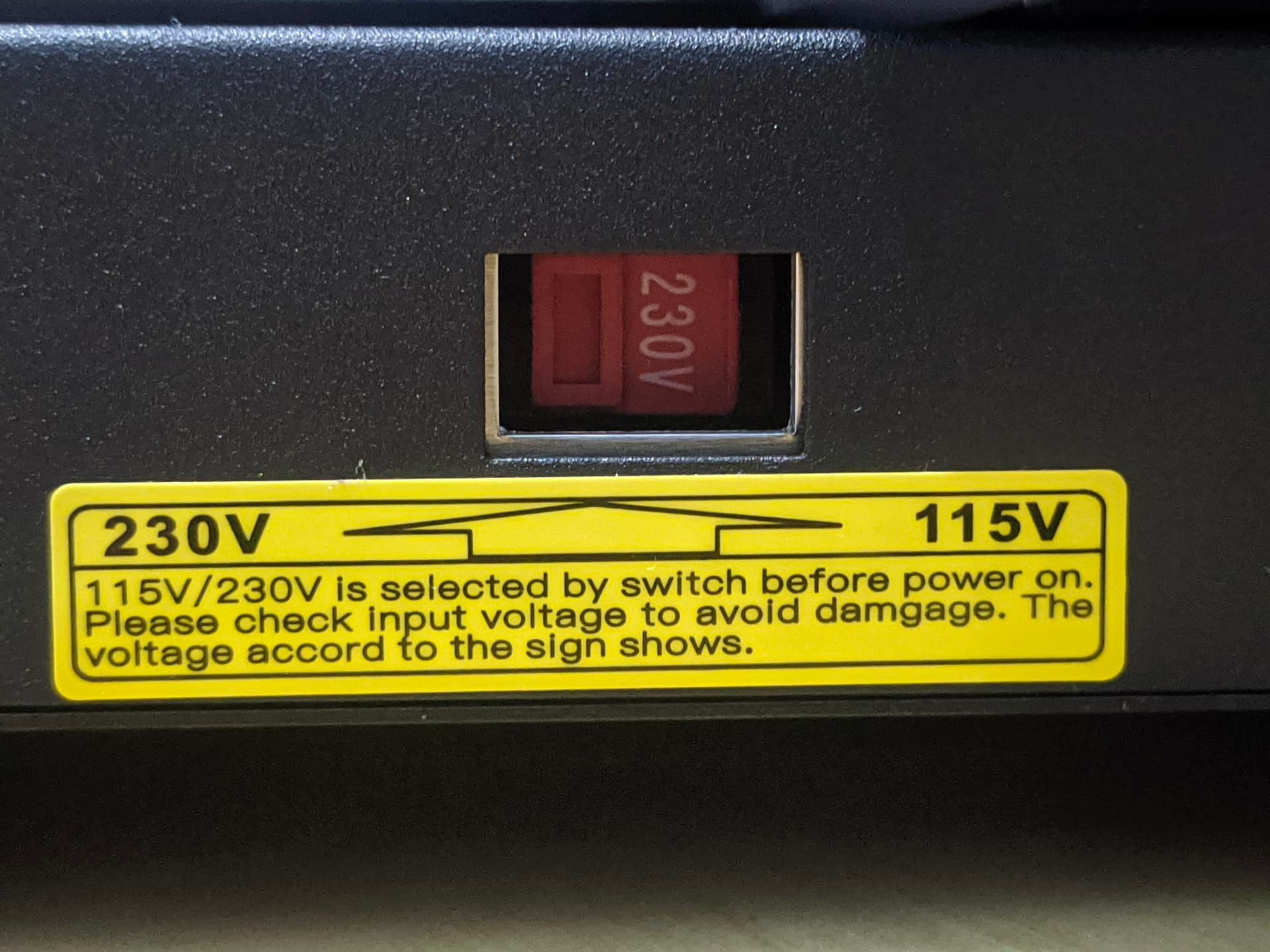

Have you checked to see if the printer has a voltage selection switch? If it does make sure the selection switch is in the correct position for your region.

Just to be sure as you didnt say whether you had checked the voltage switch or not…
There should be a switch on the machine that looks like this…
Ensure it is in the 115v position with the printer turned off.
Yes, That is correct. it is set tp 115V. What else should I check? Also, when you do respond please provide some troubleshooting ideas outside of the simple stuff.
