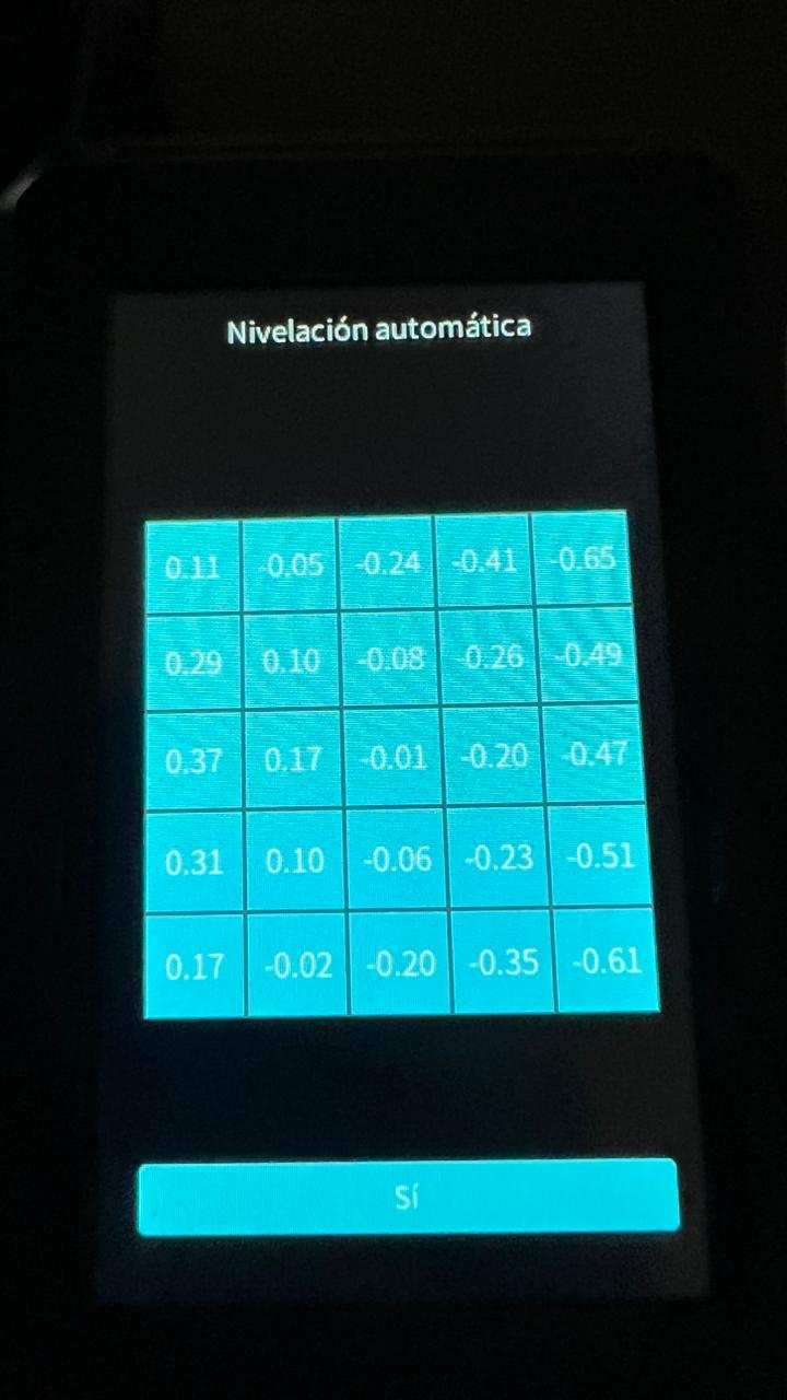

Hi, i recently bought my first printer, an Ender 3 V3 KE.
I have a problem with auto-leveling, my printer does the auto leveling protocol but i think it doesnt work well because in big models with flat surfaces on the first layers it looks bad like ripples, also the nozzle i think it collides with the material because it does a scraping noise. I share my bed level values, but the printer its supposed to compensate up to 2mm. I´m new to this 3d printing world so i dont know so much.
Please if someone can help me it is really appreciated!!!

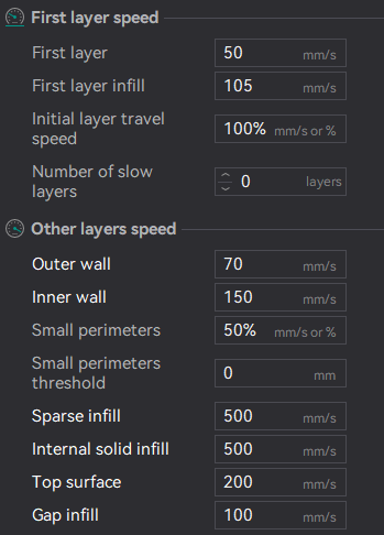

Hi, thanks for replying.
I´m using Creality PLA, recommended temps are 190-230°C for the nozzle and 25-60°C for the bed, I am using 220°C for nozzle and 55°C for bed. I´ll put my speeds below, and the offset im using the machine calibration, i dont know how to properly do it myself.

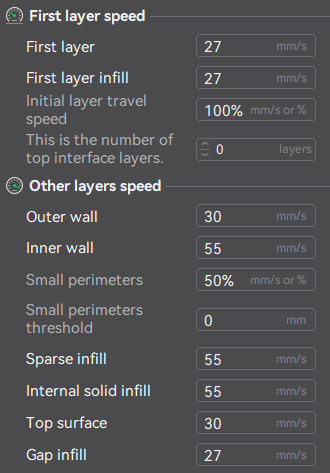

I think you should try slowing your speeds. This is my settings for speed in my Ender 3 V3 KE:
Slow printing is actually one of key factor to get good quality.
