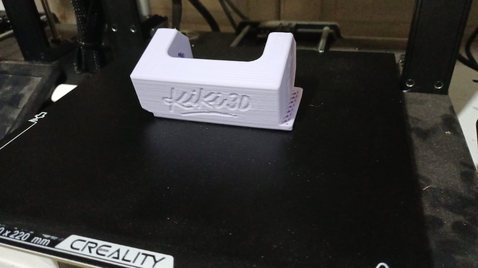

Hi makers!
I have a print farm with 15 ender 3 v3 KE and after 1000 hours of use, 3 of my printers have the same problem.
Layer shifting on the x axis. It normaly happens random once per gcode after arround 30 min.
Things I’ve tried:
Examining the hardware
Tightening/loosening the x-belt
Greasing axis
Change x stepper motor
Aling x pulies
Check mainboard for overheating
Root and increase the x stepper current to 0.95
Reset the machine
Change the usb
Change the gcode
And yet, the problem persists.
I could print ultra slow, but 12 other printers work just fine with the current speed configuration, so I don’t think that’s the problem.
I use orca slicer with a .6mm nozzle, 125mm/s print speed and 400mm/s for travel.
