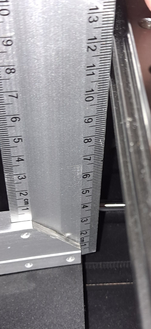

This event must have bent the gantry, I checked with a square and it is bent compare to the print plate. I tried loosening the gantry screws and retighten them but it didn’t help. The only thing I can think of is physically trying to bend the gantry back into the right position but it is a pretty risky move.

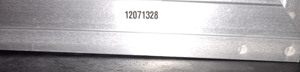

Below photos of how much it is bent. I force the angle iron against the two rails where the printer head and took a photo of the angle iron against the printer bed. There is quite a large deflection.
Bonjour, ton portique est il vraiment tordu . tu devrais en vérifiant avec une règle posée à plat si c’est le portique ou le lit d’impression qui est tordus. si c’est vraiment le portique il te faudra le démonter et le redresser avec deux barres et un étaux. Bonne journée
Thanks for the advice. It was the whole gantry that is leaning. The gantry wasn’t bent after all. I could fix it by disassembling the gantry from the base and putting shims under the legs. I used these:

The gantry is now as leveled to the bed as I could get it.
