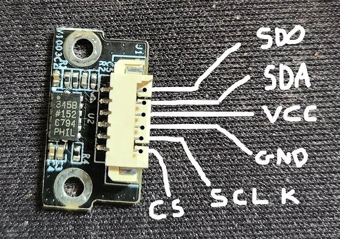

I’m playing with the SPI port that is used to connect the g-sensor. Looks like the USB-C port on the back of the pad is just connections to the SPI bus. My guess is that USB connector and cord are being used as the twisted pair wiring transmits better.
Using a Pi Pico, I’m able to get a byte back and forth and blink a LED. I’ve shortened up wires, wasn’t always getting transmission. Don’t have a logic analyzer and my old scope is too slow and seems to be dying. So marginal results right now, about to dig deeper.
Pinout for connector from reddit:
Mating connector for sensor cable that works.
To transfer using SPI from command line in rooted shell:
cmd_spi transfer /dev/spidev2.0 0x55
Pi Pico is sending back a couple of bytes as well but I haven’t gotten very far yet.

So, with SD0, SDA, SCLK, and CS, there may be 4 easily accessible gpio pins available.
I’m wanting to add a MMU, some physical start/stop/pause buttons and status LEDs. I just have to get reliable communication through SPI or GPIO, a polling program on the KE (probably python), a button/LED/MMU control program in C on the Pico.
Thoughts or advice greatly appreciated. I’m a machinist by trade and just hacking my way through C and low level Linux.
