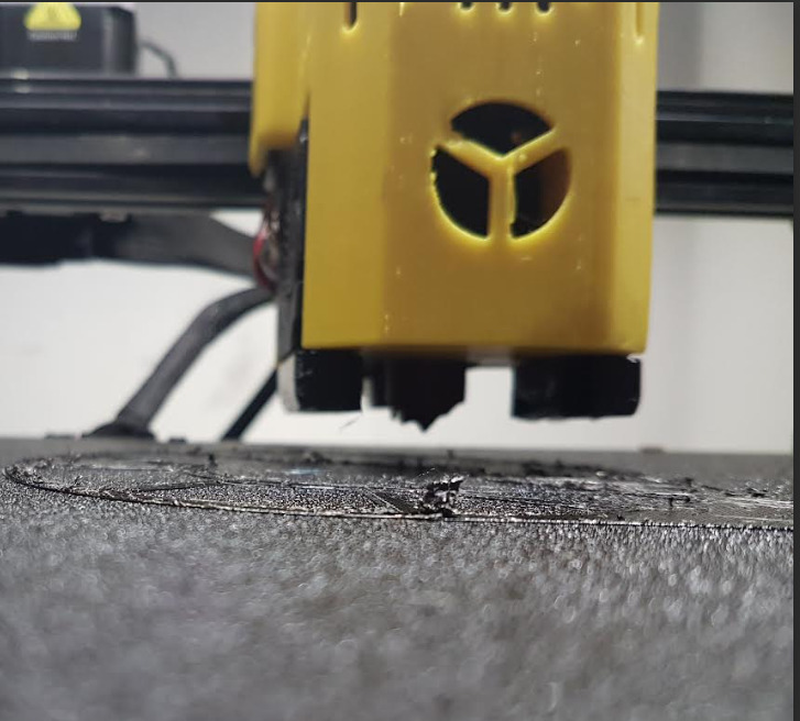

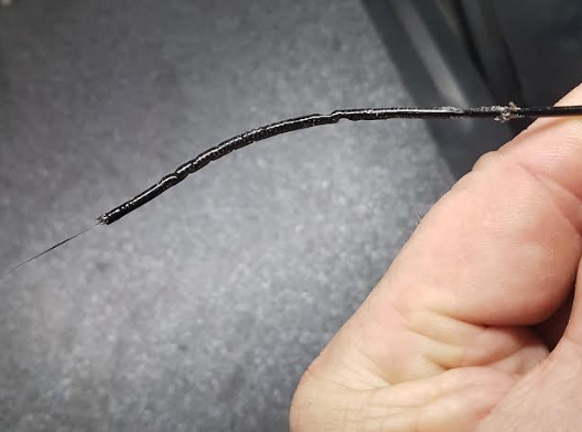

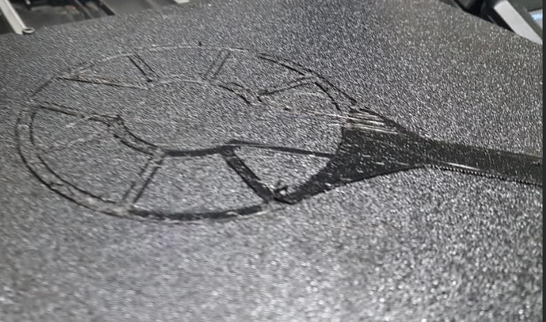

I tried another print which failed. I did not notice any ticking/clicking sound, even with the bed movement. You can see from the attached photo how much was printed, the height of the nozzle off the bed (where it didn’t print) and the filament when I retracted it.
If there was a ticking sound, that would mean something is blocking the filament.

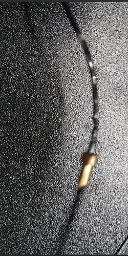

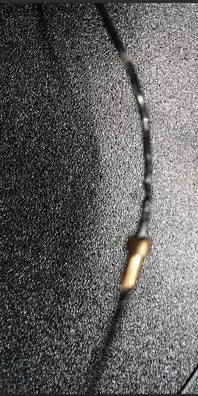

Have you checked the hotend cooling fan, The creality fan is weak I would not be surprised if this has failed and is causing heat creep up the nozzle.
By the way, the first photo looks like a wrong z-offset :sweat_smile:

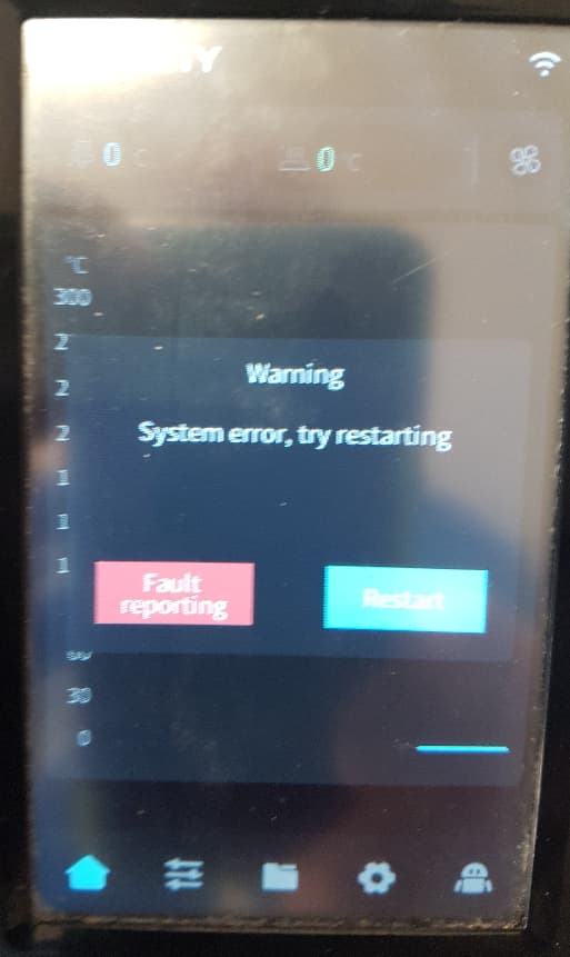

Well that was fun. After taking it apart, reading the voltages and doing continuity tests I put it back together and it won’t start up. It did look like a couple of the capacitors were black on the leads which could mean they are no good. I’ll have to take it in to get it fixed.
