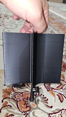

Check out my prints with VFAs
Thank you!
Hi guys.
Vfa test
Speed 100 to 300 step 10

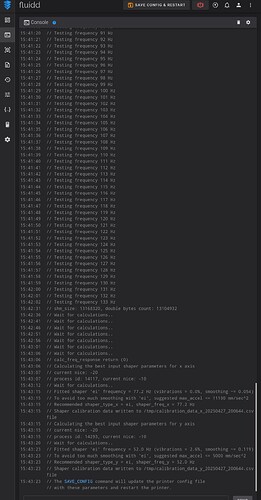

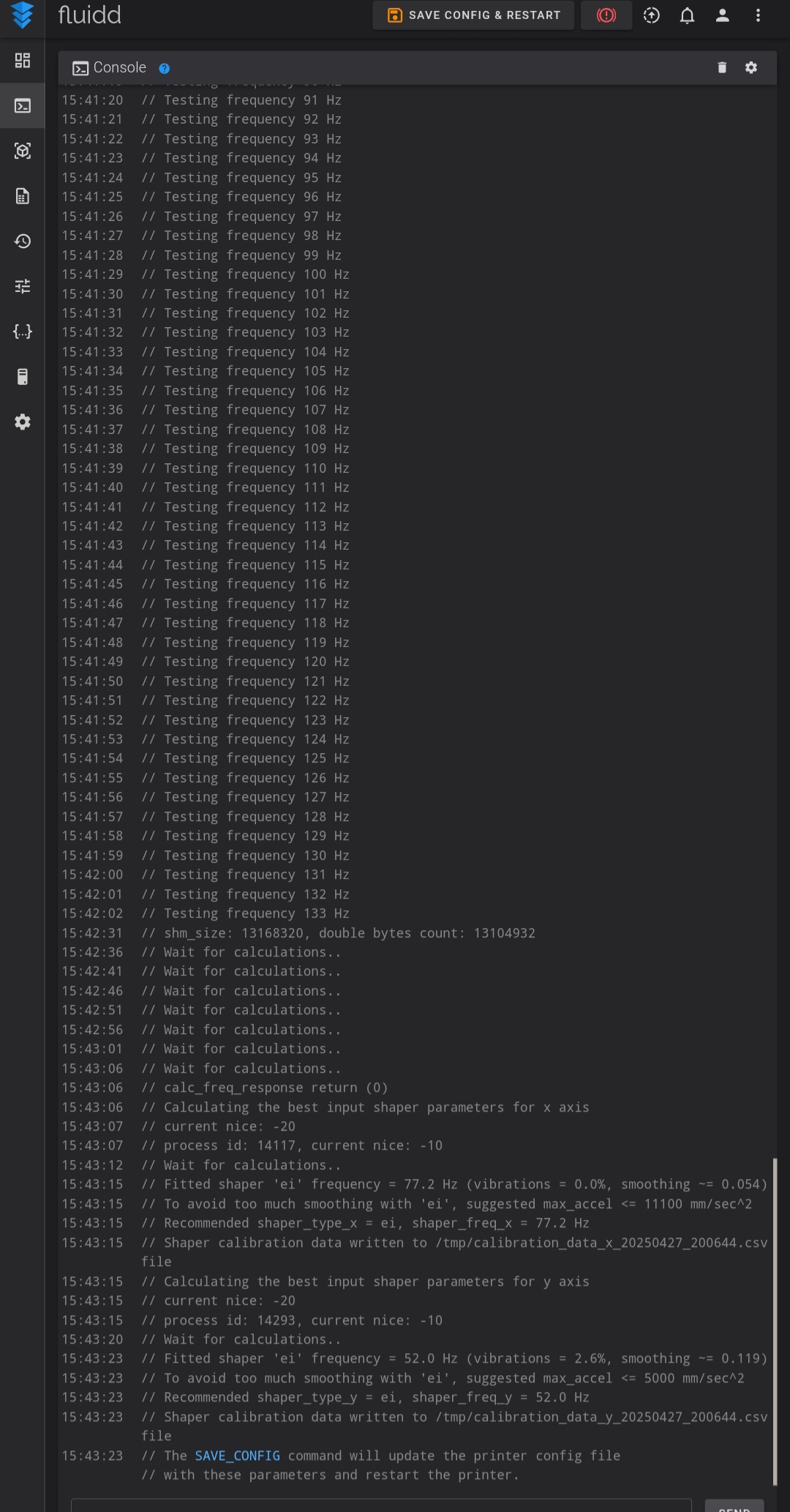

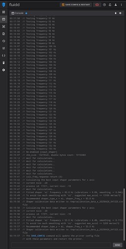

Hello again, everyone.
I just tested the belts using the Pano Tuner app.
Previously, when the belts were loose, the VFA test showed about 65 to 75 Hz, and the ringing was eliminated above speeds of 160 mm/s.
Now I tightened the belts again. I remembered that in one of the forum posts, someone mentioned that the belts should have a clear “toothed” profile visible from the side of the printhead, not aligned straight — I did that too.
Now with the tightened belts and a frequency around 95 to 100 Hz, the VFA has worsened, and ringing is eliminated above speeds of 190 mm/s.
The printer’s noise has increased as well.
The vibration is clearly noticeable along the X-axis.
I also checked something else:
With the belts loose, Input Shaping tuned the X-axis acceleration to around 11,000 mm/s².
With tightened belts, it tuned it up to 13,000 mm/s².
Do you think that’s related?

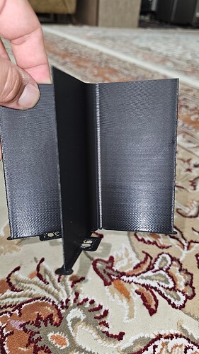

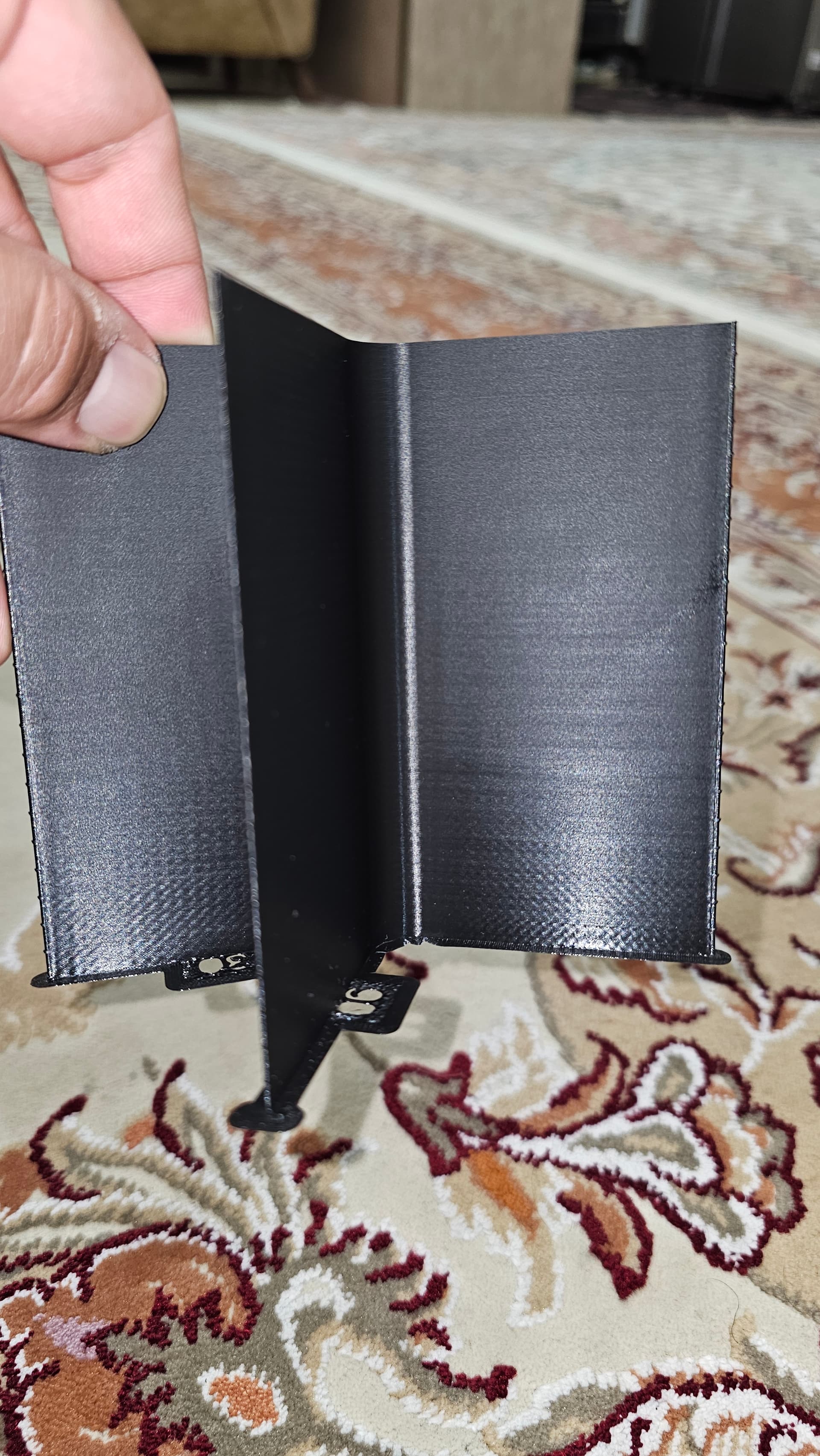

With 95 to 100hz belt
With 65 to 75hz belt

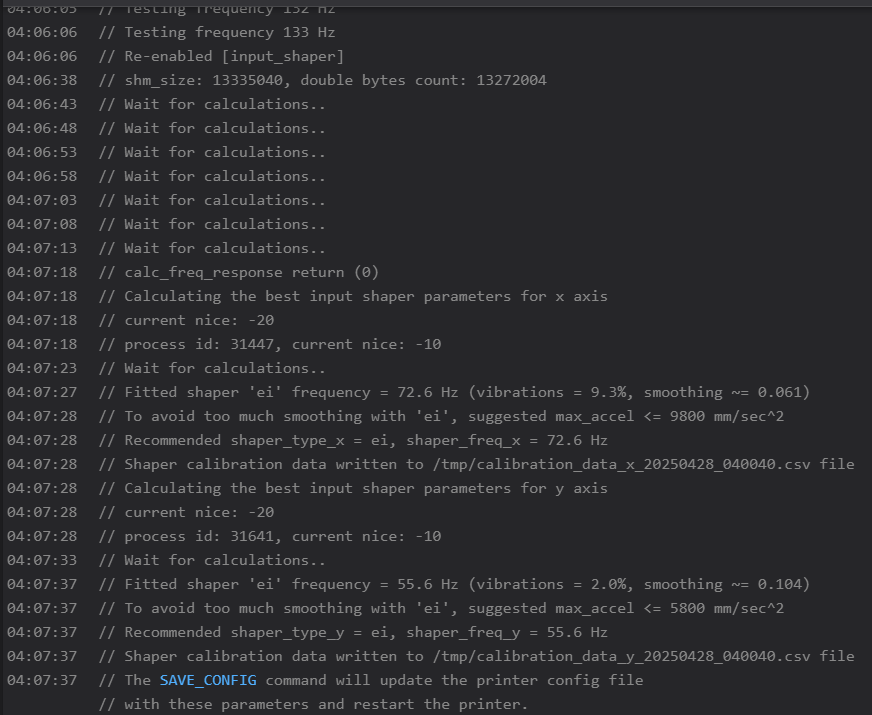

Сейчас тоже просто попробовал натянуть ремни по их видео на ютюб, но по другой причине в некоторых темах писали что натяжка ремней может помочь с косяками стола. У меня во fluid был 0.75. Сейчас тоже попробую запустить проверку и закину результат
вот мои параметры после настройки по видео creality/=
