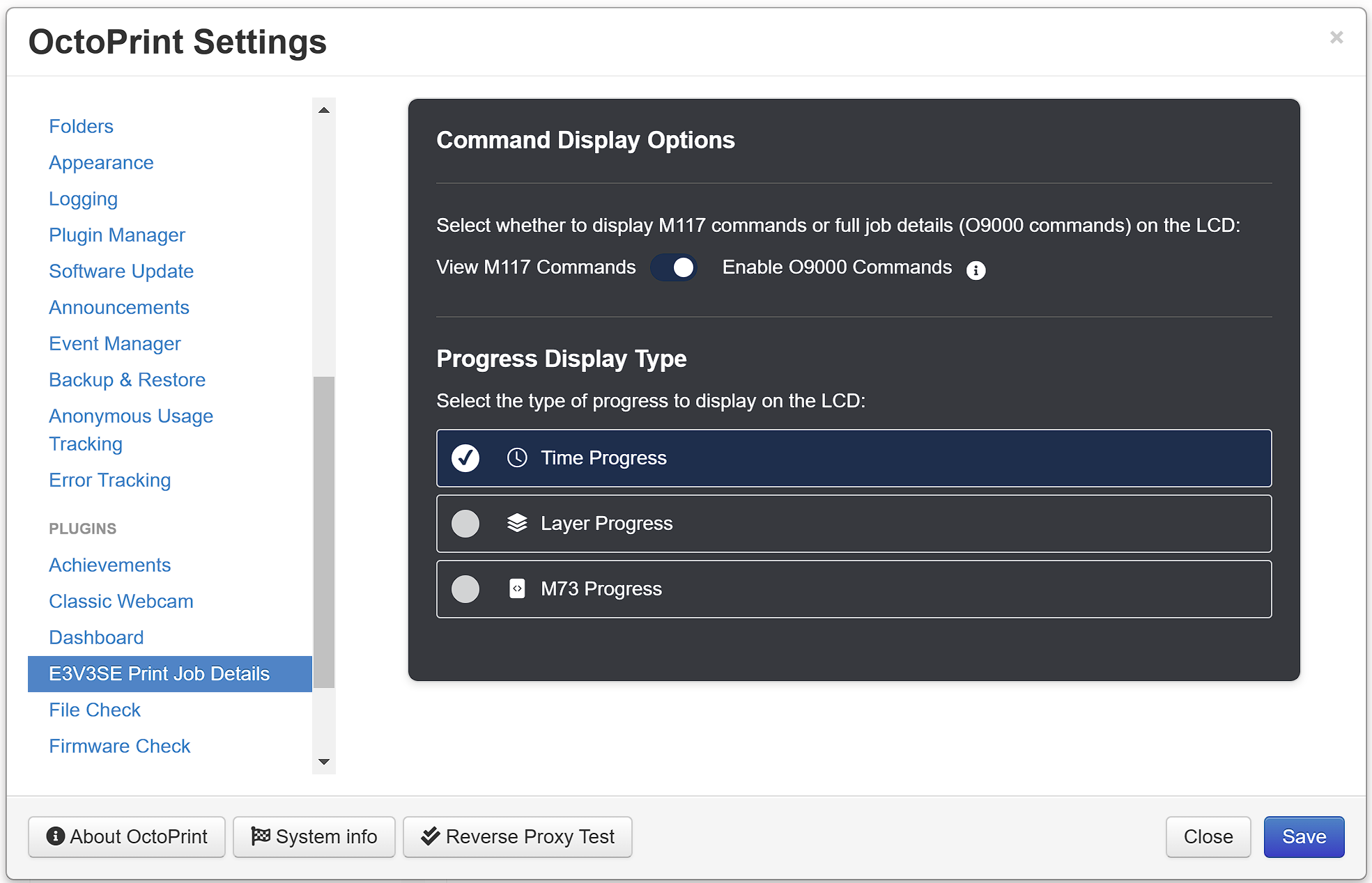

Also note that I tried changing the O9000 commands from displaying either time, layer or M73 progress, no changes to the situation.

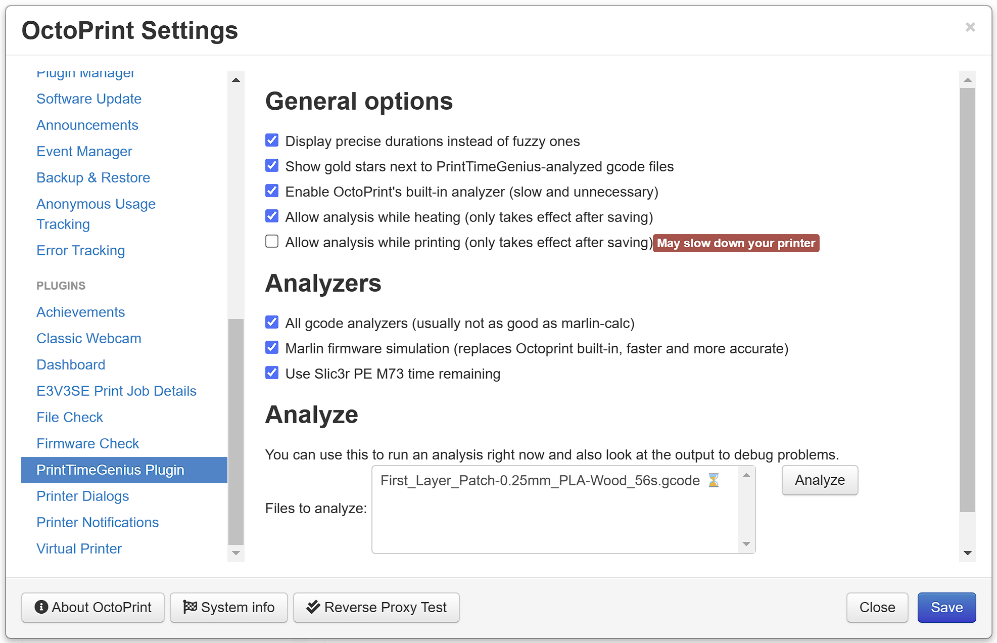

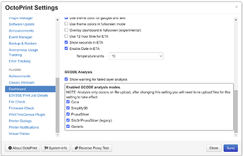

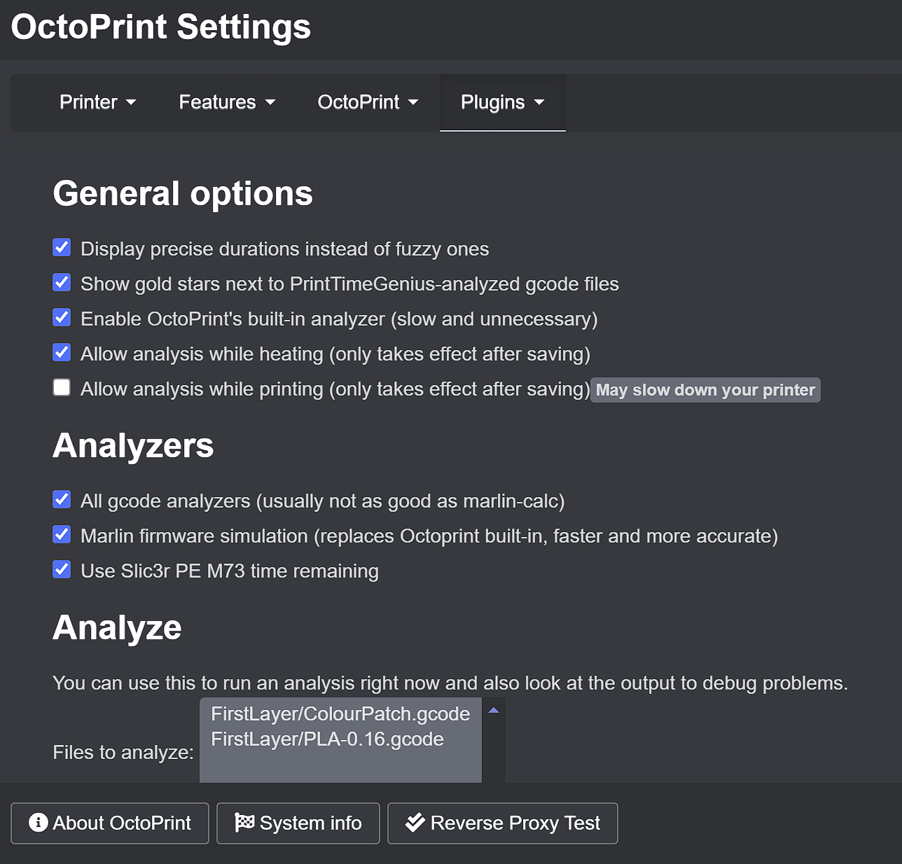

So what I can see based in your log is:
  • You are using a Time Based progress.
  • The metadata analysis failed I can see in the log warning messages. When using time based progress you need to have the PTG plugin enabled so it can provide that analysis. Without that the plugin cannot get crucial infoirmation.
  • For Layer progress is the same it only changes the % between current and total layers.
  • If using M73 the gcode need to provide all the information. But is not automatically you need to configure your slicer to do so.

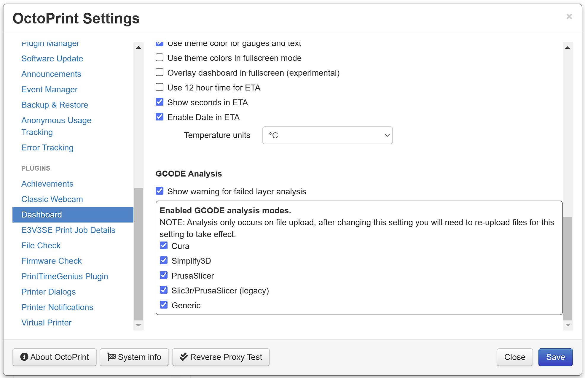

Also noticed DisplayLayerPlugin enable, you can disable O900 and use M117 to use that one or else disable that plugin. But PTG and Dashboard plugins are esential to make it work correctly.
My PTG plugin, as well as Dashboard, are enabled and left default from which last I used Cura which worked. The moment I moved to OrcaSlicer, somehow things are not working as well as Cura. Not just the printer’s LCD progress, but stuff related to metadata such as costestimation, filament used for spoolmanager, etc.

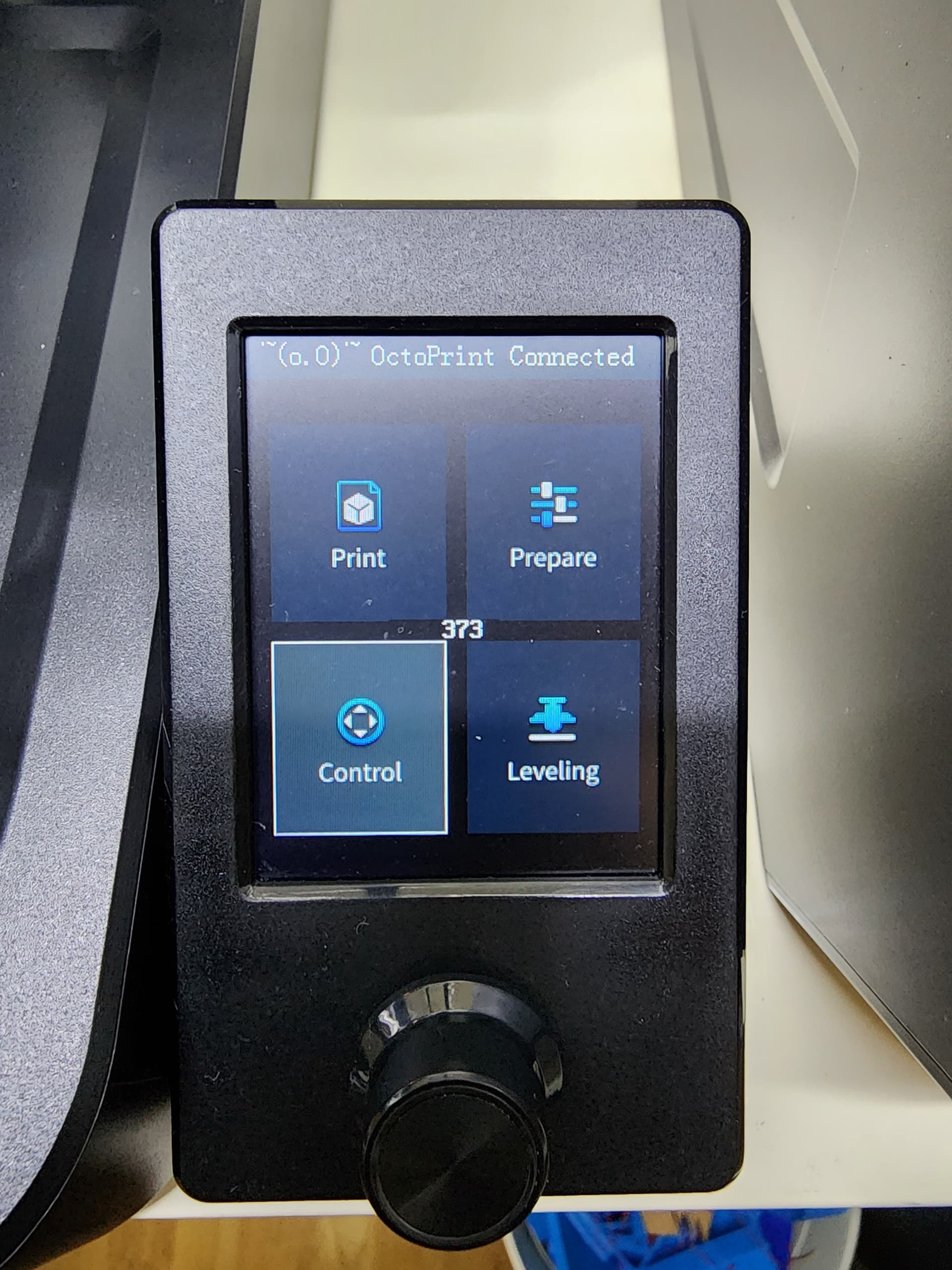

I have disabled the DisplayLayerProgress and opted to use O9000 and there is still no display on LCD when slicing with OrcaSlicer. But printing from Cura, immediately works. Here are the logs for when I have disabled the DLP plugin. Here’s the log. Note the timestamp around 12:40-12:43 is when I initiated the print using OrcaSlicer and 12:45 using Cura.

I tried slicing and printing again from Orca (2.2.0) directly, still no update to the LCD screen. I tried bith Time Progress and Layer Progress. I can safely say no other plugins are causing this issue, I guess. Here’s the log for that one.

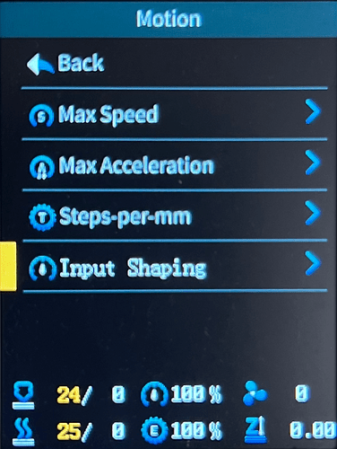

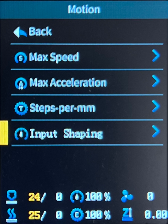

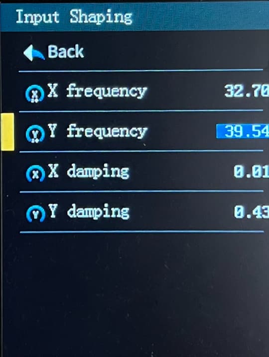

In the meantime @eduard-sukharev has pushed the PR#22 which enables the Input Shaping Menu under the Control Settings.
Version v1.0.9.7_7 is available now.

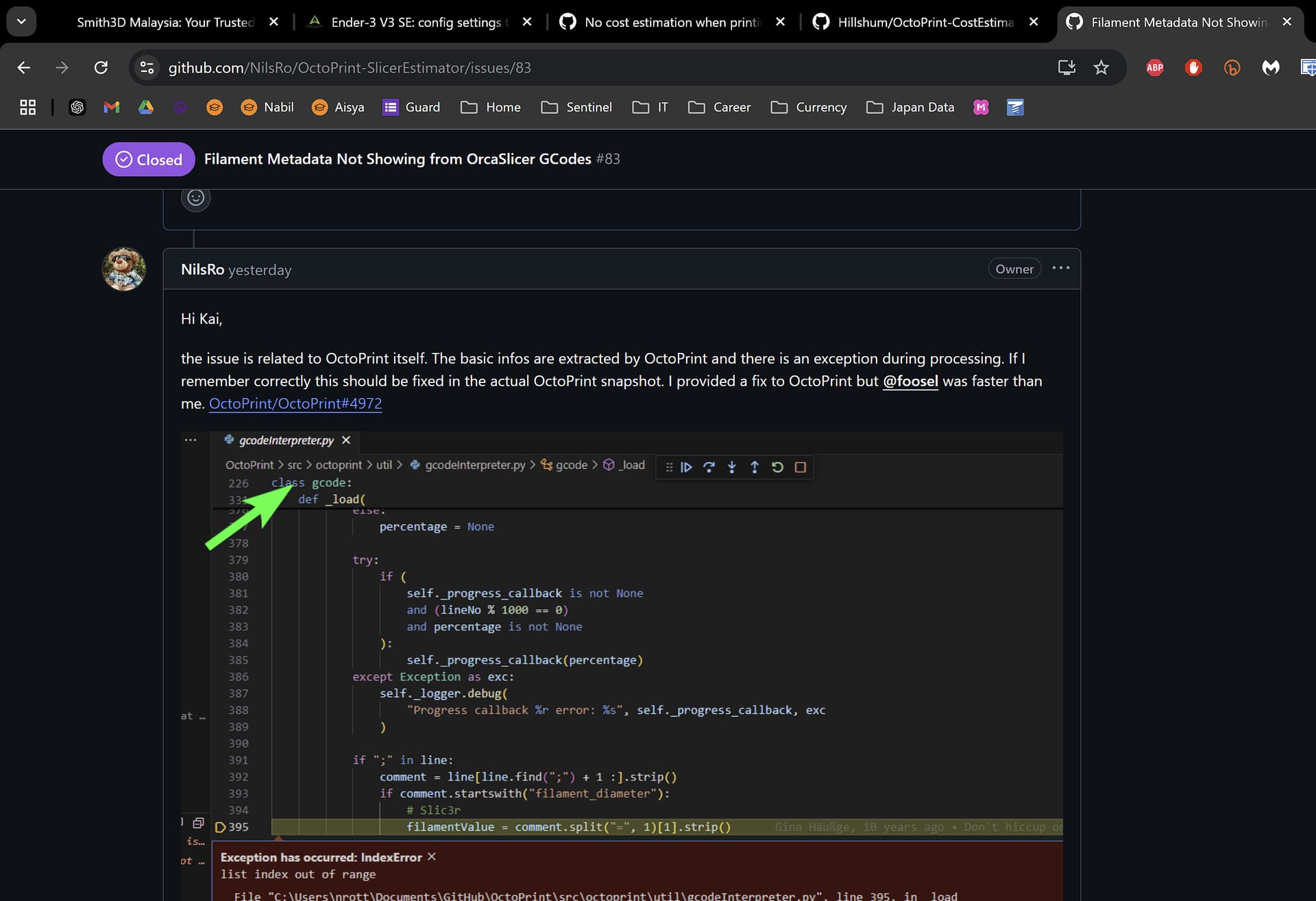

Not sure what is causing the issues with the metadata analysis, in your log I can see same errors as the other one: there is no estimation or result for Print Time which affects Print Time left too.
But you can use M73 based progress instead, just enable it in OrcaSlicer so the progress will be based on the GCODE not in the analysis.

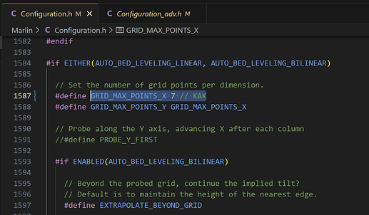

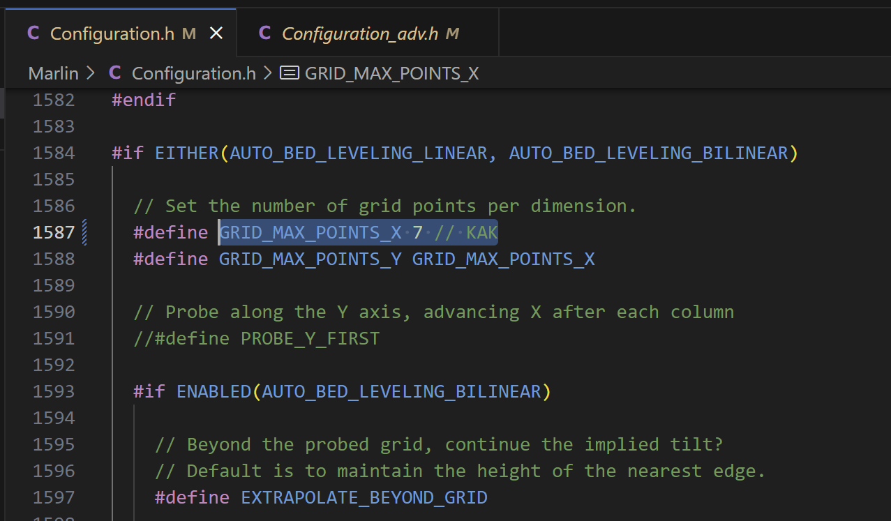

Hi, @Bruce_Van_Essen.
Actually it’s quite simple to adjust Iroh3D’s firmware yourself as the latest release made the changes quite simple thanks to the implementation of simple grid. I did it with my printer:
All you need to do is change the GRID_MAX_POINTS_X on line 1587 on visual code to what value you want (I used 7x7 also. Wanted to change to 10 to test it out but maybe later) and then build/compile and flash:
You are right, as Iroh mentioned, 5x5 is already more than accurate than the stock 4x4, but I used the 7x7 way before I found Iroh’s fork of Marlin, so I preferred 7x7 because somehow I have not gotten any failed prints, ever.
Let me know if you want the edited version of firmware, I could share with you. I have a GitHub account but I don’t know how to share it there as an edited (or fork or whatever it is called) of Iroh3D’s firmware.

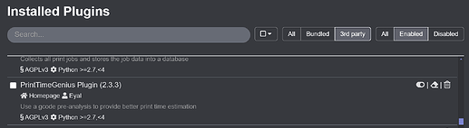

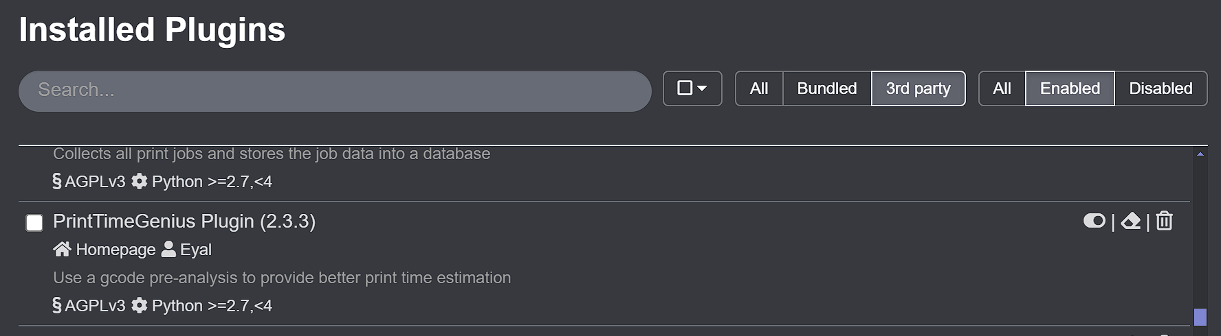

When running Octoprint from a Docker container, PTG plugin will not work. :frowning: It’s a known issue

I made a fork from Iroh3D’s firmware for anyone interested with the 7x7 bed mesh levelling. Check it out at my repo. Please let me know if there are any errors or anything because this is my first time sharing a forked firmware compiled by myself and I am also new to github as well.
Please note that my version is for baudrate 128000, not the default 115200.

I run Ocoprint in Docker and after attempting to find out why PTG was not working, I went looking for a solution only to find out it is a known issue with it. This is why I use the M73 option with @Iroh3d plugin to update the LCD display.
If you got PTG working in a Docker container, then please let me know what you did. I don’t know Docker well enough to get it working properly

I tried using the M73. At first, I thought there was still an issue of print progress not sending to the LCD screen. During mid-print, I went and check on the progress and I noticed something when there was a layer change from layer 372 to 373, there was an update but somehow it does not display properly:
Any idea why? Because printing Cura-sliced-gcode files work nonetheless. But printing OrcaSlicer-sliced-gcode files, the only thing that works, the LCD will only show update when ‘Printing was cancelled’ or ‘Printing Complete’. But the start print and progress, nothing was shown but judging from my photo, it seems like it was sending some sort of update.

The only way to know why is not sending the values is to take a look at your Octoprint log. Based on the previous logs there is a problem with your time estimations.
As @TechieZebra commented seems there is a bug with PTG on docker systems so that’s why we added the M73 option which we have tested successfully.
To make it work first you need to enable the option in the slicer, and to disable PTG and DisplayLayer plugins.
Seems like your installation is different to ours can’t tell why but in theory if you follow above steps M73 should works normal.
