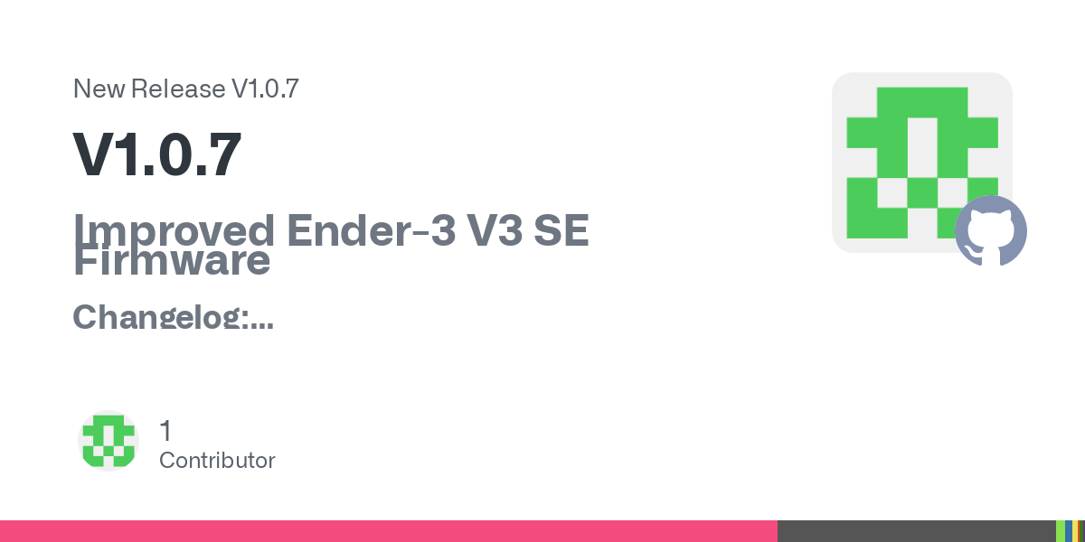

I’ve installed the modified “1.0.7” version and ran some prints. Everything is working normally. I haven’t tested the increased temps, or the increased max speeds, but its does work as normal. I’ll see if I can test the host action commands, but at least Octoprint isn’t complaining that the printer doesn’t support them now!
With @TomasekJ’s 1.0.7, Octoprint is now getting info back from EnderV3SE (see the ‘Printer Notifications’ area in the interface).

And “Yes”: install the firmware in exactly the same way you would with “official” Creality firmware:
From TomasekJ’s:
" Note: I also wanted to enable Linear Advance but there is some bug and it doesn’t work.
Firmware update:
  1. Format the SD card in the PC, and select 4096 for the allocation unit size.
  2. Put the firmware file “SE_firmware_107.bin” into the root directory of SD card.
  3. Turn off the printer and insert the SD card into the card slot.
  4. Reboot and wait for the update to finish.
If you update from 1.0.6, there is no need to update the display firmware. Otherwise, update it here."
