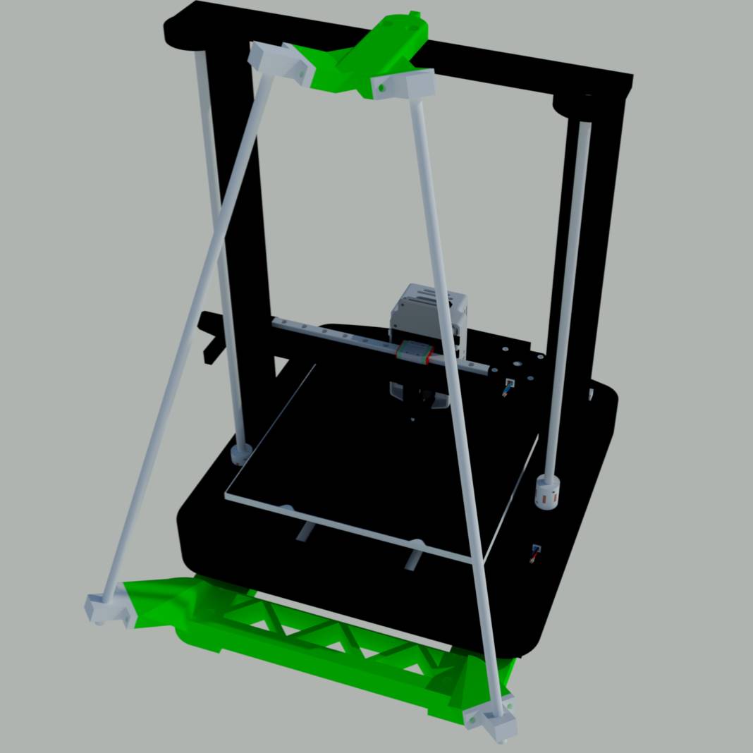

Hi to all !
I designed this adjustable angle stabilizer…
I don’t know yet if it’s really useful but it will show .
A different way to do it than I did it, not sure about a central support, nicely done though. Have seen a fully 3D printed version including the trussing, wasn’t too keen on that version.

The next move will probably be to try on the linear bars it has, two parallel spring-connected ball bearings for setting controlled oscillation damping …

This is the last update to the stabilizer…
It seems to be working fine so far.
That’s impressive looking! I love the thinking outside the box and moving things to the back…I don’t like most of the ones that hook to the front corners and I have a side mount spool that changes the way the display mounts so I can’t do a front mount anymore either. With that said, considering the top crossbar is plastic does the upward angle of the 2 connectors push up and forward on that crossbar…was thinking that a forward “push” would be better than an upward/forward angle. But I’m just a layman and little technical abilities in that kind of design. Regards and look forward to more info about it going forward.
Thank you!
Τhe problem in the Ender V3 KE is the oscillation in the Y-axis but also the oscillation in the X-axis.
The specific stabilization system was designed to be effective on both axes with the help of computer simulations.
Also the system was designed to be installed without any modification of the printer,some tests also showed an improvement in accelerometer setup and operation.
Now all the necessary tests have been done and it is in its final form.
The only thing that is pending is the creation of a user guide so that the model is available on the internet.
With the help of such a system and with two bearings nests of carbon fiber in its bed.. the printer is simply perfect !
Gotcha! Didn’t think about oscillation at all. I was thinking more about forward and backward on the gantry/crossbar due to the verticals and their simplistic mount. It’s a shame they don’t really design the sides of those verticals to allow for a smallish triangular plate to be affixed to the outside bottom area. It would avoid the need to reinvent the wheel to fix the inherent problem, and the taller and faster these get it’ll only get worse or limit the size & speed. But your solution is an attractive solution and still allow the filament on top - I like mine mounted on the side, but mainly because of the lack of overhead room. Anyway, will be following to see how the internet reacts and puts it thru the paces. Cheers.
This looks great, and I appreciate that it doesn’t require drilling/modifying anything to mount

Thinking about your project again and was curious about things. 1) I’ve not made any prints over 4 or 5 inches tall yet and have not had issues that I think are related to the “weaker” design, so is there a point at which it becomes obvious and needs something like your design? 2) did you have any testing points for a before/after result(s) as you went along to see how the design helped, or didn’t? 3) do you think you have the kinks worked out or still tweaking the design? Regards.

This particular project has been in development for eight months and has reached its final form with great success, and is designed and simulated in a professional workstation environment.
This is an adjustable stabilizer in the two axes (X, Y), and an angle adjuster (Z), it has the ability to adjust the angle as well as the ability to adjust the damping rate.
The depreciation rate is determined by the height of the rear bridge .(see photos)
Throughout this period until its final form, most of the tests were done with PET-G and CARBON fiber.
The results are amazing as the machine prints any PET-G and CARBON at high speeds like PLA! Much better response of the factory accelerometer was also noticed.
The only forced modification made to the machine to get the measurements right is to the bed where carbon bearing housings installed that were printed by the same machine , and slips of paper for vibrations.(see photos).All other mechanical and electronic parts have remained as they are from the factory.
So if you’re printing more PLA and less PET on your printer at moderate speeds, I think you can leave it as it is from the factory, you may sometimes see in the prints small imperfections in the external finish in conjunction with the proper lighting, nothing more, the machine is fine !!!
After that, there is the issue of stiffness ratio and how to deal with it in a 3D printer for better printing results, and it is a topic that concerns and will concern manufacturers in the future, especially in high-speed and low-cost products…let’s not forget that a large percentage of evaluation in a professional device or machine is determined more by its stability over time and not by speed .
Thanks I hope I helped you !
