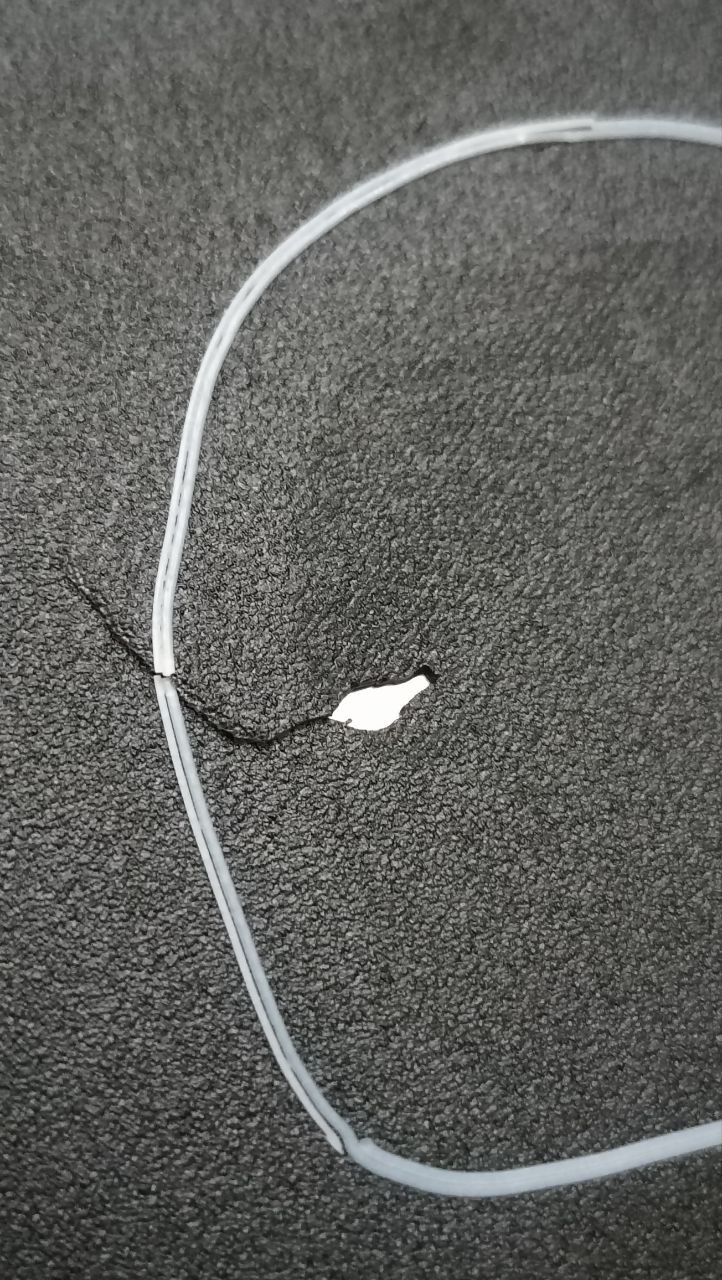

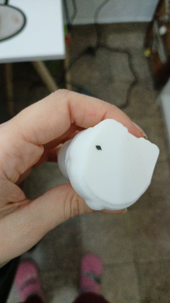

You see, last Christmas my partner gave me a “Creality Ender 3 V3 SE.” It’s my first 3D printer, and I was very excited about it. Along with the printer, my partner gave me White PLA filament from the same brand. Using this material and the tutorial in the instruction manual, we did the calibration and printed the first test piece. And that’s where the problem started: something went wrong with the first piece, it printed badly, and that caused the heated bed (BEDHOT) to break when removing the piece (photo attached).

The bed pulling off is a common problem on the steel spring bed it will happen again. I got the cheap gold pei sheet off Amazon for about £16 and never looked back

Regarding the BEHOT, I didn’t think it was such a common problem, but thanks for the information; that way I won’t be surprised if it happens again. The fact is, I can’t understand how a relatively cheap part has caused so many issues to get it replaced under warranty, and they still haven’t replaced it. Honestly, I will never buy a Creality product again. It’s a shame because the printer works well, but I don’t want to buy an expensive product from a company where the after-sales service has been so poor.

My original PC print plate also had a chunk taken out of it, PLA just sticks to well to it, keep it as a spare. Replace it with a PEI plate from Amazon 235x235mm size is what you want, textured one side gloss the other. Will take a little practice to get proper bed adhesion but once you have that trick mastered it should print day in day out. My V3 SE is rarely not printing something, quite the workhorse once you get it tuned in. There may be a few tweaks that you could do to optimise the machine, just ask away.
Did you wait for the plate to cool down? It releases itself from the plate at about 30deg. if i use tree support, I will snap it of at about 45 so the support is easier to remove.
