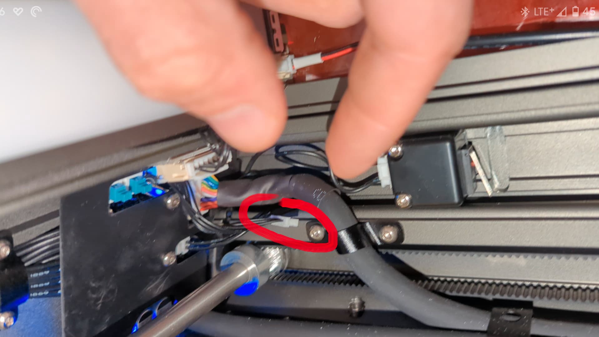

My device was dead on arrival. Not even a sound when I plugged in power. I then unscrewed the protective plastic over the main pcb and checked with a volt meter. and found the error quite quickly the cable at the key switch hab come loose. The device started working but neither LED light nor exaust fan or closure magnets were working. I checked the cable connection I had plugged in but to no avail. I then took the milky plastic cover off the LED strip and wiggled on that cable at the other side where it was even protected with some superglue and the lights went on. So after some trouble shooting I now have a fully working device.
I cannot imagine that the cables came loose during transport if they would have been plugged in completely as the box had no damage. I think Creality needs to become better with their end control.
Omg bro, you saved me. I removed the light diffuser and saw that the jack fell off. I put it back and the exhaust fan and led started working again. Thanks so much. Send me your PayPal account, so I can buy you a drink.

Have you checked the jack behind light diffusor?
See the picture on this link, 4th reply from Tytan:
