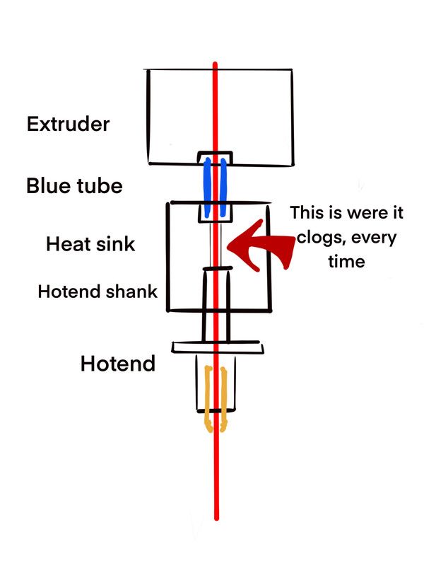

So after taking this thing apart all night it’s consistently seizing at the heatsink. The blue tube is affected but it’s jamming up the right there. Even if I feed material all the way down to the physical (cleaned) nozzle by hand it’s still either getting too hot or not hot enough.

after taking it apart a dozen times in one night the clog is consistent at the heatsink.

Okay, after taking it apart several more times with the same exact result i found this.
which matches the picture i cobbled together
still failing, regardless of temp.
I have very little incentive to keep ordering parts for this thing. Is anybody from Creality on the official Creality forums?
if its good old fashioned heat creep, can i get a good old fashioned fix for it?

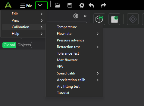

Alright, I hope this works because I never uploaded images before.

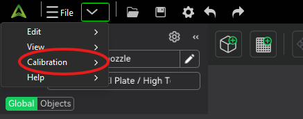

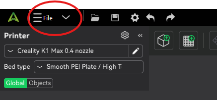

The version that I am showing this from is version 6.0. You need to go to “File”
Then Calibrate.
And you will see all of this.
Everything is very important if you want your machine to work at it’s fullest.

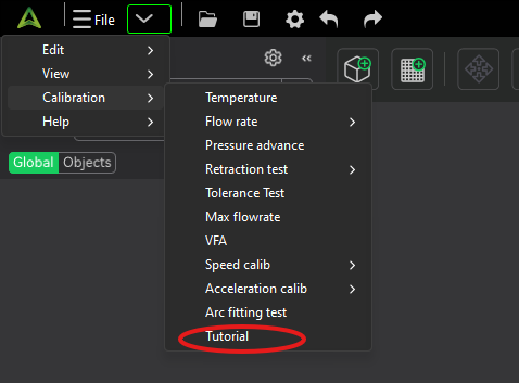

But if you want tutorials go to here and it will bring up the 5.1 version explanation of how to do them. But it will still explain everything.
For 6.0 you will need to restart your Creality Print every time because it will change a lot of your settings for these calibrations to work. 5.1 didn’t do that but 6.0 does and can cause headaches with that if you are not careful. For speed tests use VFA and not Speed calib. And for Pressure Advance use PA lines. That is faster and in my opinion, easier to understand.
