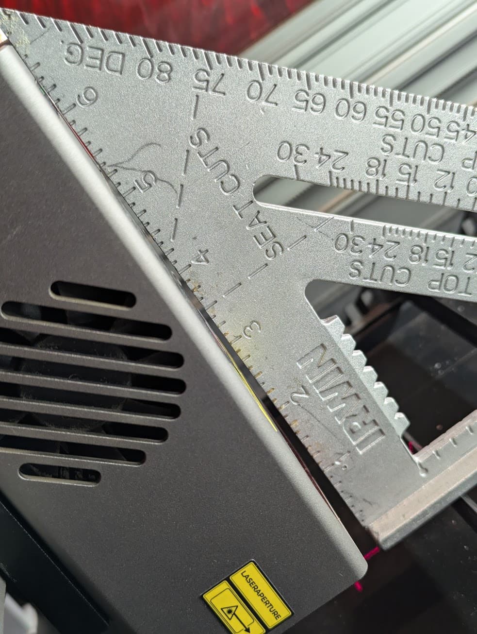

As can be seen in the attached photo, my laser head is significantly tilted forward. I can’t find any adjustment screws available for correcting this.
I’m not sure if this tilt is “by design” and all are like this, or if there is something wrong with just my laser unit. If this tilt is not normal, I’d like to know how to fix it.

  • The laser module is not perpendicular to the table on the y-axis (front to back).
There do not appear to be any adjustments that can be made to the x-axis assembly or the laser module mount that would allow for the forward tilt of the laser module to be corrected.
I’m also not sure if this forward tilt of the laser module has any negative effects other than making it difficult to determine the correct focus setting using the focus block provided.

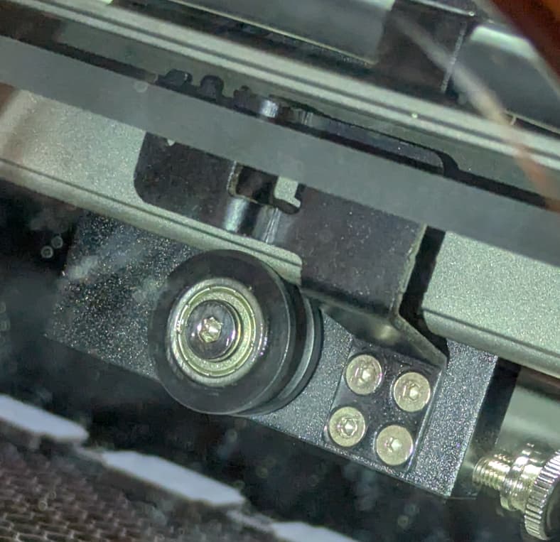

The issue that I’m having with the laser module forward tilt appears to be caused by the laser head mount on the x-axis assembly. I’m using an 8" engineer’s square in these pictures.
Putting the square against the x-axis assembly, it appears to be square to the table although the reference face is much shorter so :man_shrugging: .

I’ve went to my device (in the garage) and removed the the laser from the carriage and I have the same. A carpenter square (only know the French word : équère) flat on the surface of the desk touches the top of the carriage, but not the bottom. However it seems I have a smaller gap than you do.

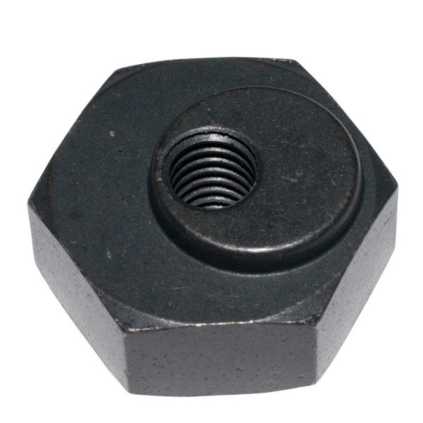

Thinking a bit about “Eccentric nuts” and rewatching the unhelpful Creality Support video entitled Service tutorial Creality Falcon2 Adjusting the Eccentric Wheel gave me an idea.
My laser head wasn’t wobbling at all like what is seen in the support video, but I loosened the eccentric nut on the front of the laser head mount to the point that the mount started wobbling a bit. Using the supplied hex key, I then rotated the bolt at the back of the mount in a clockwise direction (I think). I started with a 45° turn and then tightened up the nut on the front of the mount until the wobble was gone and the forward tilt was reduced a bit. I repeated this a couple of times and after turning the bolt at the back about 110° in total, I now have a mount and laser head that are perpendicular to the table like they should be. :man_dancing:

I apologize as I know I’m super late to the party, but I had this issue when I first unpacked my falcon so it’s definitely not due to age. I can’t find any of my documentation from when I addressed this but if I’m not mistaken this nut here can be turned to move it in and out and adjust the cant of the laser module.
I don’t see how this can work as the screw in the back only secures into the concentric nut. There’s no ramping or the like to move the bottom pulley on the rail forward or back. The only solution is to put a shim between the bearing and the x axis carriage to shift the bottom forward. I’m having the same issue with my laser pointing backwards a few degrees. I ordered a set of .1mm shims from Aliexpress.

@dadsworkingonit, did you try turning the eccentric nut and see if that worked at all?
Yes. The eccentric nut only moves the bottom pulley up and down to dial that tension in on the rail.

Okay, unless they changed the design of this recently, the eccentric nut definitely adjusts the angle on mine and others here. That is the whole purpose of an “eccentric nut”. My angle was more pronounced than yours and was fixed as described above with no shims needed at all.
As described my solution post above, it isn’t the nut, but the bolt behind that needs to be adjusted using a hex key. That adjusts the angle.
I fixed my verbiage. Thanks!
The sole purpose of the eccentric nut is to adjust the height of the bottom pulley on that rail based on it’s position when you tighten the pulley bolt.
I don’t see anything else back here to adjust angle… just the one bolt securing the pulley to the plate/eccentric nut.
Yes. Loosen the eccentric nut. Try turning the pully hex bolt slightly, Tighten up the eccentric nut so the thing isn’t loose. Test your angle.
