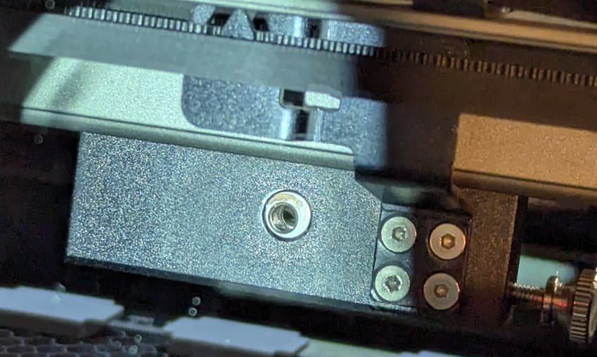

I would not advise trying to loosen this connection with the eccentric nut as you may be on the rotation side where you’re crushing the pulley into the gantry. I am guessing that, through your adjustments, you backed the eccentric nut out of the black plate on the front a bit pushing your laser out and into square with the bottom cutting surface. The problem there is you may have issues in the future with the nut moving back in and creating slop in the system. I’m guessing if you tightened that 3mm pulley bolt properly, you’d pull it back out of square but all parts would then be secure. There’s no mechanical bits here to adjust tilt.
The only way to fix the tilt securely is shims.

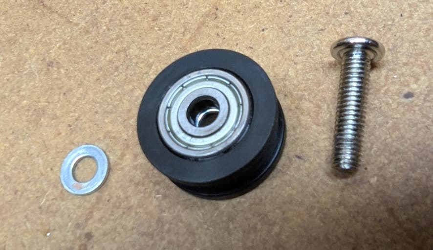

This is an old thread, but it ended up helping me solve this issue on my Falcon Pro 2. I initially tried using only the eccentric nut to correct the tilt, but after disassembling the x-axis for a closer look, I agree with @dadsworkingonit. I added about 1.8mm worth of thin shim washers next to the lower bearing on the laser mount assembly in order to get my laser head pointing straight down.

Finally someone understands what I am trying to explain. Turning the eccentric nut only tightens the bracket to the beam and throws out the head being perpendicular to the bed.
Did the shims fix the problem? Mine is so bad that I have to flip one side when doing tab joints. If I don’t do that there is a gap and also the sides don’t make a 90 degree angle.
Yes - the shims fixed the problem. Here you go:

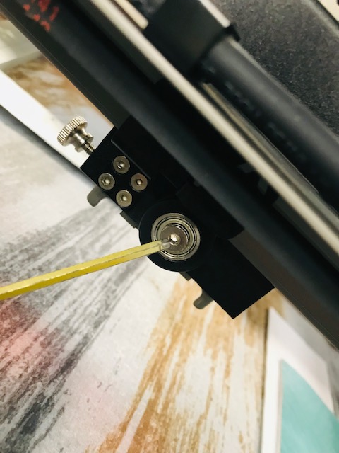

hi , same problem , this screw change angle of head.
No. You need to add shims to change the angle of the head. See the illustration about six posts up. The only that bolt does is hold the wheel on. The back end has an eccentric nut but that’s to adjust the tension of the wheel on the track only.

I tore the carriage apart when I posted above. That screw secures the pulley to the carriage and has a eccentric nut in the carriage, which you turn, to adjust the tension of the wheel on the track. If you loosen that screw to adjust the angle of the head and leave it, all you did was loosen it so it will push out the carriage and things will get sloppy quick since it’s not secure as designed. Shims are needed for a long term solution. :slight_smile:
