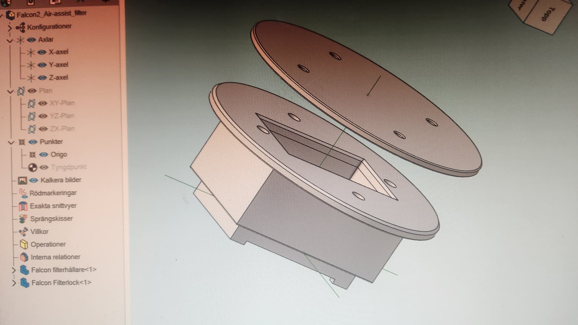

Hi, I’ve been using My Falcon2 Pro for a couple of months now, mainly cutting plywood. The output power has gone down, from a cutting speed of 1000mm/min at 100% power to 300mm/min at 100% power.
After my first cleaning experience when I had cut for 10 hours, I made a filter design for the air pump that keeps the lens clean. Also, I made a design for keeping the air inlets to the cutting head free from debris entering the interior of the head.
Still, how to solve the power outlet issue? Perhaps replacing the laser diodes with Osram PLPT9?
I designed a fresh air blower to supply clean air into the laser head. It blows clean air into the two inlets to keep the interior clean when cutting plywood. Usually I had to clean the laser head every two to three hours of cutting. I did rum it for 10 hours and it was still clean!
Also, I replaced the air pump filter with a HEPA filter that gives clean air into the laser opening.

Yes, I will try to include my design for the filter I’m using. The HEPA filter is a round filter for some kind of cheep vacuum amd there are many models on the market that can fit. The .stl file is included.
Falcon air assist HEPA filterhĂĄllare.stl (435.6 KB)

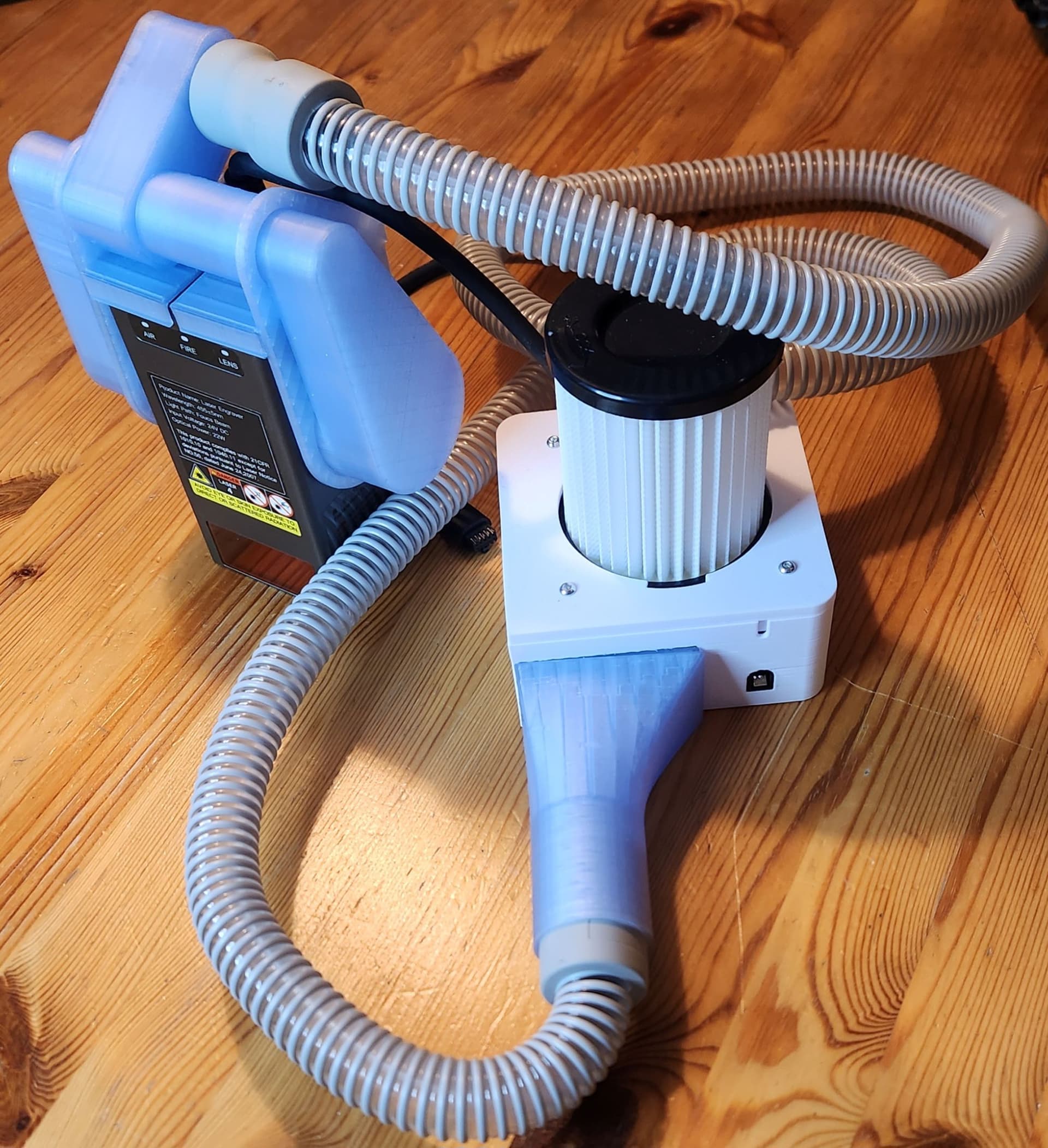

Air-intake
Air-intake1920Ă—2103 394 KB
This is my system to get clean air into the laser head. After now more than 50 hours use cutting 3-5 mm plywood the head is clean from dust! The filter is a standard HEPA part for a compact vacuum.
Wow this is some upgrade, It looks amazing. I have not seen anything like this one before.
When I found all dirt collected inside the laser head, I designed the cap riding on it. The tube is the kind you use for breathing equipment and is very soft. It goes through the side panel and follows the cabling and pressure tube. The next modification on the Falcon2 Pro is a system that sucks the evacuation air through a honeycomb panel to minimize the pollution of the laser head and carriers. Will publish a picture in a couple of days.
