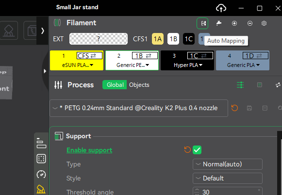

…but for some time now the selection of filaments in my K2+ printer has not been reflected in Creality Print. Is there some way to click a button to tell Creality Print “Read the filaments from the printer”? I feel sure there used to be, but for the life of me I cannot find it now…
such as this?
It’s the little Auto-mapping icon/button in the top right hand corner of the screen:

Certainly seems similar, though I haven’t encountered the “unedited consumables” part. I’m hoping the answer given by EvoLabs is a fix.

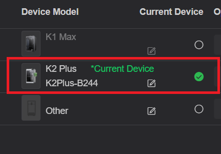

Creality Print can be finicky at times. I have found that 1) you should make sure that the printer is powered on and connected to the network before you start Creality Print, and 2) make sure the printer is selected as the “Current Device” on the Device tab. (see picture)
