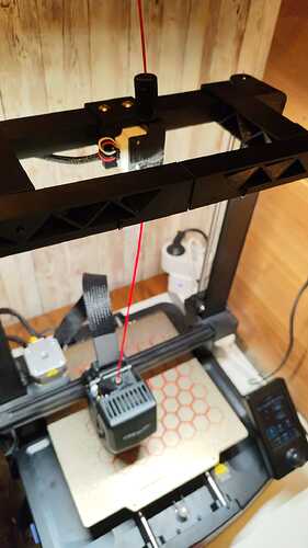

Okay, I´m still struggling with the filament run-out sensor! I connected the sensor to the 3-pin female on the board but it does´nt function, only the LED is lighting when filament is present, so I assumed it was a firmware problem. Now I see in the Manual it´s a 4-pin male contact on the board named ”filam”.
This is for the filament run-out sensor.
But all run-out sensors I´v seen has only 3-pins, included Crealitys own. My is just a cheap no-name sensor.
I simply cut of the one ”Wall” on the 3-pin connector so it could go into the 4-pin on the MB.
In a Creality video about the Ender-3 V3 KE we can see only the 3-pin from the left site are used.
I hang the sensor in a elastic band from the filamentRack, nothing special, for now I just whant it to work.

with the RED, BLACK and WHITE configuration on the 4PIN Filament connector, the sensor was on also the LED light, but when I tried to remove the filament the power of the screen went out, of course that I’ve panicked, but I inserted the filament back and the screen turn on, then I said why not trying to invert the wires so I inverted the BLACK with WHITE and connected again the sensor and try again, surprise the sensor worked normally, with the exception of the LED

I have bought tis type of run out sensor cheep from TEMU, I searched on the net and found a video from China that said the sensor should be connected on the 3 PIN connector , witch only gave power to the LED from the sensor and that is it, then I found this post and figure it out, the only thing is that the sensor has 3 wires, but colored: RED, BLACK and WHITE, in this order
