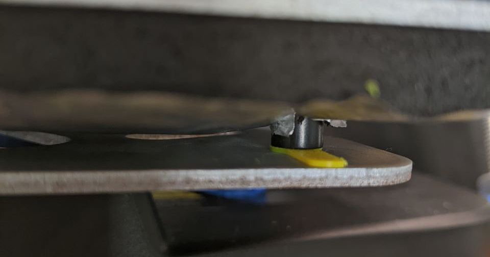

I then checked the bed screws under the build plate based on the suggestion in the other forum post linked below and they were all roughly 1/4 turn loose. So I tightened them, cleared the bedmesh from the Mainsail UI and calibrated it from there and did another print, but this one did not go well at all, as seen below I had to stop it very early.

What does your bed level look like? It should be good if it is within a 2mm window, the software should cope. If you want to chase it to be totally level then kapton or aluminium tape on the magnetic plate or silicone spacers instead of the black spacers (I think they are Delrin). You could even machine new spacers from Delrin if you want. If I could be bothered I could machine new spacers, but I have a lathe and a mill to use so beyond most people. Could print new spacers?

You can try to do what Bonfireman mentioned. Leveling shims.
https://www.printables.com/model/733411-ender-3-v3-seke-bed-leveling-shims
https://www.printables.com/model/833984-creality-ender-3-v3-seke-bed-leveling-shims-for-he

I’ll show you my bed after printing and using shims.

I’ve printed a few shims and my bed is indeed far more level now. Still not perfect but I’ll keep tinkering, and the gyroid infill has solved the nozzle issue as well, so I should be good to go from here.
