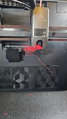

First Layer Issues with textured PEI plate
First off wanna say I have been having alot of fun with the K2.. bunch of multiday prints and with the exception of a couple things that were likely my fault it has been really good. But what feels like ‘all of a sudden’ my textured pei plate has started doing this to my first layers..
I am far from an expert but I went through the usual ‘oh must need to wash the build plate’ so I scrubbed that thing with repeatedly with dish soap as I have my other printer and that didn’t work. Thought well it couldn’t be the Z-offset since this thing levels itself every time so maybe its temperature, how hot the bed is etc. needless to say none of that seems to have fixed it.
And to add to my confusion I thought just on a whim to test out the smooth PEI plate they sent with it which while I did have a model edge that did curl ( I didn’t even think that was a thing with PLA ) the rest of the items I was printing for a friend came out really good.
I have no idea if it helps but here is a picture of my bed mesh as well.. didn’t even know where to find it until learning it on this forum haha.
Is it just as simple as the z-offset not being quite right? if not is there anyone that may know what it is? and if it is the z-offset what would the best way to correct it be? ( asking as someone that came from a printer that just had a basic option to bring it up or down a mm at a time ).
I saw some people talking about calibrating the bed mesh etc. but I am unsure if that has anything at all to do with this so anyone that can help me get this sorted out would be amazing.

Wow sorry for not getting back to this sooner! I had basically given up on someone responding so I hadn’t checked in a couple days haha.
Honestly thank you for all the great advice ( love that you even have pictures ). And I think you are right the z-offset seems to be what is stumping me. I have tried both lowering z value ranging from +0.025 to 0.050 and raising by the same amount ( -0.025 to 0.050 ). And it feels like a crap shoot right now… if I get a good first layer rest of the print has in almost all cases come out really nice but I am having to really watch that first layer and sometimes start it multiple times which is frustrating.
I have been doing filament calibrations based on that post ( such a helpful post ) for a while now and anything I print in the center of the bed is fine its whenever I print something bigger that spans more of the bed I seem to have there problems.
And this is despite me using the same brand of filament for a ton of prints/tests what I end up more often than I like though is one of two things… either it seems to be too far off the bed and it basically seems to just roll the extruding filament around making a ‘ball’ of sorts with almost no bed adhesion and if it is too close I end up with something similar to the bottom right hand of your plate picture and/or the nozzle gets caught running across a ‘not smooth’ edge and has in many cases ripped the first layer off the plate taking it with it ( similar to that picture I listed in the first post ). Heck I have even ended up with a bit of curling on an edge or two of pla prints… I didn’t even know that was possible with PLA haha.
For what it is worth right now I am trying to use…
  • The frosted PEI plate that they sent with the pre-order ( I am still listing it as a textured plate in creality print as I don’t think it qualifies as a smooth but someone let me know if I am wrong )
  • And the filament I am trying to make use of is some 10+ year old Makerbot PLA… its not brittle and its ideal melting temp seems to be between 210-215 and I put the print bed to 60 to try and help with adhesion… but maybe that is too high?
I may try the original plate again… when you mentioned 0.015mm did you actually raise or lower it? … I would assume you lowered it based on the picture and the fact you put no minus in front but figured it is worth asking.
If you have any other suggestions or anyone else out there has any tips I am all ears… I want to get this printer back to the point that I feel I could hit print and walk away as I feel it was that way at the start… granted a bunch of stuff has changed and each filament needs certain settings but I feel like I am just missing something obvious. XD

Figured since you provided some helpful pictures thought I should as well to show what my experience is right now.
So for this example..
  • The PEI plate was just washed with glass cleaner
  • z-0ffset was set back to 0,00 no adjustments
  • PA and flow rate done for a same brand PLA ( just a different color ) so I used that
  • Temperature set to 215 and 50 for the bed
And this is what I end up with..
So Then I decided to put in a 0.015 z-offset and I even ditched my calibration incase I did something poorly and I end up with this..
Like honestly.. I will say it again I am not an expert.. but how can this device ( and by extension me ) be failing so hard just asking it to put through some generic PLA not even more difficult materials like others are listing on the forum right now. XD
I am hoping these pictures might give you some insight as to what I or the printer might be doing wrong.. and I genuinely appreciate your time I can see your quite popular on this forum.
