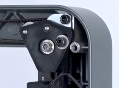

Ok! First, let’s make this clear, you have the Ender 3 V3, right? We’re not talking about the KE or SE, because I’ve seen some confusion in this subforum.
If that’s the case, I’ll give you another trick to level the bed.
If the biggest unevenness on the bed is on the X axis, you can level it by using the belt tensioners.
Try first with the higher side by tightening or loosening the tensioner on that side.
Keep testing little by little with both sides.
In my case, I had an unevenness of almost 1mm, and I corrected it this way.
When you have it as level as possible, do the Flow rate and Pressure advance calibration again.
Once you have everything set, do another first layer test, but for the entire bed, not just squares.
Yes, I know it’s not the proper method, but until Creality deign to and decides to give us a solution, it’s what we’ve got.
