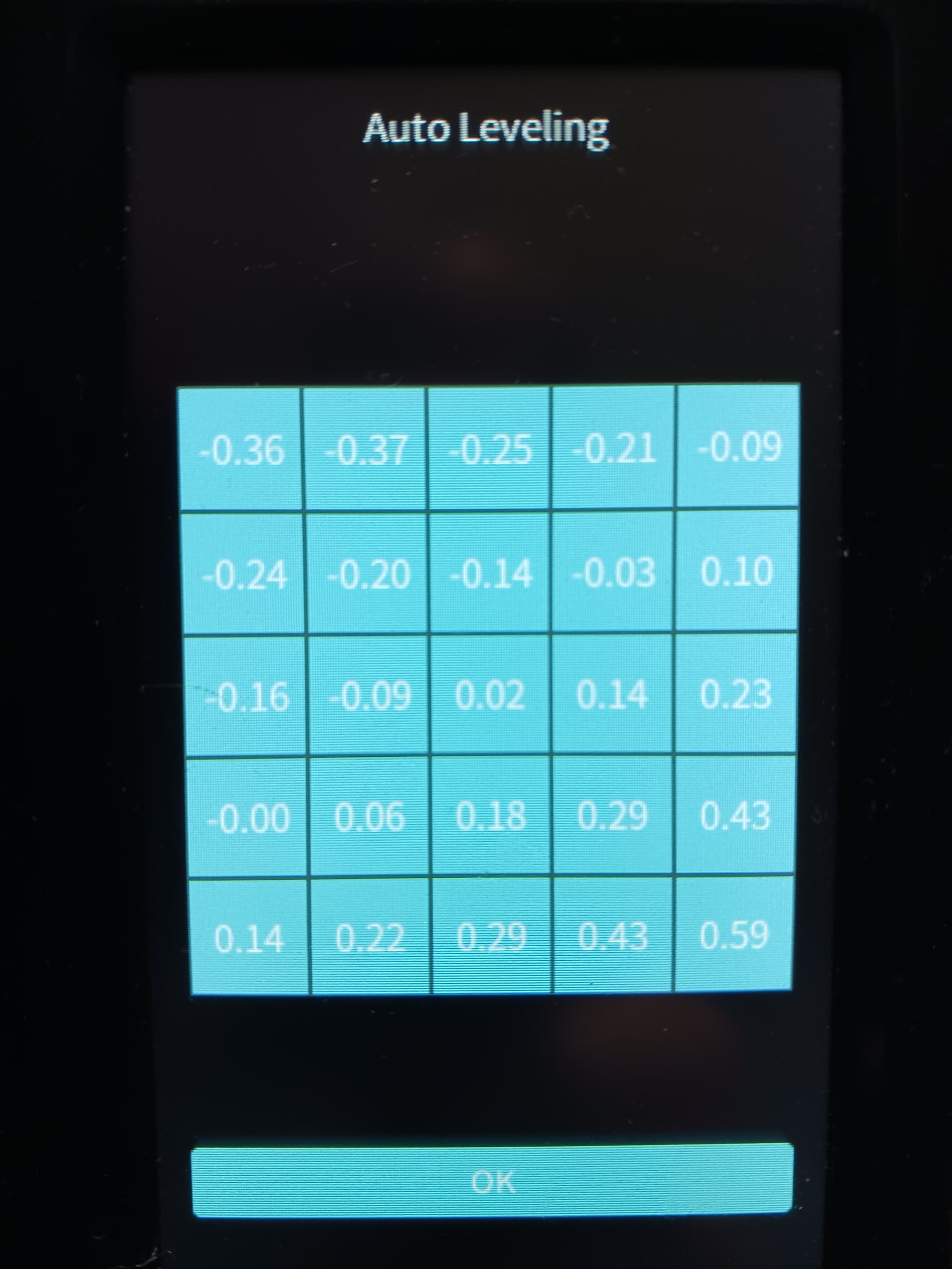

Check out some values I recorded throughout my “journey”:
I’ve tried everything to tightening/loosening everything I can to shimming and nothing leads to success. I mean, come on Creality how do you expect (me) to print any reasonable first layers ESPECIALLY when the “Auto Calibrate” doesn’t even come close to compensating?
I guess I’m gong to have to live with it for now. I’m not interested in modding the heck out of it. I just want it to work. :rage:

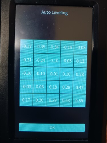

@jimandyen How would you solve one side of the build plate being too low. The V3 is supposed to have self leveling Bed right.
Hello @MikeCat :wave:
Depending on how uneven the build plate is the machine should be able to compensate by moving the nozzle after it’s calibrated which is the self leveling. The build plate itself doesn’t move on the z axis but I would check under the plate to make sure nothing is sticking to it like a loose piece of plastic causing it to be uneven. Put the build plate on a smooth surface and make sure it’s not bent.
I’ve never had to do this but some users have luck using shims or pieces of tape if the bed is really bad.

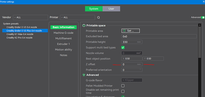

You didn’t mention what slicer you are using. If Creality Print you might play around with the Z settings in it to see if that helps otherwise…
It sounds like there is some file or configuration that is over riding your settings. That’s the first thing I would look for. Since my printer is stock and I don’t really have a clue how the marlin and Klipper systems interact with the printer settings so I haven’t changed anything.
Yes, that is a possibility.

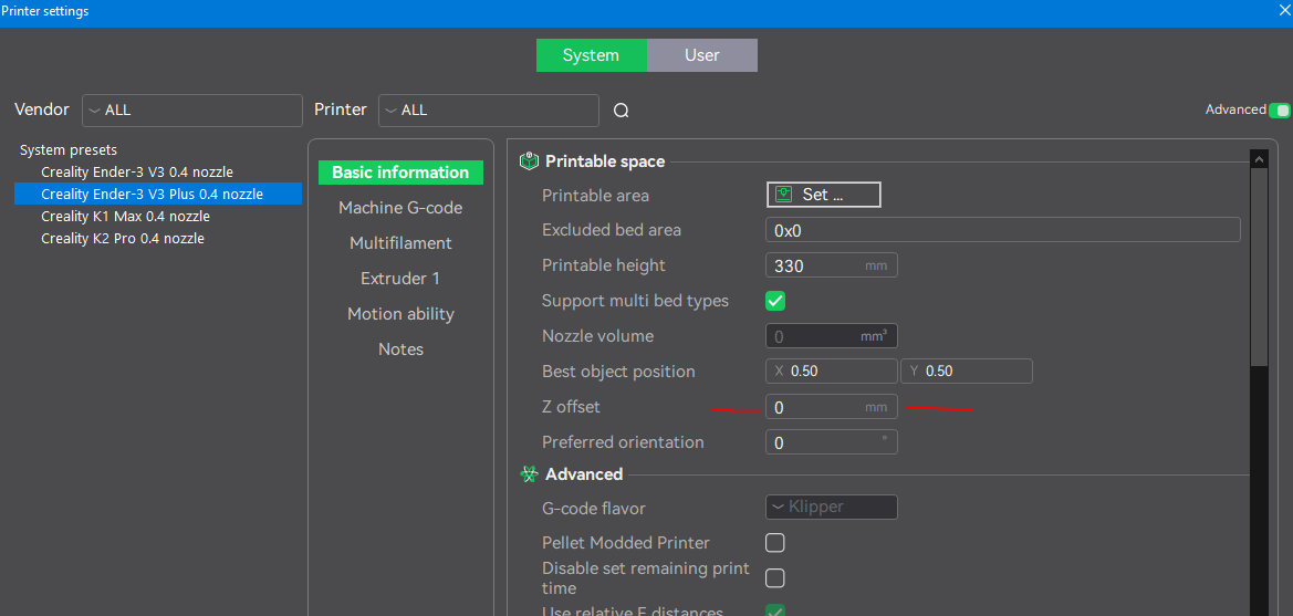

I’m using Orca slicer (with the presets from Creality, and it has the same Z offset option, which I have at 0). I just checked the g-code and I don’t find it overriding the z-offset of the printer.
On Monday, I’ll try with Creality Print and see if it makes a difference.
