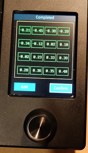

Sorry for the late reply and sure attached is a picture of the bed leveling
I hope this helps
Hello Admiral_Boom2,
Well the bed leveling looks ok.
How about the dryness of the filament ?
A damp filament (can’t tell by looking at it) can cause the problems you are having.

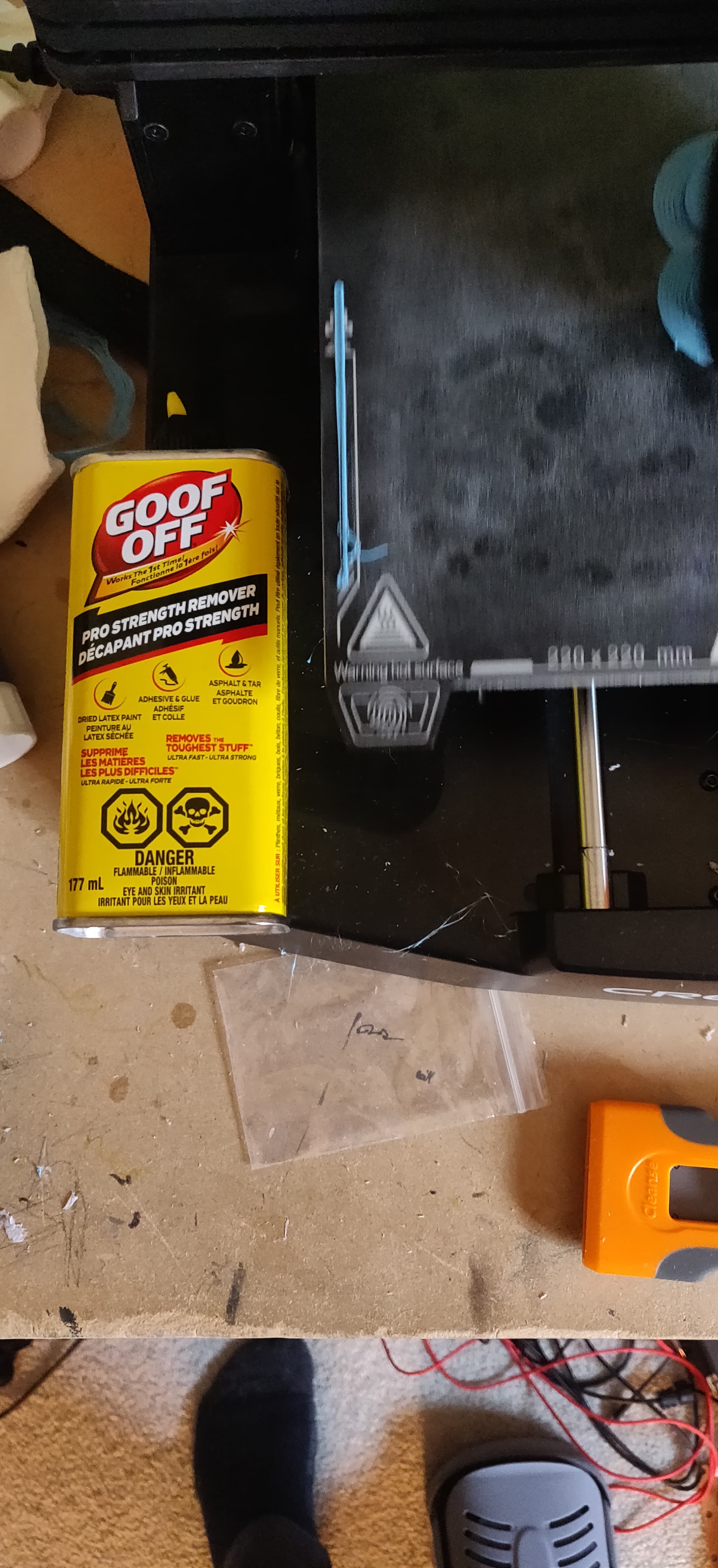

I have found the ideal z-offset and have happily printed since then and have found that is I let the first layer print at 35-55mm/s I can then put the speed to anything and still have good quality. Thank you to everyone who has helped me figure out this problem and I found that cleaning the print bed with Goof-Off (I’ll attach a picture) before every print it works perfectly but have noticed the print bed to start turning gray/white after a while but since that isn’t causing issues I’m fine with it.
Just read the safety sheet, your build plate is going grey because Goof off contains mostly acetone which doesn’t particularly like PEI. May I suggest using pure isopropanol alcohol instead, just as good on grease but doesn’t affect the PEI (and a lot safer after reading the SDS.pdf)
